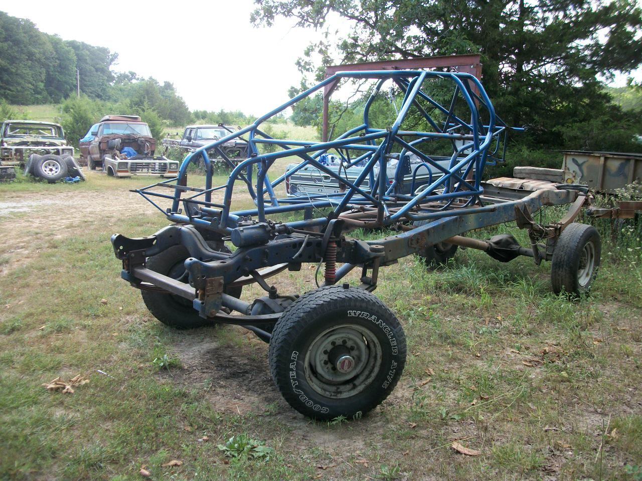

We might have, but that is the risk you take when posting a active C-list add. Unless I PM you that info and keep it on the down low. But what kinds of motivation is that? It is just like me posting pics of my parts rigs. Maybe some one will come buy one of them or even all. AND my shed full of parts, hint hint it is a big shed.

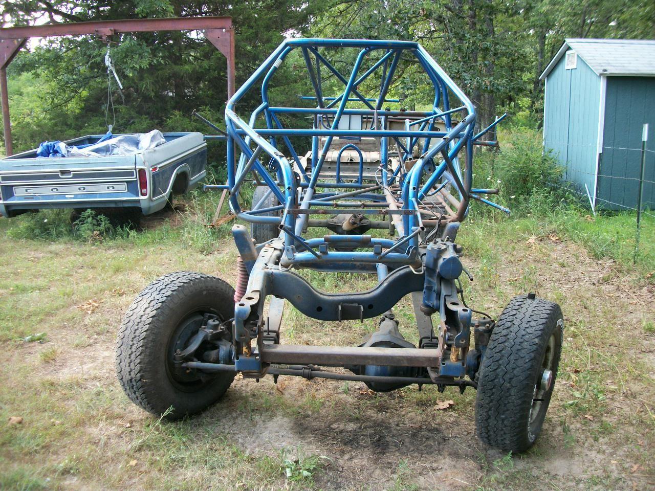

I am positive you can source a axle in Idaho, Montana or go west to Washington state. Yes I have a spare 79 F250 (8 lug), not sure about gear ratio. The "outers" (steering knuckles, spindles, hub/rotor/calpier's and calipers brackets) were removed to make a 5 lug 1/2 ton Dana 44 into a 8 lug F250 so he can bolt on some old school 16.5 slotted mags. And one more spare 79 F250 Dana 44.
Heck I got a Dana 60's set under a project. NOT my front end spacer work, that is all PO stuff that I need to fix.
I already sold one other set of Dana 60's, that were still attached to a frame with a rusty body 79 F250 SC LB with 460-C-6-NP-205.
