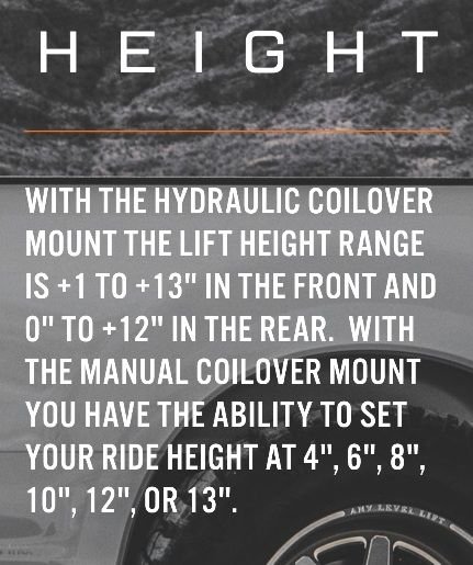

Does an any level lift lower the truck below stock level? If not, it isn't really an option. I thought those were people wanting a monster lift while still having the ability to lower back down to around stock height (and any level in-between).

Does an any level lift lower the truck below stock level? If not, it isn't really an option. I thought those were people wanting a monster lift while having the ability to lower back down to around stock height.
Not sure but it looks like they change the suspension & the videos look like they go lower than stock. I was just wondering if this might be another company that does heavy mod that the OP could contact to get a feel for limitations on what he is looking to do.
Old Mar 31, 2024 | 06:30 PM
  #57
4wd6.7L's Avatar
4wd6.7L
Joined: Dec 2020
Posts: 8,639
Likes: 2,433
It doesn't look like it lowers the truck at all, the screen shot below is from their site. The reality here is that the solid front axle runs into other parts of the truck rather quickly. I suppose contacting that company wouldn't hurt, and could produce leads that can facilitate what the OP is wanting do.

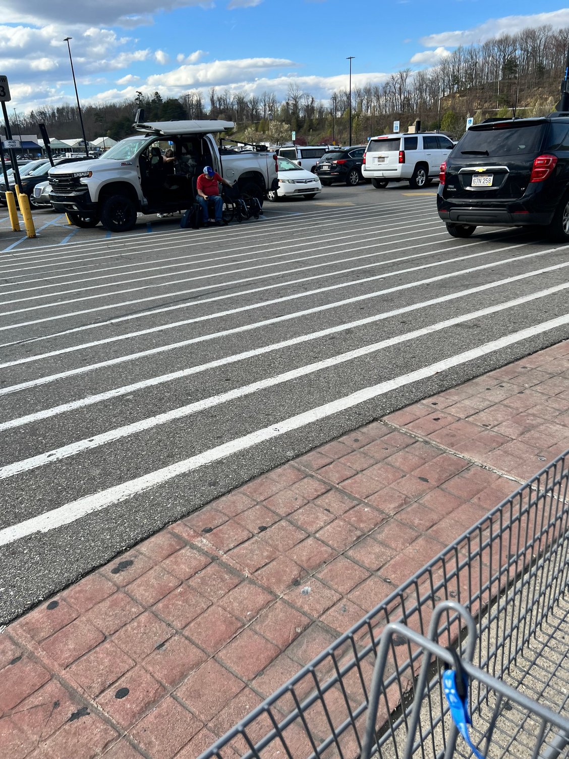

Not knowing the exact need, could you do something like this? This guy had a crane type thing that swung the drivers seat out and down to the ground, I’m sure this prob wouldn’t be cheap though. I am amazed at what can be done with vehicles, this was super cool!
Old Mar 31, 2024 | 08:23 PM
  #60
twobelugas's Avatar
twobelugas
Joined: May 2021
Posts: 4,006
Likes: 2,330
companies like this does it
https://www.atconversions.com/atc-tr.../#truckpricing
But no, not cheap at all.
