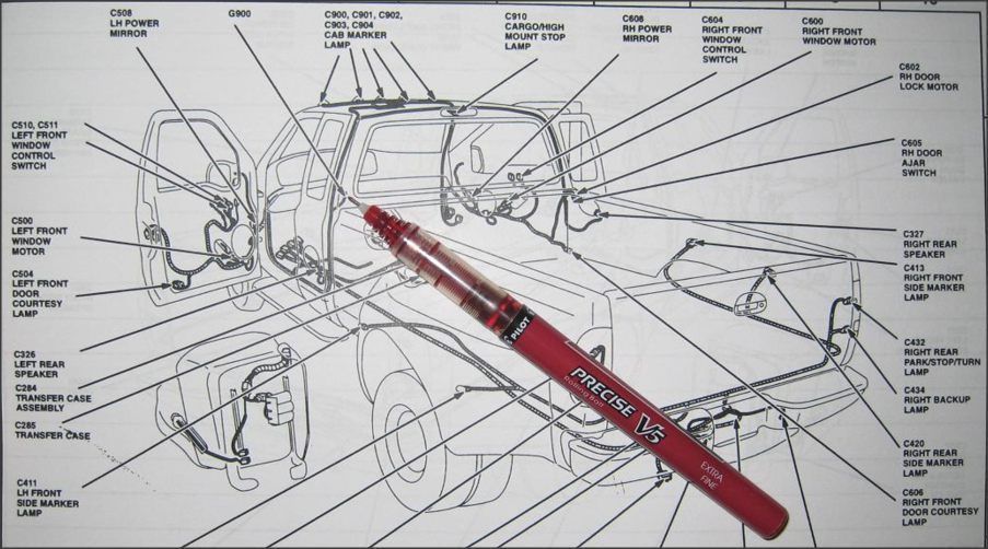

G900 is located LH Rear of cab is the best I could find in few minutes, however lot of other components also use the same G900 Ground.
There are two splices to a main harness, S233 and S300 before the G900 ...
See below:

^^^Outstanding use of a Pilot pen as a pointer. A gazillion points to Griffendor.

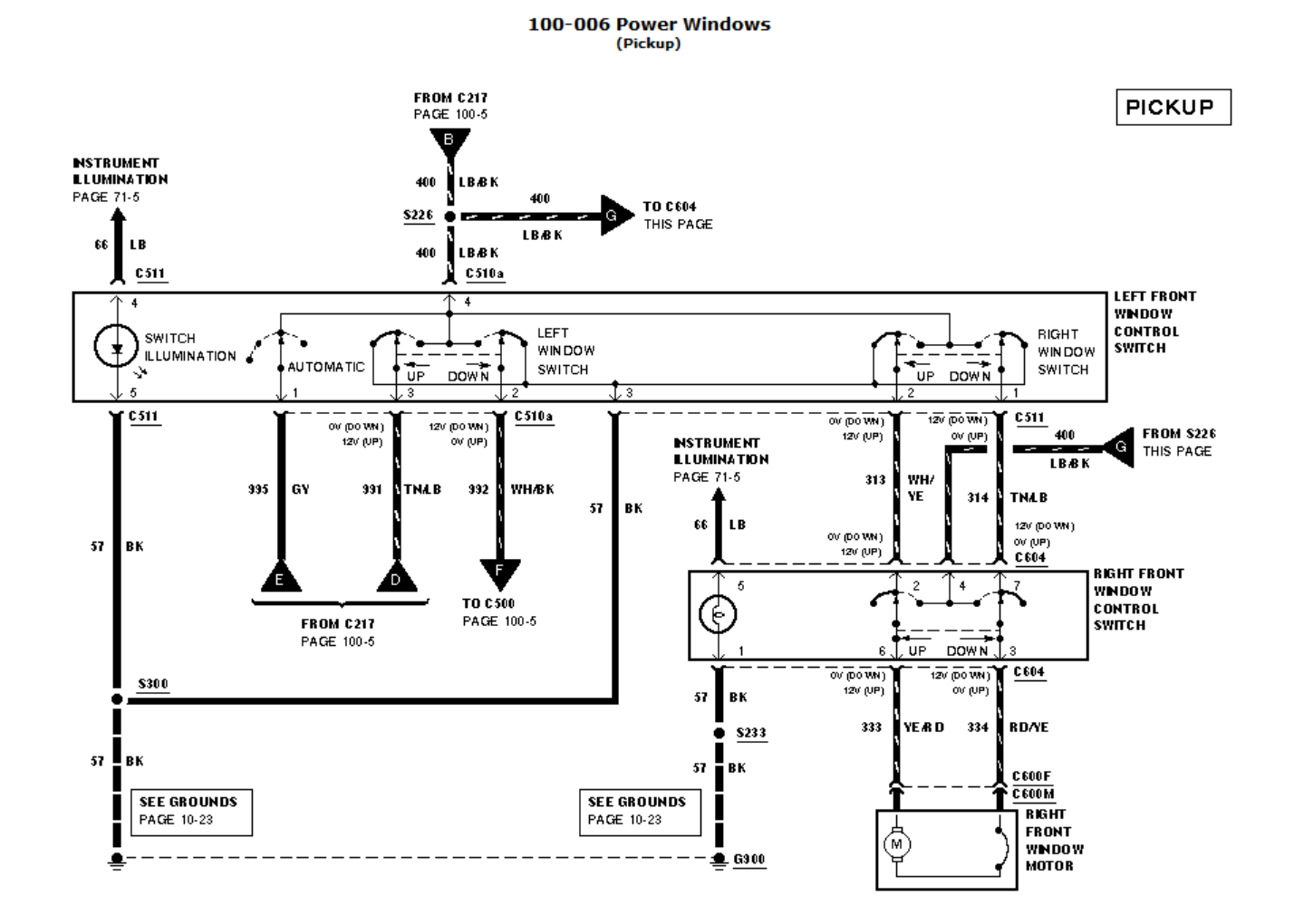

Based on your profile indicating you have a 2000 MY (Model Year) truck, below I have pasted a couple of wiring diagrams and details from the FSM (Ford Service Manual).
100-005 & 100-006 are for regular and super cab.
100-007 and 100-008 are for crew cab.

Well I should have been more specific, darn it. The PS power mirrors operate, the PS door lock button operates, it is only the power switch. I ordered a new one from amazon, the new switch is lighted and those come on, but no operation. I reviewed the wire looms between the doors PS and DS and nothing noticable there. I did also buy an entire motor and rail replacement and just to be sure I connected the new motor to the electrical connector and it doesn't work, which means - I think that I am not getting power to the motor. I am going to work on the ground which according to the wire diagrams (thank you) seems to be behind the rear driver passenger on the column going up to the rear window. Wish me luck. Keep in mind, it does work (not great) when it is coldish, but not any other time. I was thinking per your suggestions that maybe it is the driver side master switch - any ideas how to test that?
Just ordered a master switch from Amazon now. I was thinking that if it was a ground wouldn't the other functions be inconsistent?
