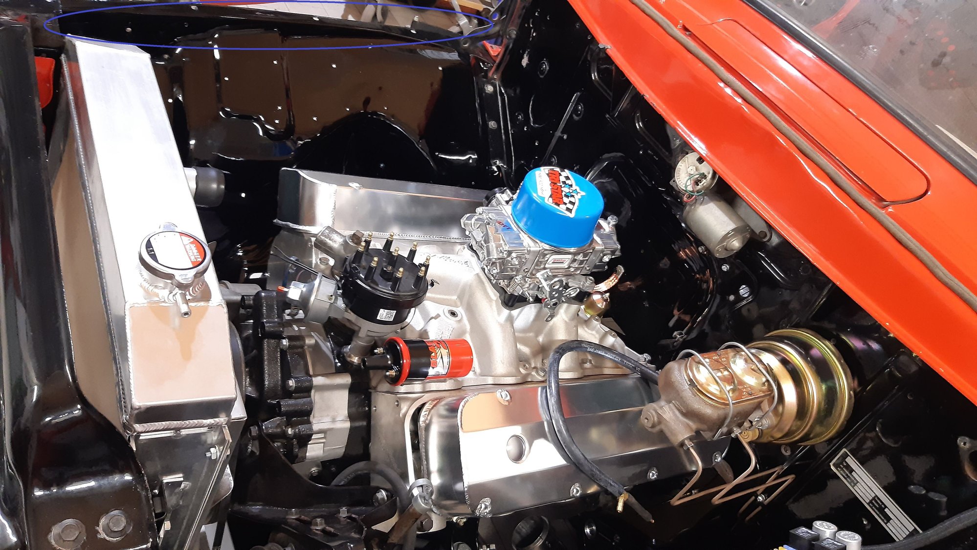

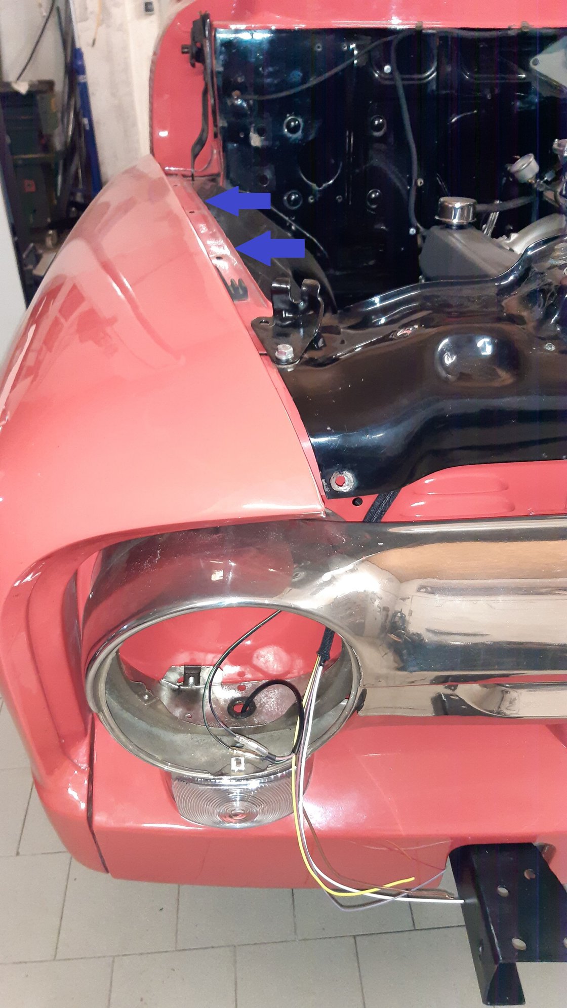

Does something belong between the inner and outer fender?
Does something belong between the inner and outer fender? ...Fenderwelt? ...Rubber Insulation or just metal on metal?

Not sure about the 56 F100 model year trucks but my 49 F1 had what's called "anti Squeak" cloth like material between the inner & outer fenders.

My 54 has nothing between those metal pieces.

Both of my '53s were metal to metal.
The parts/service books don't show anything.

rear fenders to bed side got a small amount of anti-squeak. Actually the top of the inner fenders to to front fenders should get a small amount.
door inspection covers got it as did the running boards to rear fenders. Front gravel pan to fenders and air deflectors too. I put the stuff everywhere that 2 body panels meet but not so much that it squeezes out and makes a mess
