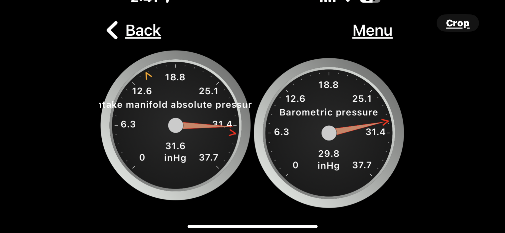

Just a short thread on verifying your map sensor
a lot of us clean clogged map sensors and it would be good to have a way to verify that the cleaned map sensor is still good.
You need to set up two monitors
manifold absolute pressure
and
barometric pressure
With key on Establish the connection For your software
do not start the truck
Again with out starting the truck. Check your two monitors
I would consider this on a not pass

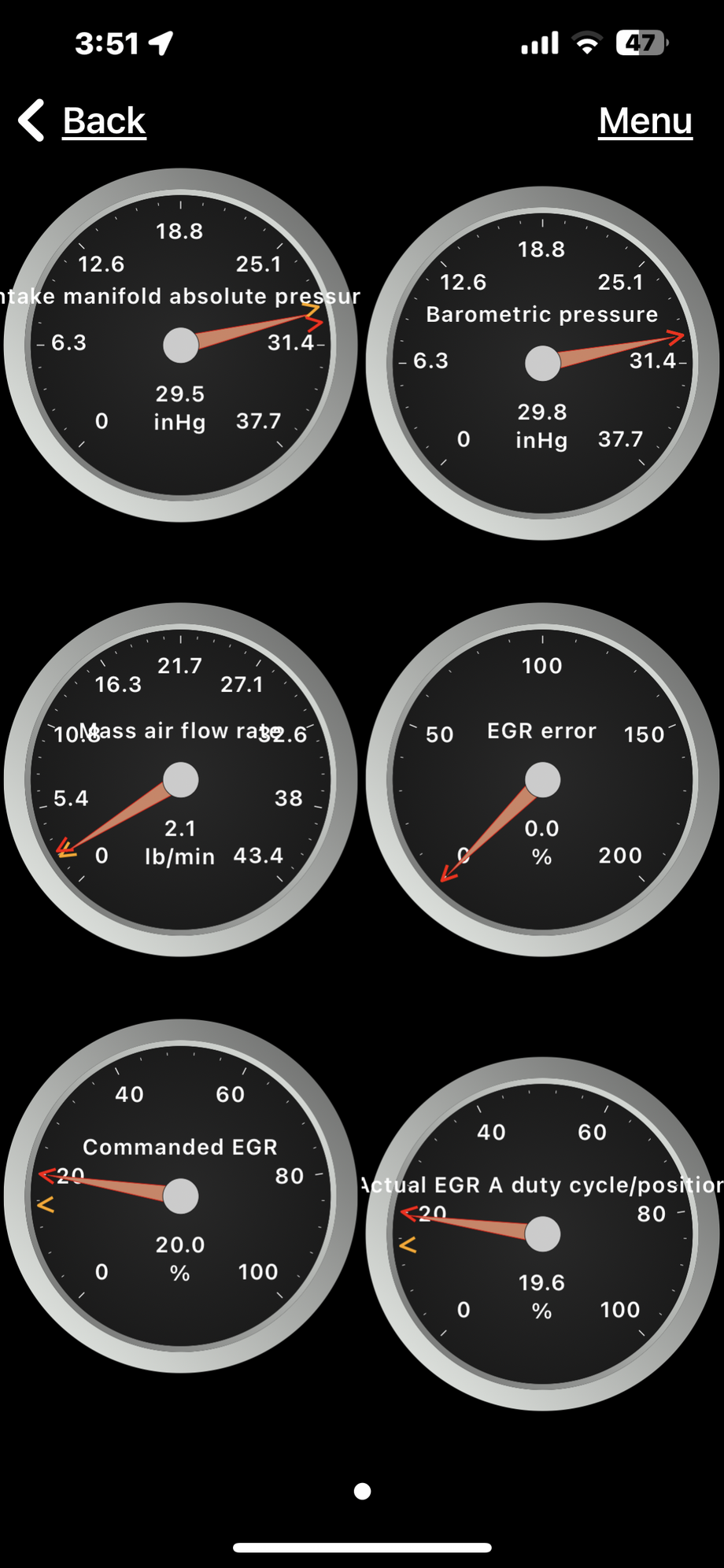

I would consider this one a pass

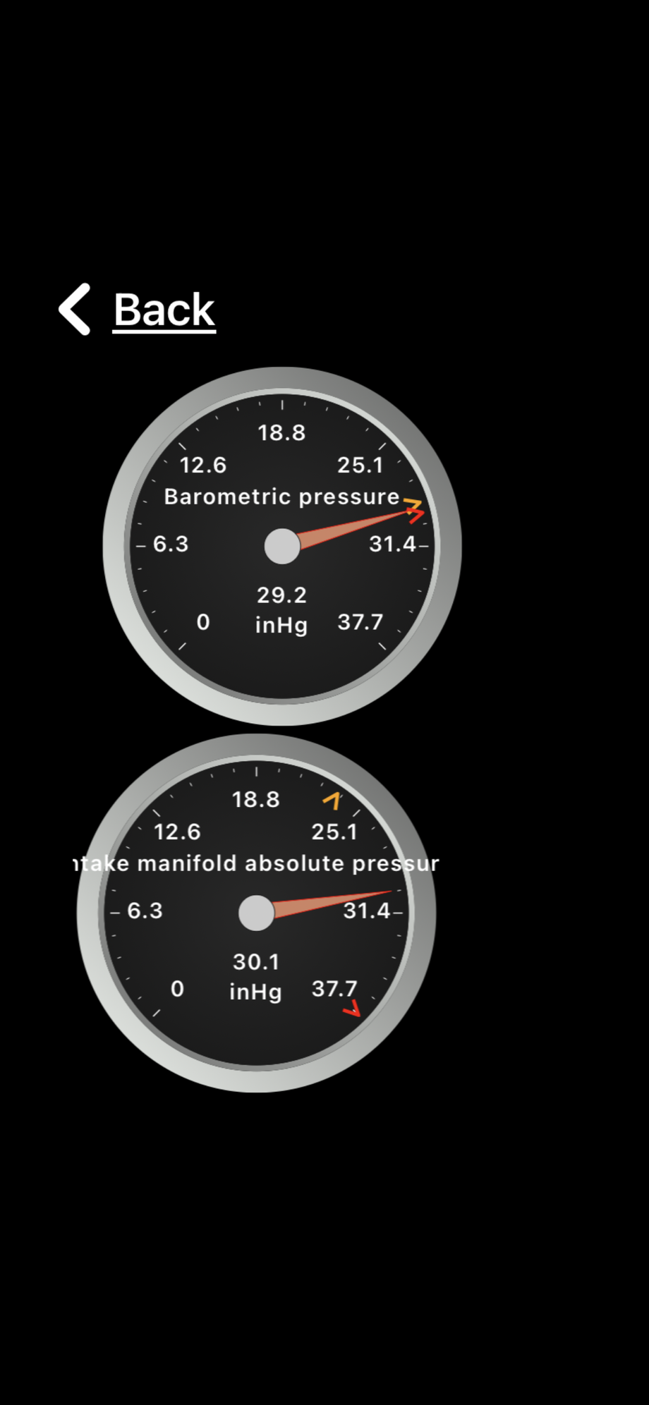

another not pass

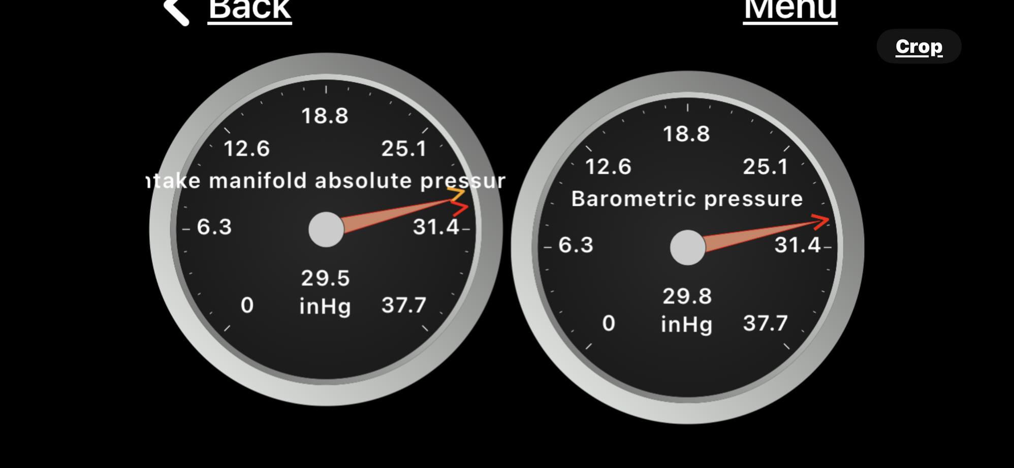

another pass
If you have a defective MAP, it will tipically shut your egr valve off. And you would have no egr flow at idle
Vs a properly working map and you would have egr flow showing close commanded vs actual
