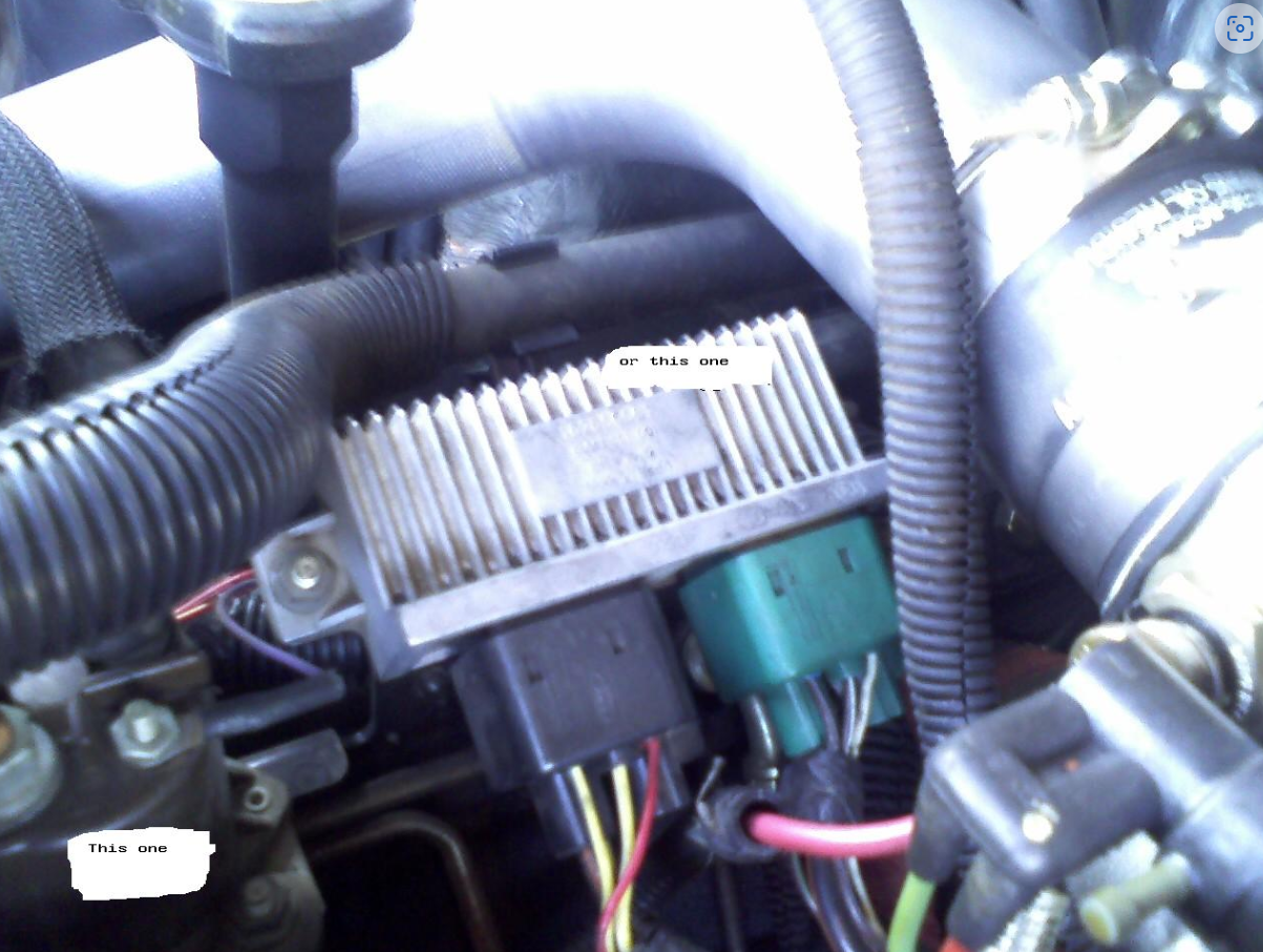

Welp I'm confused. If the truck is built to Federal specs not CA specs, it should have a GPR and take the AWA4. If it instead has a GPCM like CA trucks, then it would take ATA2. If I'm reading the pdf right. Take a look under the hood and see if the truck has a GPCM, see pic below. I nabbed the pic off the web so ignore the text, just showing the GPCM which is the finned aluminum box with green and black connectors. Then we know whatcha got.
All that said IIRC there were some early 1999 CA model Excursions with a GPR. So we're back to taking a peek under the hood.
Is the truck registered in CA?

I don’t have that glow plug control module just the two relays. I’ve never seen a 2000 rpm high idle before though! Even for a pto that’s kinda fast! Is there anyway to bring it down? My stock high idle is 1100 rpm but when using the tuner it shoots to 2000 rpm and stays there. Obviously I am not trying to drive with it on high idle but I am afraid it’s gonna be tuned differently on the tow tune and could blow up. I am new to these powerstrokes and only worked on IDI’s so i’m not sure what could go wrong with a wrong tuner??? So I apologize if I sound so dumb.
also yes the truck is registered in California and the PCM reads ATA2. Build date says 12/98 too! So it’s not an early 99
