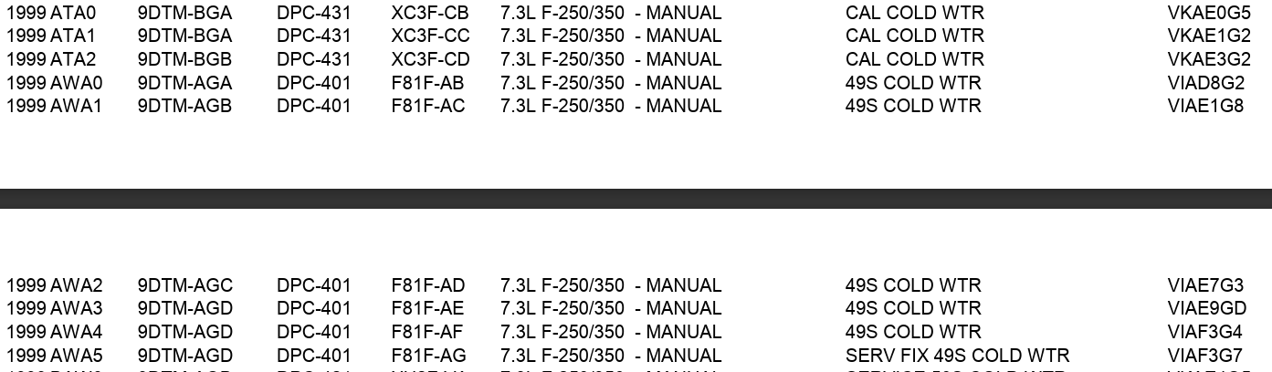

Thanks for confirming Chet! You sneaky GPR guys
Originally Posted by RA67M_
also yes the truck is registered in California and the PCM reads ATA2. Build date says 12/98 too! So it’s not an early 99
12/98 build date is indeed an early 99 fwiw. There were no 1998 model year Superduty trucks, was all new for 1999.
Yeah I would not want a 2000 rpm high idle either. Did it come with documentation saying what the RPM should be?
Kinda stumped by the ATA2 code on your PCM. The main difference is GPR (Fed) vs GPCM (CA). They do list different PCM families; the ATA2 is a DPC-431 and the AWA4 is a DPC-401. I assume that is due to different pinouts required for GPR vs GPCM wire harness. So it looks to me like you should need the AWA4 since you have a GPR. Seems like I now enough to get confused here but not enough to help.

No you’re right!!!! I just currently don’t have any gauges since I didn’t think I’d need it staying conservative at the 50hp/tow tune. I was just afraid the tune was gonna be too hot and blow the injector tip or something. I’m more used to mechanical diesels so I am sorry if I sound dumb but outta everything I am just misinformed on these newer diesels !!!

To answer your question about what’s the set high idle on these tuners, I see everyone say anywhere from 1100-1200rpm max on these Edge Revolver tuners. Part number is 14004 and it’s a AWA4 master code tuner so you’re possibly right on it working for me!

Thanks man I appreciate you all being patient with me! I called edge today and they confirmed that they DO NOT make anything compatible with my pcm code which “explains why it behaves like that on the high idle” they said. So I guess I am back to having no tuner and no way of being able to return it!
Originally Posted by Bonanza35
Some one just set it high because it was for running equipment or something like the power take out. The tuner could adjust it if you wanted. And some of the last 1999 trucks had intake heaters and late turbo set ups. My neighbors stick 12/98 had no cat! but the 2000 on I believe did and the auto didn't. Mine does because it is 9/98.
Sadly I guess the high idle problem was just the tuner not being compatible
Well lesson here is don’t be a ******* like me and check your pcm code FIRST BEFORE you buy a tuner HAHAHA

What about sourcing a PCM that is compatible with the tuner? If you're smog exempt what difference would it make?

I like udsuths idea of getting a PCM to match the tune. Kinda elegant solution.
But for chits n giggles I'd try to run the tunes you have. A 2k high idle tune is stupid but still useful and not necessarily a problem. Just get the EGT installed first. All the cool kids have them. Then you can monitor the biggest danger to the engine as you test the tunes. Maybe whatcha got works ok.
And be very careful about the smog requirements for your truck. Be 100% sure.
