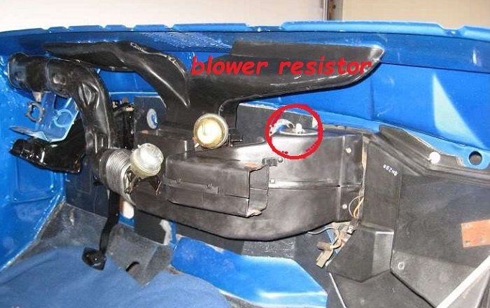

If the speed doesn't change it's probably the resistor pack in the evaporator area.

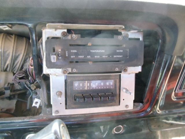

Ok update... I pulled out the dash unit. The back of the switch looks to be in pretty bad shape, the wire is pretty black towards the metal connector. There are 4 posts and only a single orange wire connected to the closest top post (see attached pics). I can't find any diagrams but I am assuming there should be a 3 or 4 plug connector attached to this and not just a single wire.
I am hoping this is the issue with my system having a single slow speed. Please help me troubleshoot further. Questions:
1. Is there another wire harness/plug behind the dash that should be connected to this switch?
2. Is there a way to check the switch for functionality with a voltmeter?
3. Is there an easy way to bypass the switch to make sure the blower motor spins faster?
4. How do you remove the switch to replace it? Can't find any help onlye
5. What is the part number for the replacement switch. factory ac and heat

here are the pictures I took of back of dash unit

If you remove the resistor from the ducting (or just unplug it from the harness), the fan will only blow at full speed regardless of the speed you set the switch on the dash. You can use that as a temp work around if you're needing to source parts, etc.

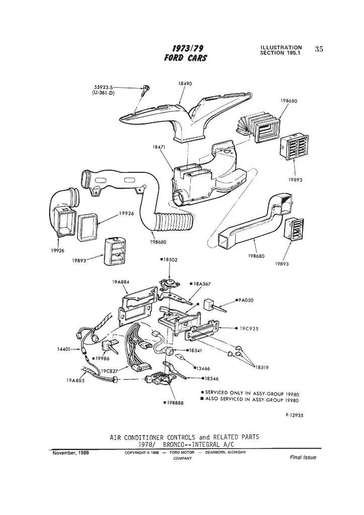

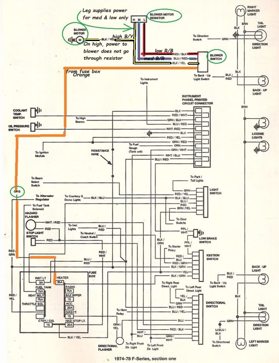

Ignor the yellow marking. At the bottom of the drawing is the plug that goes on the switch. You can remove the dash trim and then pull the heat / ac control section out towards you. You'll need to pull the headlight **** loose (button on top behind dash) and the wiper **** (tab).
Below is the switch to blower wiring ... not sure what you'll find after these years.

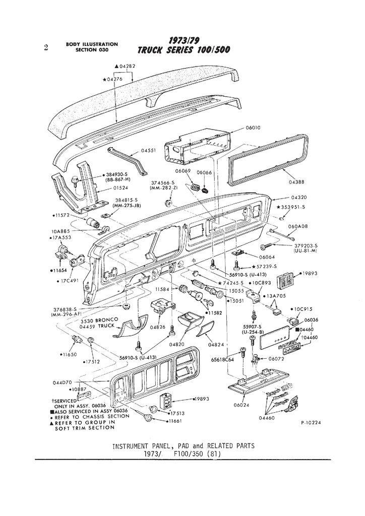

4. How do you remove the switch to replace it? Can't find any help on line. Once you get the instrumental panel trim bezel off, the switch itself is held in place with a couple of screws. That you can access by removing the complete environmental panel. I'd take the radio out 1st.

Then take the 2 upper and 2 lower screws out and the complete panel pulls out (just a little bit) to access the blower switch. Yellow button is what you push (and hold down) to get the headlight switch shaft AND **** to come out as one piece. That is the proper way to remove it, some folks just yank the **** off.

the blower resistor has 3 wires plugged into it under glove box. I’m going to trace those wires and see where they go

OK, I got the issue fixed! On the AC switch there was only the orange wire connected. I remove the instrument cluster and way in the back there was a plug for the AC switch that was cut and hacked up for some reason. I got it fixed and plugged it in and now I have four range of power with the functioning switch. All is good. Thanks for everybody’s help.
