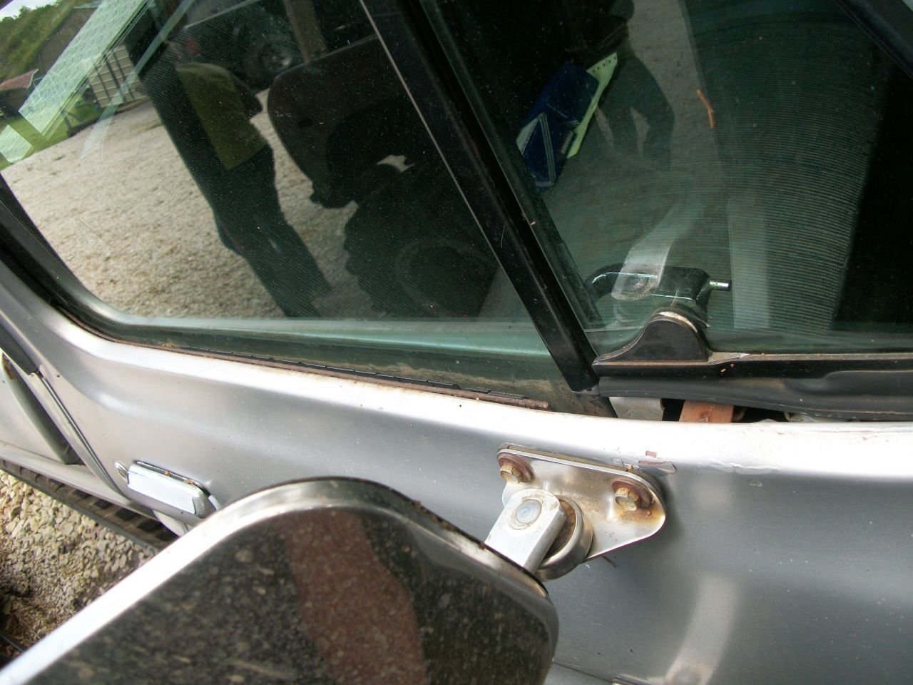

And the door itself. Never noticed it before until I got my new door put back on the truck. Is this normal or am I missing something? My concern is excessive water going in there.
Gap Between Vent post and door. The outer anti rattle strip is missing, I know and I have a new one on the way.

I have a similar gap on mine. I think the mirror (from wind resistance??) pulls the outer door skin outward over time. It looks like there is a small crease between the mounting holes that indicates, to me anyway, that the door skin has been pulled outward.

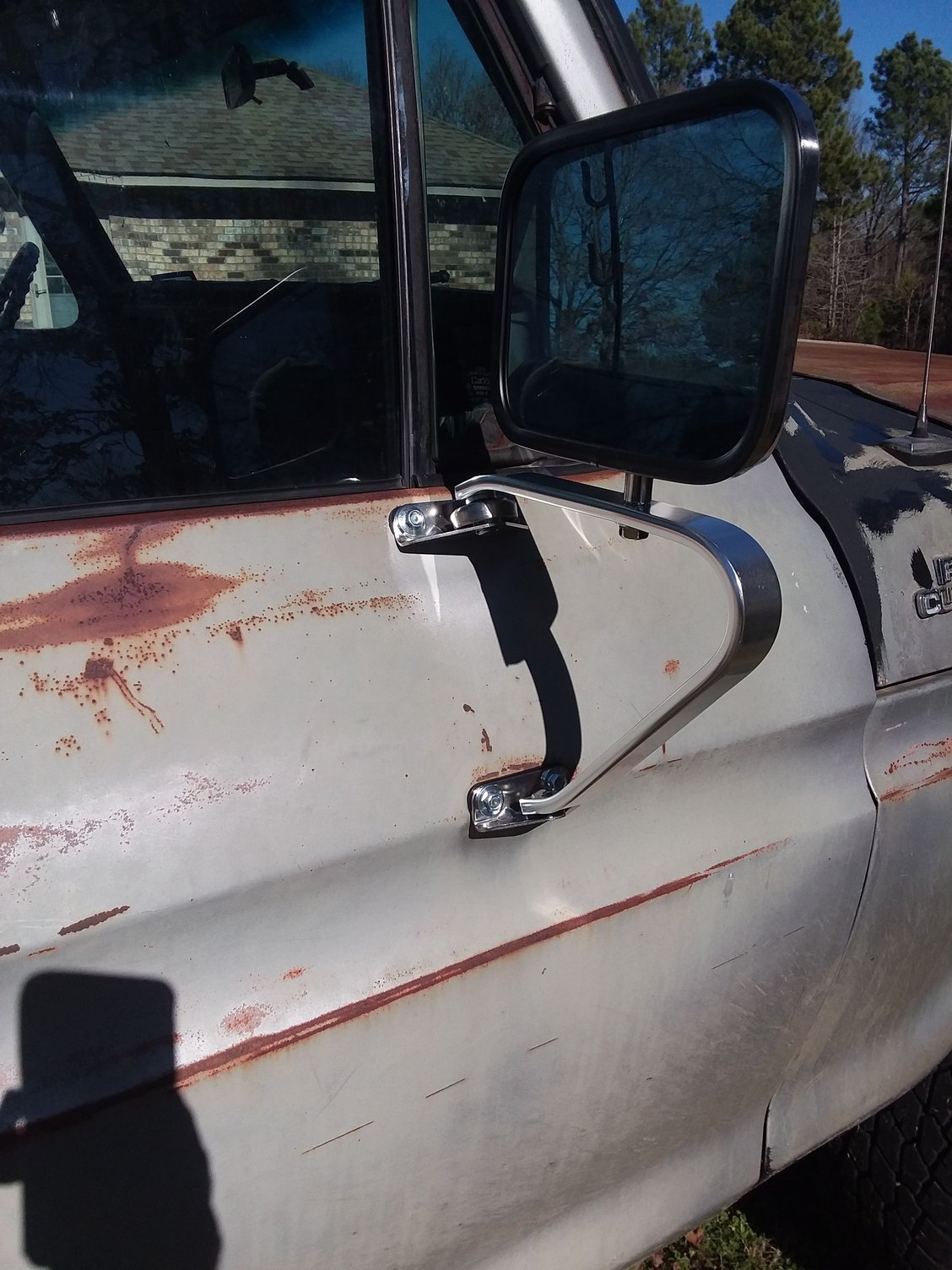

You have water get in there any way, that is why the door have drail slits on the bottom. X2 the anti rattle strip will help with the gap, but yes that outer door skin looks a little pulled. To make youself feel better about it..... here is an example of really pulled door skin.
The car port lower frame hit (landed on) the mirror backet on its way down during the storm. I think it came up and down a few times. You would of thought that the mirror hdwr nut-serts would of just pulled out the door skin. But NO it had to bent the door skin and the mirror bracket.
Yes the carport is setting on the top of the cab. But no hood or cowl damage.
And on one of it trips up and down it took out the drip rail.
Here is what I can back from over seas to...ol Blue did not have a scratch.

You are missing about 3/4 of an inch of the rubber gasket for the vent window. It extends towards the rear. A little flap
Yours has been torn off.
Zoom in and I think you can see it.

Ah..ok. that helps. I happen to have a vent window gasket...maybe I'll trim a piece off and epoxy it in place.

I see what you mean...yes it does seem to be pulled out a bit. If I apply a bit of pressure with my hand it gets better. Can't keep it in place so I guess it is what it is.

Sho nuff....mine has been trimmed. Now I wish I would have used my new vent seal but I thought the original was in good shape so I didn't bother.
