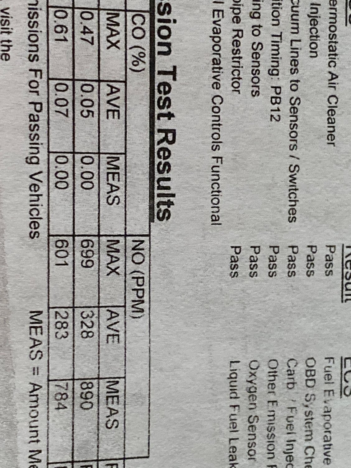

I just took my truck in and it failed smog. It's a 1988 F-150 302 v8 with an AOD. The NO(PPM) was too high, the max for that on my truck at 15mph is 699 and at 25mph the max is 601. Mine measured 890 at 15mph, and 784 at 25mph. I just pulled KOEO codes from it and I got
44- AIR system inoperative – Air Injection
34- EVP – (R) EGR did not respond properly during test – EVP
EVR – (O, R, M) EVP sensor is/was high – EVR
PFE – (O, R, M) PFE sensor is/was out of range – PFE
Could be any of these for code 34?
25- Knock sensor not tested (ignore if not pinging) – KS. It did ping like mad when I gave it the full throttle for the test. But it never pings daily driving it.
All of these codes were on my last test about a month ago. The battery has been disconnected between then and now. I was wondering where I should go from here to fix it? I do have a vacuum leak on the intake manifold and a broken vacuum line to the vacuum reservoir. On the smog sheet it says that EGR functionable is not applicable. The air injection did pass, and the vacuum line to sensors/switches did pass.

High NOx = lean.
Post full data. HC. CO. Etc

sorry to take multiple photos don’t want to give away techs name.

Sort your lean issue, that should absolve the issues. Just plug anything not critical at the vacuum tree.
1.5% CO is about 14:1...yours reports 0 if I read that correctly.
What state needs a 35 year old vehicle smogged?
