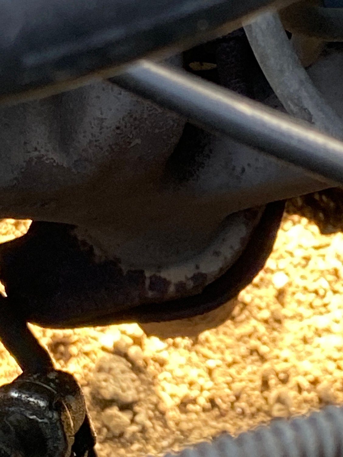

Any exhaust leaks pre O2 sensor? If so, I would address those before much else. The OE exhaust manifolds are well known to crack, mine were replaced in the late 90s just before I bought my truck in '99 (it is an '88). Can you post a pic of the Y pipe leak? It could be an easy fix.
I have been taught oil leaks can create vacuum leaks at least valve covers are easy to knock out with the updated gaskets from places like Felpro and the like.

I can get a photo later, my phone won’t load pictures with bad service. I see bends in the manifold where it should mate.
Oil leaks are from oil pan and rear main.

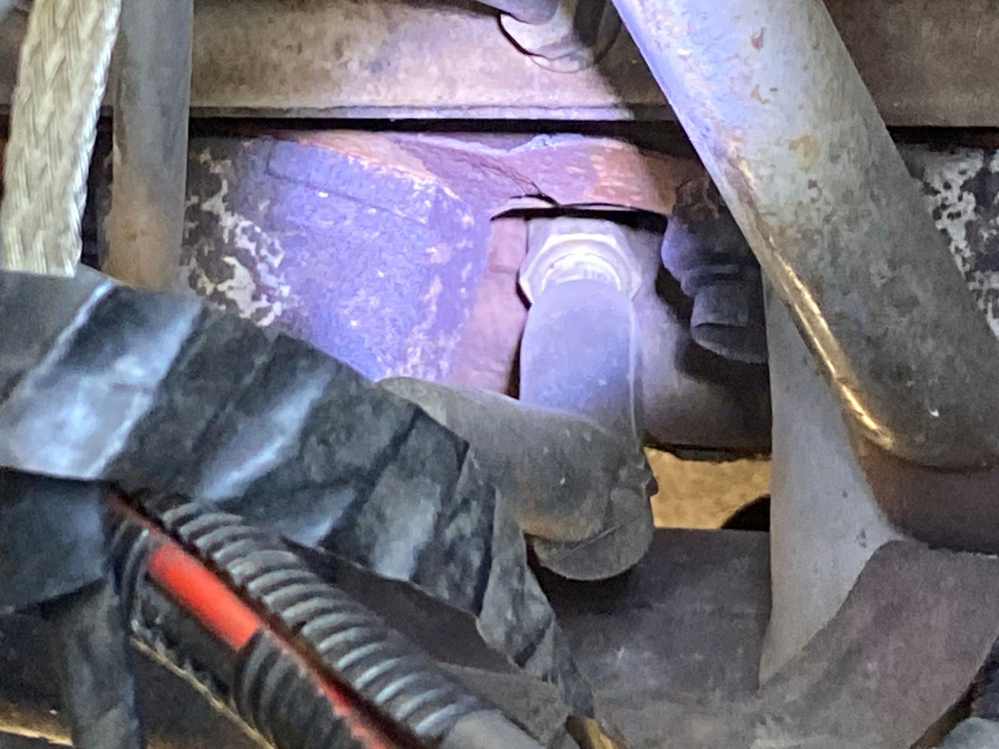

I think this is a leak
I ran KOER again just code 34 and 44. The tube on the bottom of the EGR was 140 after driving so I don’t think it opens.

Get a smoke machine on it and do the job right, no guessing
