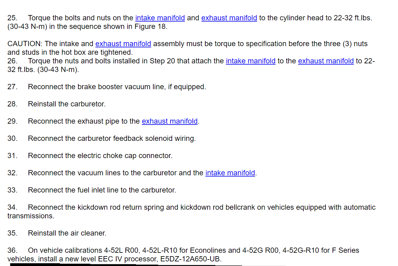

EXHAUST - 4.9L - MANIFOLD WARPS AND
LEAKS
NOISE - 4.9L - EXHAUST MANIFOLD WARPS AND LEAKS
Article No.
88-7-16
LIGHT TRUCK:1984-86 E SERIES, F SERIES, BRONCO
WARNING:This modification is authorized only for the listed engines. Performing this modification on other engine calibrations is unauthorized and could create liability under applicable federal or local laws.
ISSUE:A leak at the exhaust manifold may be caused by the exhaust manifold expanding more than normal and warping under certain operating conditions. The expanding and warping exhaust manifold causes the manifold retaining bolts to lose their torque which results in the leaking condition.
ACTION:To correct this, install a new design exhaust manifold kit that contains a warp resistent exhaust manifold made out of a high silicon cast iron and new steel hot box studs. On selected calibrations it will be necessary to install a new level EEC IV processor. Refer to the following service procedure.
1.Remove the air cleaner.
2.Disconnect the accelerator cable or accelerator rod at the carburetor and remove the accelerator return spring, if equipped.
3.Remove the kickdown rod return spring and kickdown rod bellcrank from vehicles equipped with automatic transmissions.
4.Disconnect the fuel line at the carburetor.
5.Label and then disconnect the vacuum lines from the carburetor and intake manifold.
6.Disconnect the carburetor feedback solenoid wiring at the carburetor.
7.Disconnect the electrical connector from the choke cap.
8.Remove the carburetor.
9.Disconnect the exhaust pipe from the exhaust manifold.
10.Disconnect the vacuum line for the brake booster, if equipped.
11.Remove the retaining bolts and nuts holding the intake and exhaust manifolds to the cylinder head.
12.Lift the intake manifold and exhaust manifolds as an assembly from the vehicle.
13.Remove the gasket from the cylinder head.
14.Remove the nuts holding the intake manifold and exhaust manifold together.
15.Obtain Exhaust Manifold Service Kit, E4TZ-9426-D.
16.Clean the intake manifold, exhaust manifold and cylinder head mating surfaces.
17.Check the manifold hot box mating surface for warping. If warped, the intake manifold must be replaced.
8. Replace the choke tubes and choke control insert in the exhaust manifold, Figure 15. 19. Apply graphite grease, (C3AZ-19578-A) on the mating surfaces of the intake manifold and exhaust manifold. FIGURE 16:
20. Assemble the intake manifold to the exhaust manifold. Use the new nuts, bolts and washers supplied in the kit. Do not torque the bolts at this time, Figure 16. FIGURE 17:
21. Install the new intake manifold gasket supplied in the kit, Figure 17. 22. Apply graphite grease, (C3AZ-19578-A) on the mating surfaces of the exhaust manifold and cylinder head. 23. Carefully position the intake manifold to the cylinder head making sure not to move the intake manifold gasket out of place. 24. Install the new intake manifold washer clamps, bolts, nuts and studs supplied in the kit, Figure 17. FIGURE 18:
NOTE:To check the manifold hot box mating surface use an intake manifold that you are sure is not warped.

@R&RFord thought this might interest you since the graphite paste you have is mentioned in this TSB

OP, you dont have a 93-96, but do you have heat shields like these at all on your muffler or cat? Ford TSB applicable to my truck which indeed has this issue is giant worm clamps

So manifolds to head first then each manifold to each other.
Now will I remember for the next time this comes up
Also dont know if I have seen how the bolts get tighten to the head?
Think I have always started in the center and did a circle going out from there?
Never used any grease
Dave ----
