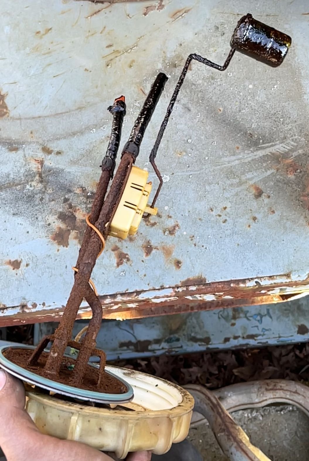

Can you post a picture of your old one?

Mine is still in the truck but here is my slightly ​​​​​​ rusty spare one.

You are going to have to be creative. There is very little to no aftermarket parts for cab and chassis trucks and ford only has to supply parts for 15 years. Find one that has the same or similar top, then change the rest however it needs to be done. Most likely that is either 5/16 or 3/8 tubing. Check out this one to start, it looks close.

Just some more info, if it's just the sending unit sensor you need, a Bronco one will work . That's what I was using in my Bronco the past 6 or 7 years after my diesel swap (same gas sending unit sensor, just modified the pickup tube to reach the bottom after removing the fuel pump.) My sending unit sensor just died recently (about 300k on the chassis), so I bought a new sensor and swapped it in. The sensor should be screwed into the sending unit somewhere, then it just plugs into the top of the unit.
