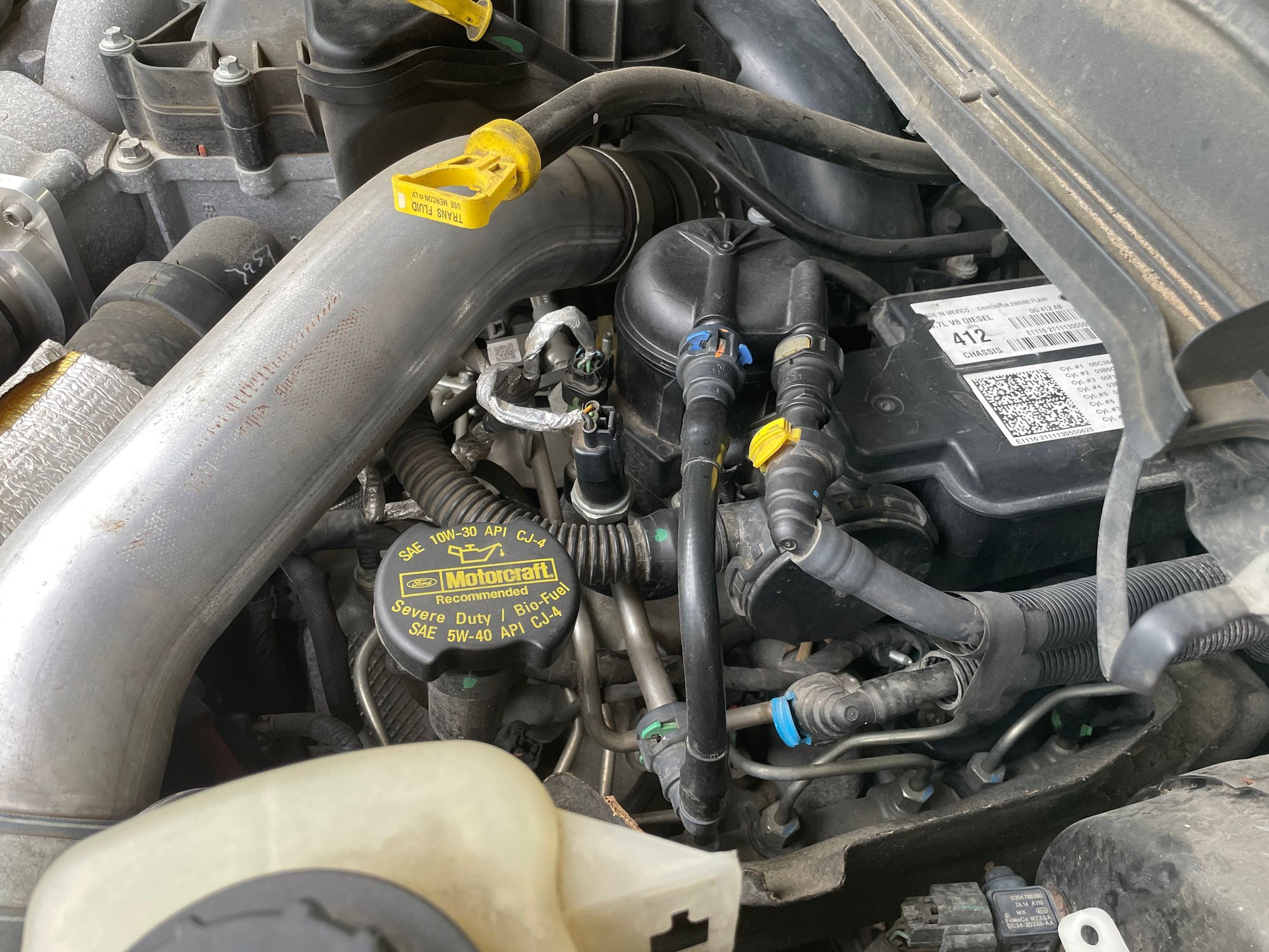

5 years ago I had my emissions deleted and s as CP4 kit installed.
For sheets and grins I looked to see the kit installed but not sure what I’m looking at.
now I’m wondering if it was installed

It will be hard to tell with everything installed.
there will be a hose coming from a plate under the metering valve.
i think the lower half intake will block your view.

tradosaurus's Avatar
tradosaurus
Posts: 769
Likes: 156
S&S cp4
i could see a plate with an S on it so I believe this one is it.

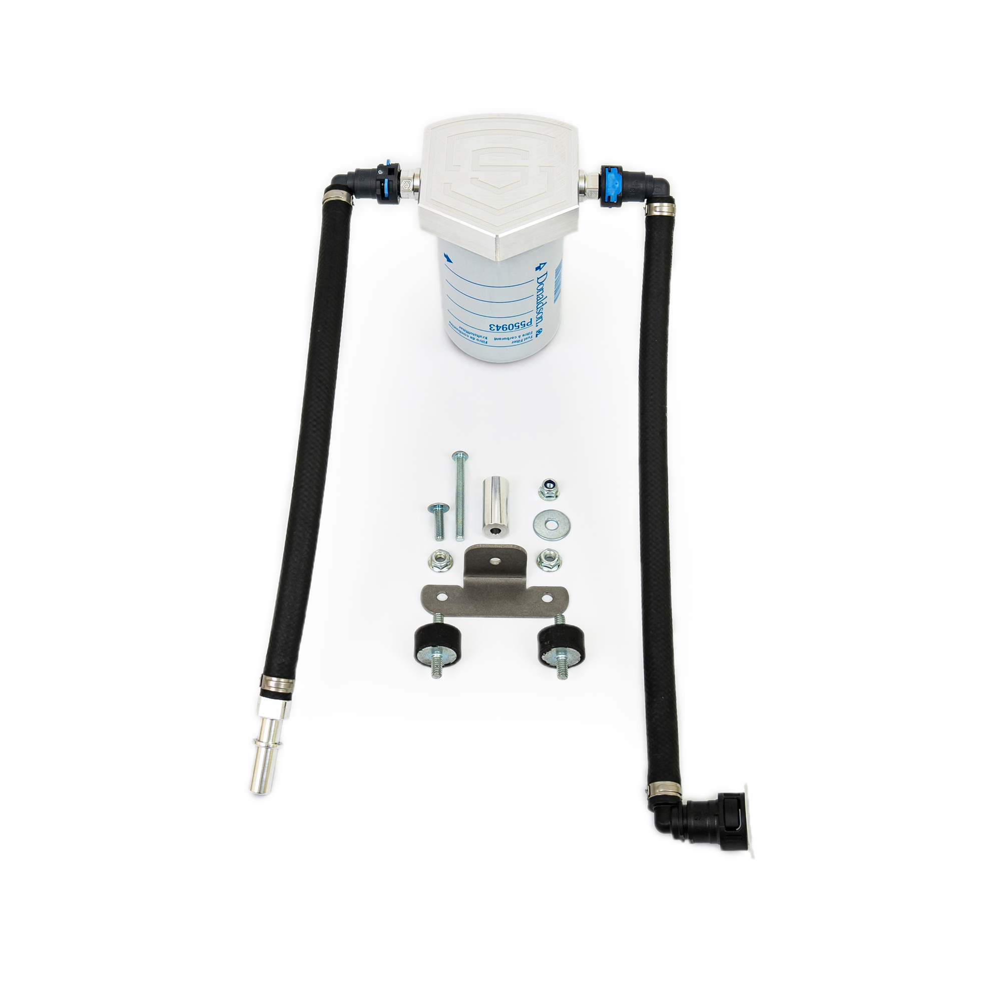

so how easy would it be to adapt to the newest kit?
Newest kit

I'd reach out to S&S and see if you could upgrade with what you have...
When they came out with the Gen 2 kit, originally with the SNAPP filter, they extended the line out to 25 inches and tee it off...This is the Gen 2.1 update because the company Parker Racor (or Racor Parker ??) couldn't keep up with the demand so S&S went with a spin on filter set up.
The return filter/head with hoses can be purchased for $160... but I don't know exactly what you have and I'm not sure the original Gen 1 kit they designed will work with just the return head/filter/hoses or if you would have to buy the whole kit for $400.
Take some more pics of the plate and hose...

S&S offers an upgrade option for the 1st gen systems it is in the drop down menu.
From the page : "For those looking to improve the debris management of their first-generation Disaster Prevention Kit, the S&S Gen2.1 Fuel Return Filter Assembly (#CP4-6.7F-BP-G2.1-RFA) can be purchased separately for $160.00 USD."
This kit "should" work on the copies of the early kit too.
It is also very easy to install even if you are not mechanically inclined. If you can change the fuel filter in the engine bay you should have no problems installing this filter.
