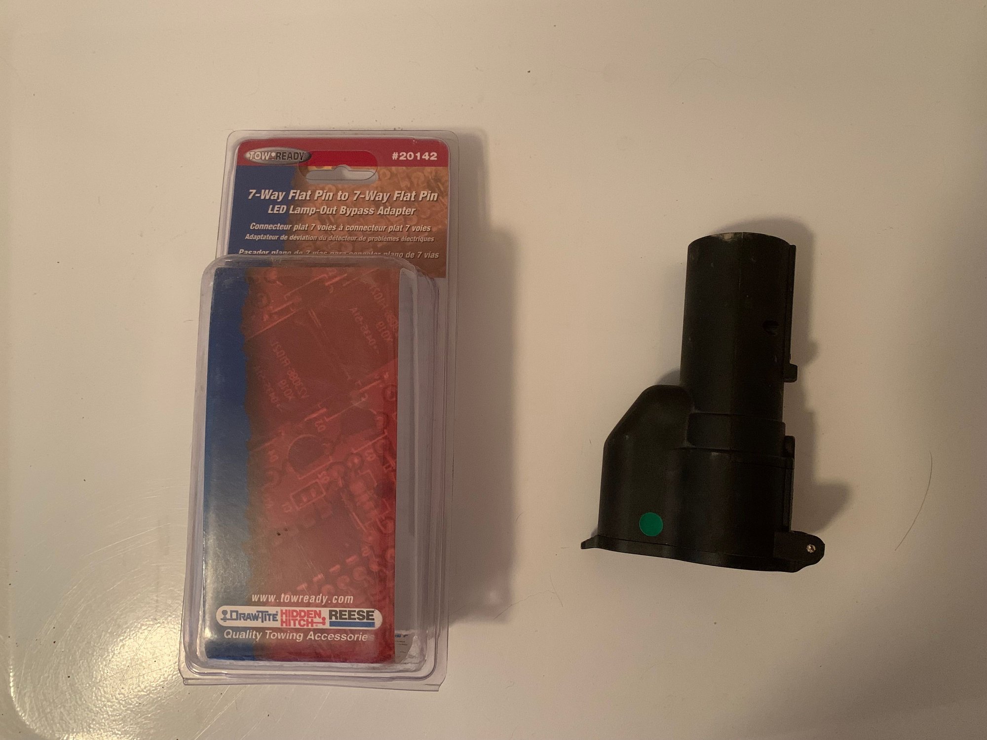

I think that’s the truck’s system sending a short, low voltage pulse to the brake pin to see if a trailer is connected. And I think different trailers/bulbs/LEDs react differently to that ‘test pulse’. I’ve seen it on a 7 pin connector I have. It is annoying and I don’t think it should happen.
GMs have issues like this when using disc brakes on their RVs. Sometimes folks report putting a small load resistor in line with the 7 pin connector. Maybe search for some kind adapter.
This one that Kurt makes. This one that Kurt makes.
