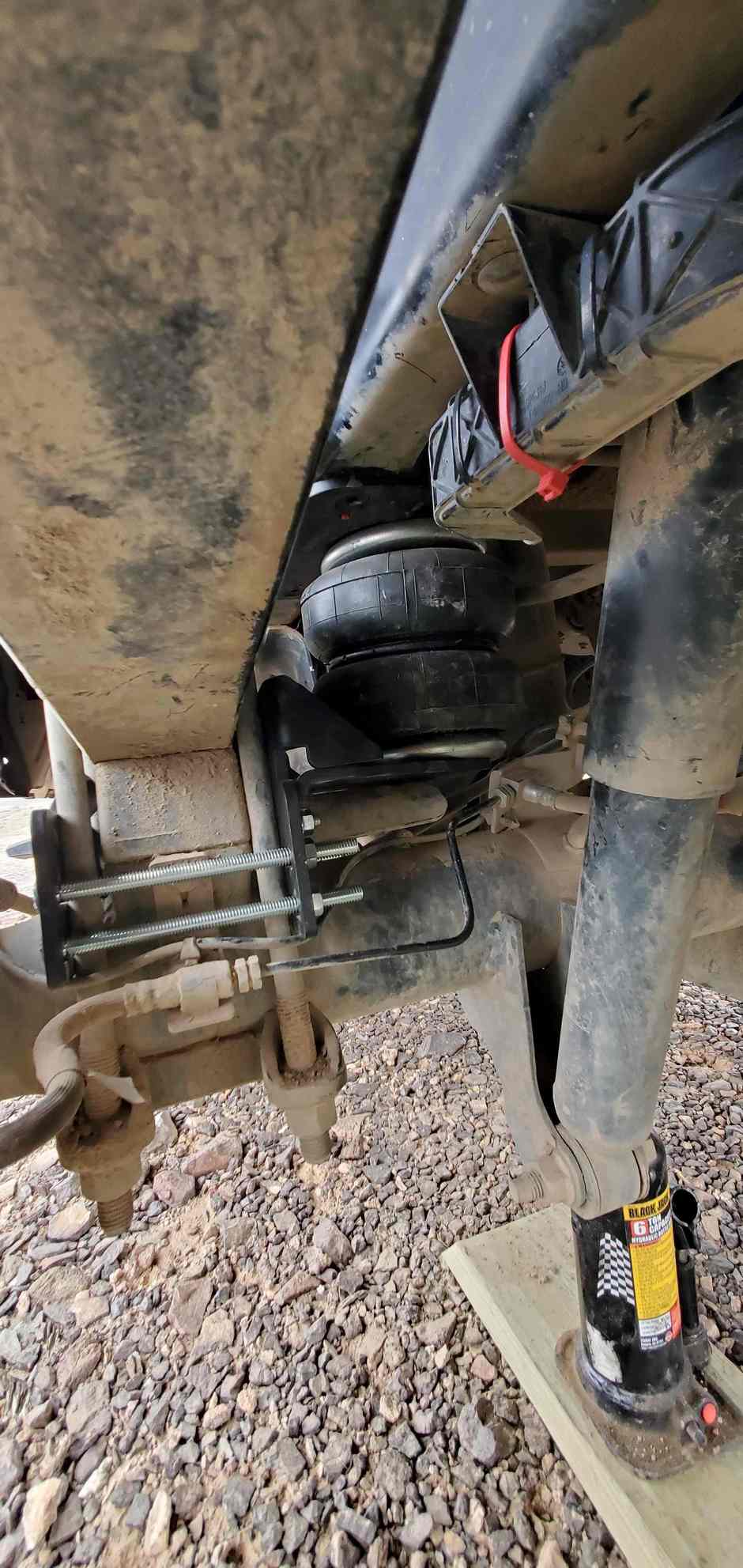

Thanks Fox-blue1, that had the solution. This is the pic that showed the proper configuration.

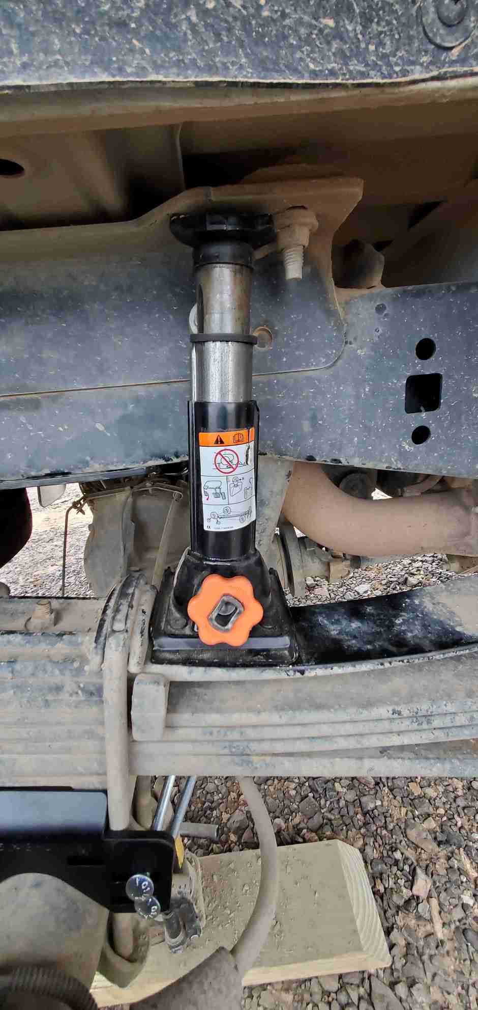

Here are a couple of pics. One is obviously the rear view and the other one is how I jacked the bed up for more install room.
