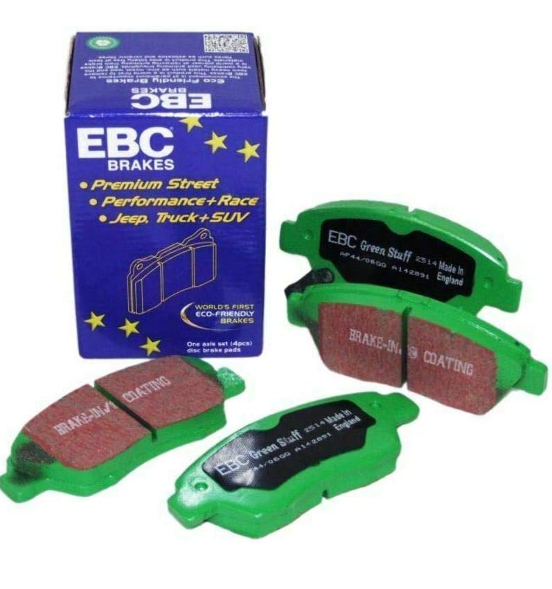

Stock Motorcraft brake rotors with ebc 'green-stuff' brake pads.

I think you mean ebc greenstuff pads and stock Motorcraft rotors. I would agree on that combo having experience with both.

Yup. Ebc. Edited.

Amazon Amazon
here is the pads he mentioned for a 1990 F350 do these pads look like what you have?
