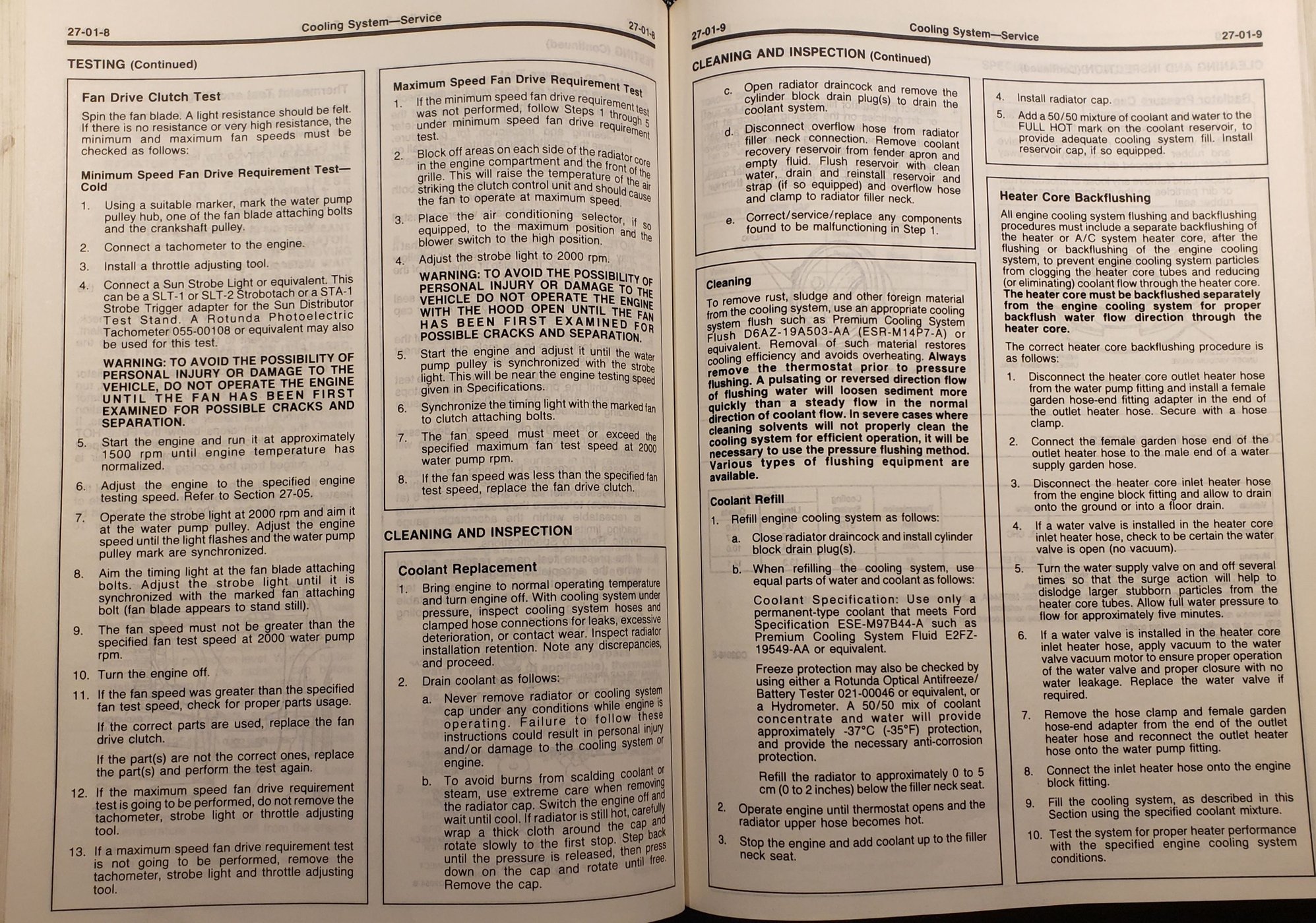

There is an old procedure in the books
This is it, from a (1989 Mustang service manual) (cooling system section 27)
You will not find many pros doing any testing like this with a strobe light
Hell, even a new ford fan clutch can be had for around 120 and the testing alone is 130?
You look for leaking oil (indicates a failure)
You can hit that thermostatic spring with a heat gun and watch it move the internal valve (or not) (indicating a failure)
You can then check its resistance to spinning and if there is enough oil in the clutch to cause the resistance
You are simply looking for that fan clutch to about lock up when it gets real hot
Good luck
