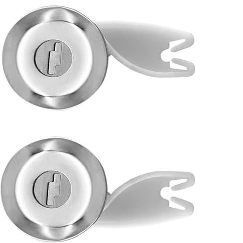

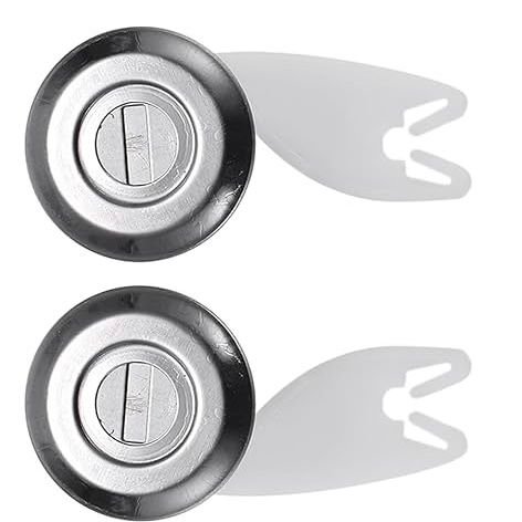

You can tell what style lock cylinders it has based on the hole shape, 96-97 has a straight line hole and 95 and older has a lightning bolt looking hole.
95 and older lock cylinder
96-97 lock cylinder
