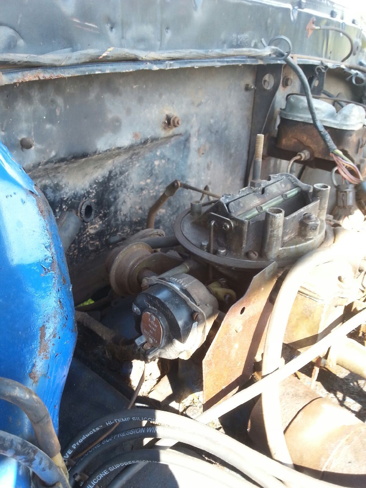

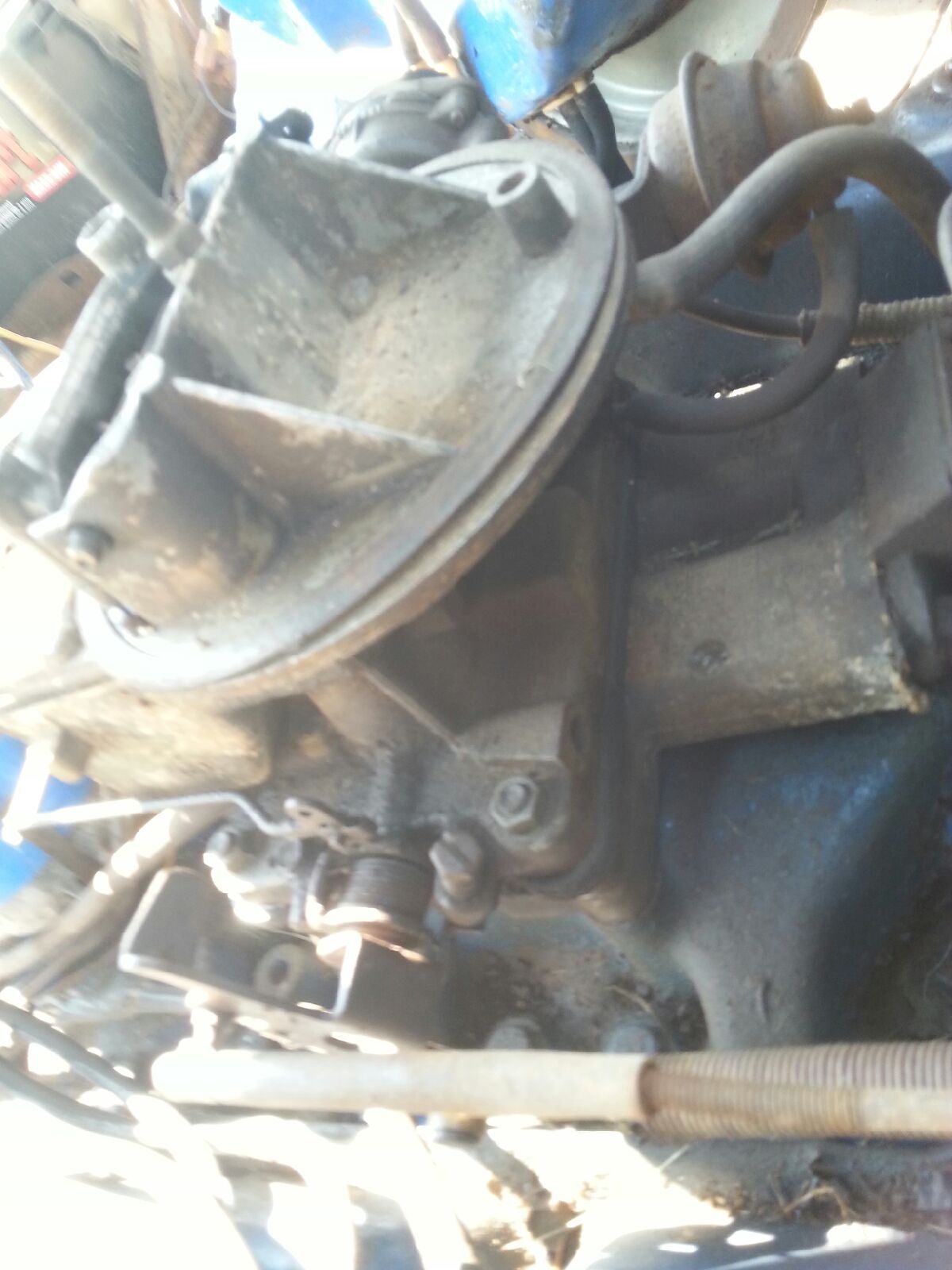

The accelerator pump on this carb is leaking. I am looking to purchase a rebuild kit, but there is no tag on it. 1975 F100 2wd 302 3-on-the-tree. Carb may or may not be original, but it is a Motorcraft.
This is the original choke:

It looks like a Motorcraft 2100

I second on the 2100. I'm in the middle of rebuilding my 2150 and it's similar to yours but different.
Motorcraft 2150 series 2V carburetor introduced in 1975. 2100 series Auto-Lite/Motorcraft 2V carburetor used 1962/74.
Identified 2EB4 = D5AZ-9848-A .. Thermostatic Choke Cover Housing (Motorcraft CM-2097-A).
Carburetor tag ID number: D7TE-ALA / Applications: 1977 F100/350 351M/400 with Motorcraft 2150 series 2V carburetor.
Carburetor tag ID number: D9TE-DHB / Applications: 1979 F100/150 302 with Motorcraft 2150 series 2V carburetor.
This choke housing was also used on 1975/76 Passenger Cars with 302's.
The problem is, there are THREE different 2150 carburetor kits , TWO different accelerator pumps associated with this D5AZ-9848-A choke cover.
Old Sep 7, 2015 | 06:08 PM

Bill - so it's definitely a 2150? A good start. Any other identifiers to tell which one? Is the accelerator pump the same for all 3 by any chance?

Was there only ONE 2150 that came as original equipment on Ford Trucks with 302s in 75/76? Were the others on cars?
Your carb isn't original to the truck.
Based on the D5AZ-9848-A choke cover, the only years/applications that used it were 1977 F100/350 351M/400 and 1979 F100/150 302.
It was also used on some 1975/76 302 Passenger Cars.
The problem is, there is more than one carburetor kit, more than one accelerator pump.

There are two different sizes of accelerator pumps. The one for the 2100 series (C4AZ-9B559-A / Motorcraft CM-463) was also used on some 2150's.
Then, there's the 2150 only accelerator pump (D5AZ-9B559-A / Motorcraft CM-2092).
Buy both from an auto parts store, remove the cover from the front of the carb (careful, there's a coil spring behind it), then remove the pump, replace with the correct one.
