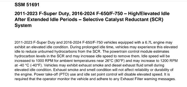

I'm a little surprised that the monitor shows an active regen since it's not really a full blown regen or intended to burn off soot in the DPF. The SSM below is what I think you are experiencing.
Hot snot, that sounds exactly like what it does. Where did you find that?
Thanks
The question comes up from time to time so I usually keep the screen shot handy. The SSM# has changed a couple times to include newer years, that was sourced from the NHTSA site.

Interesting still if it is this that if triggers the DPF Status “On” PID

Elevated high idle is normal, my 2018 does it all the time since dealer reflated it in 2022. After 45sec or so it goes to 1k rpms. It keeps the dpf from clogging up for long idle time

My 2017 will go into elevated idle (1000 rpms) after about a minute or so. That started after the emissions reflash recall done by the dealer. It did not do that before the reflash. I will check my ScanGuage ll next time to see if indicates a regen.
Feedback from a lot of the pre 2020 owners seems to indicate the reflash initiated this programming. I used to post in these threads that I had never experienced the elevated idle in my 2019, even after the reflash. Just recently however, while out of town in Tahoe, I did experience it. It kicked up after several minutes of idle time one morning.
My ‘23 does this now too. But I do love the efficiency of the ‘23-24 regen process. Mine kicks on at 500 miles or 55+% and burns to 0% in about 5 mins, no exaggeration. It is a much better system. Unnecessary, but better.
