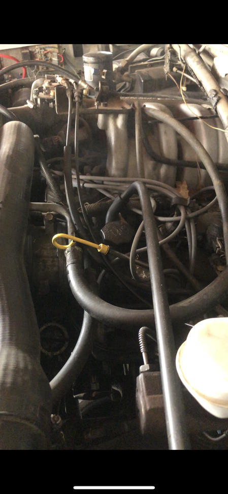

I did my oil change on my 302, I put 6qts in like I always have. The problem I have is that its reading at the minimum line. I checked the oil yesterday morning I moved it to level ground about 30 minutes before I checked it. It read at the minimum, so I added the rest of the oil I had which was about 1/4 of a quart. It read about 1/4 up the safe zone on the dipstick. I drove it 45 minutes, and checked it there on level ground about 1 1/2 hours later. It read at the minimum line. The biggest thing that added confusion to me is I've done two other oil changes to this truck, and both times 6qts got me to the top of the safe zone on the dipstick. I know for a fact I put 6qts in I read the bottles and I had one 5qt bottle and one 1qt bottle, and I put all of both of those in. The engine does have leaks, but those leaks don't leak fast enough to change the reading in the same day, I usually top it off every other week. Another thing I noticed if I move the truck, check the oil 10-30 minutes later ill top it off to just below the full mark. Then if it stays parked on level ground overnight and I check it the next morning, its above the full line by about 1/4 of the safe zone. If I install the dipstick like usual, it will read the minimum, if I install it upside down, it will read just above the minimum line. This is really weird to me and I'm not sure what could be the problem, I did drain the oil when the engine was at operating temp, and I have checked the oil with the engine cold sitting overnight, cold sitting for 30 minutes and after driving it. The readings don't change.
This is an old photo I have. Everyone said the dipstick was bent down, but its read right for the first two oil changes so im not sure how to fix this.
Wouldn't matter even if it was bent over 180 degrees. As long as it bottoms-out it should measure the same oil level.
Originally Posted by R&RFord
Is the dip stick tube secure?
My thoughts exactly!
To the OP: Is the dipstick tube fully seated?
nope thanks for the idea, can’t believe I didn’t think to check that.

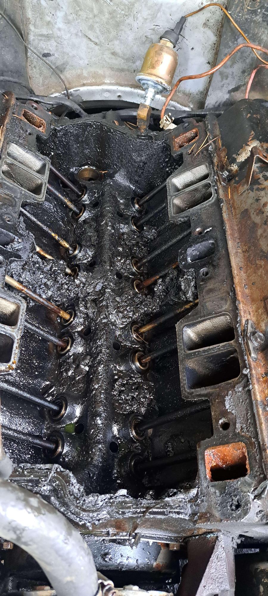

Originally Posted by yardbird
I did an older small block Chevy valve seals for a guy years ago. When I pulled the valve covers you could read th imprints of the valve covers in the built up crud. I went ahead and pulled the intake to see how bad the crud problem was.
The whole lifter valley was full to the point the bottom of the intake imprint was all I could see of the valley.
Seen similar in a 70's model 302. Guy said he would check his oil in the evenings and it was over a quart low, then in the morning be over full, Head drains were full of crud.
so much worse than this lol

Originally Posted by AuroraGirl
ttheres a chance you drained more from your oil pan this time than other times in the past. Ive found that cars surprisingly retains a few pints, maybe up to a quarts to two, in the pan depending on sludge, design, baffles, angle the truck is when jacked up (unless you crawl without jacking it up, I do that to my 4x2, unlesss your not on a level surface lol.
Possibly it was on a 4 post lift at my auto class when I did it. Usually I do it in the garage or in the yard. I’m sure my engine has sludge, it will read higher sitting overnight. I’ll be sticking to 3k, 6 months from now on to help clean it up. I’ll run 50 miles with atf in the oil before I change it next time. I’ve heard engine flush can screw with the bearings. And I’ll do that seafoam in the intake before the next oil change as well.
But I will fix the dipstick tube and the reading will be correct.

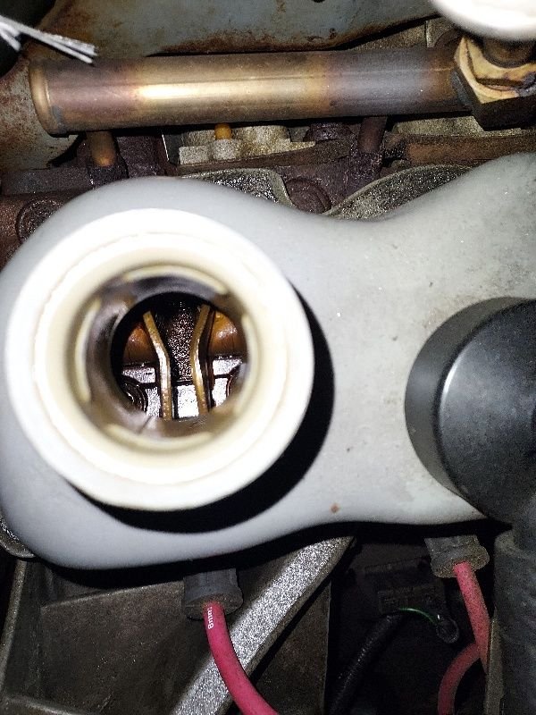

Inside my valve cover since using diesel oi. My truck had 76k on it when I bought it decades ago, and wasn't looking so clean inside. It now has 132k, and since I started diesel oil around 15 years ago, the inside looks much better.
