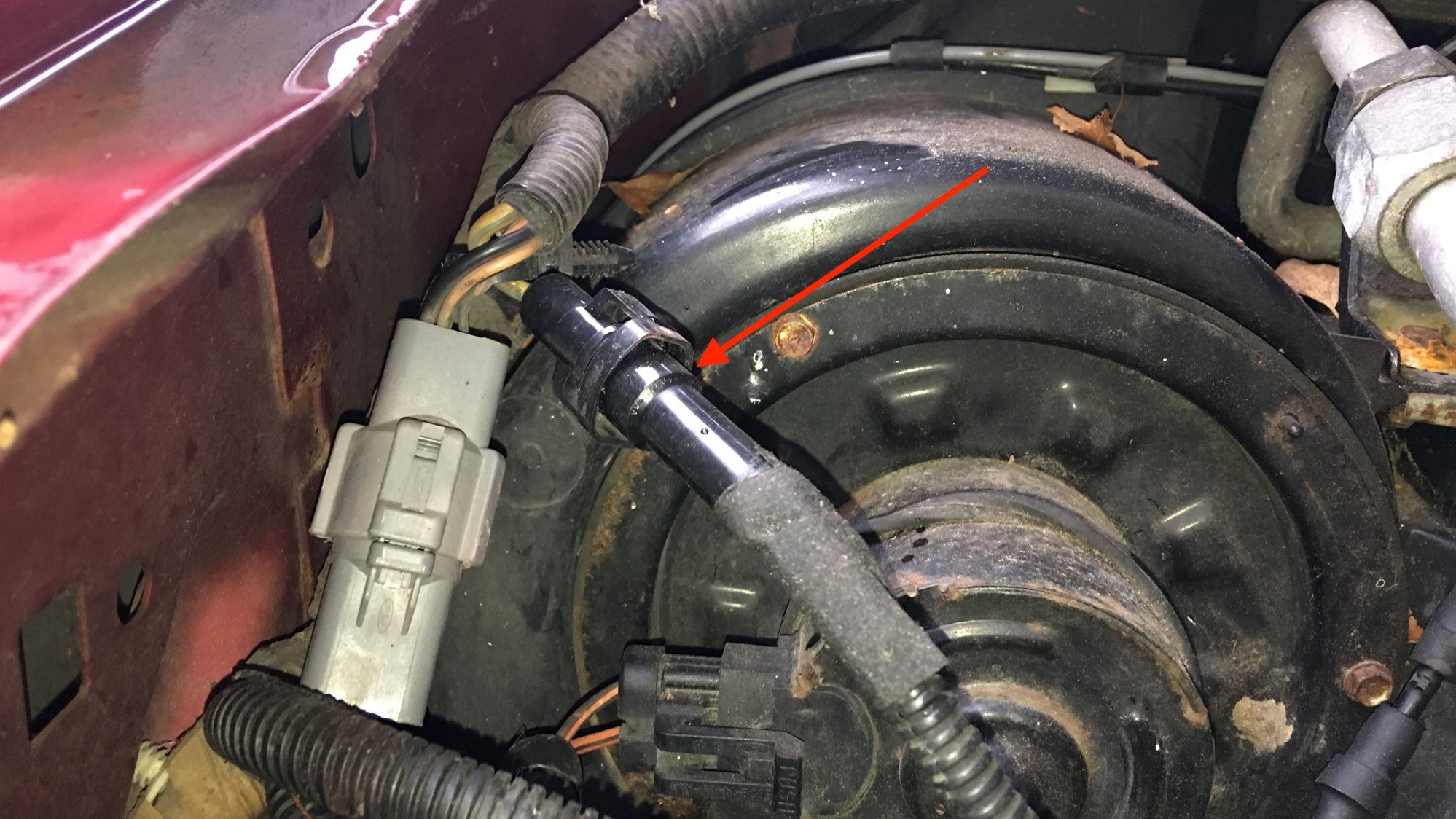

With low gas and a known passenger side leak (pictured), I experienced the engine shutting off after going up a slight grade. Hard start that morning with a cloud of white smoke. Degas bottle has been clean and radiator hose is appropriately firm yet pliable.
At this point, no crank/turnover at all and power steering locked. All lights and electronics work. Injectors buzz for several seconds when ON.
What are we thinking?

First, if you've got gas in the truck, you've got a problem.
If you mean low fuel, you could have an in-tank problem with the fuel pick-up foot deteriorated.
Hard start, white smoke, no engine cranking over - you could have a hydrolocked cylinder from a bad injector. Do you at least hear the starter trying to engage? Tied jumping the starter from the pass inner fender connection?
You will need Forscan with an OBD adapter, good mechanical skills, and deep pockets.

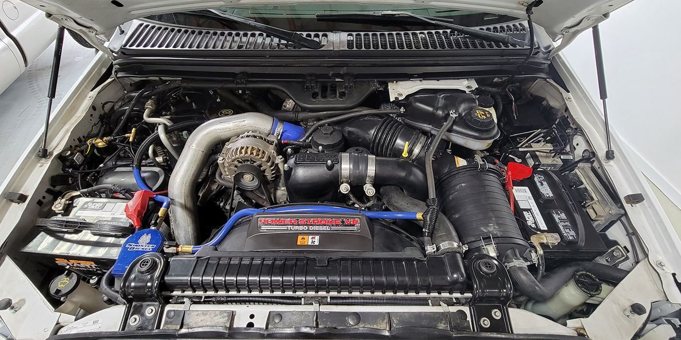

Your profile states you have a 2003 model year Excursion.
Is that true?
Original owner or bought used?

So, 24 hours after the initial post and OP hasn't logged back in.
So, I'll just throw out a general question .............. (and the reasons for my earlier questions)
Anyone see anything in the pic of the top of the engine that the OP posted that makes you wonder about it being an '03 model year?
Also, I agree that the unplugged PCM connector to the transmission does look odd!
Anyone see anything in the pic of the top of the engine that makes you wonder about it being an '03 model year?
Also, I agree that the unplugged connector to the transmission looks odd!
Oil Dipstick?
Old Feb 6, 2024 | 09:39 PM
bismic's Avatar
bismic
Joined: Nov 2003
Posts: 27,918
Likes: 3,636
That is one (but it can be changed easily).

Well I'm stumped. So what do you see that leads you to believe it's a later year?

I love a “where’s Waldo”. Don’t tell us yet!

I've got a yellow dipstick due to my 20mm heads.
The ABS controller is for a later model year, '05+.
We're probably getting scammed.

ABS Module is the big one. Don't forget the Power Steering fluid reservoir location also!
So yellow dipstick on a 2006 would indicate 20mm heads? Also what's the main difference(s) between 18mm heads and 20mm? More power/better towing or something like that?
Old Feb 7, 2024 | 07:30 AM
bismic's Avatar
bismic
Joined: Nov 2003
Posts: 27,918
Likes: 3,636
The yellow round-handled dipstick was supposedly one addition that came with the commonized heads, but it was not a 100% sure identification. SOME "non-commonized head" engines showed up with it as well, so not the best to assume commonization by only identifying that. Core plug size and carrier boss bolts are the only sure way at identifying commonized heads from an external view.
The 18mm and the 20mm only refer to the guide dowel size. I posted the literature on the changes for commonization over on the Org a week ago or so. Posted below also.
I should have disqualified Jack in the "Where's Waldo" game, lol! Just to maybe get it to "go on" a bit longer.

The switched location of the ABS module and Power Steering reservoir is the hard test. Done in 2005.

Black plastic CAC tube is my contribution - but I admit I saw that on the first post, before the "game" began...
