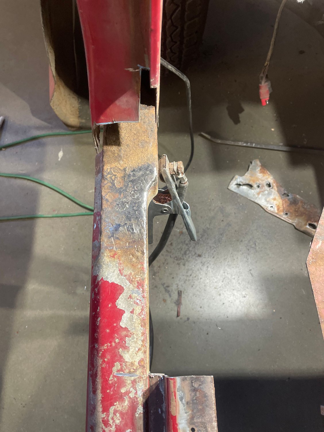

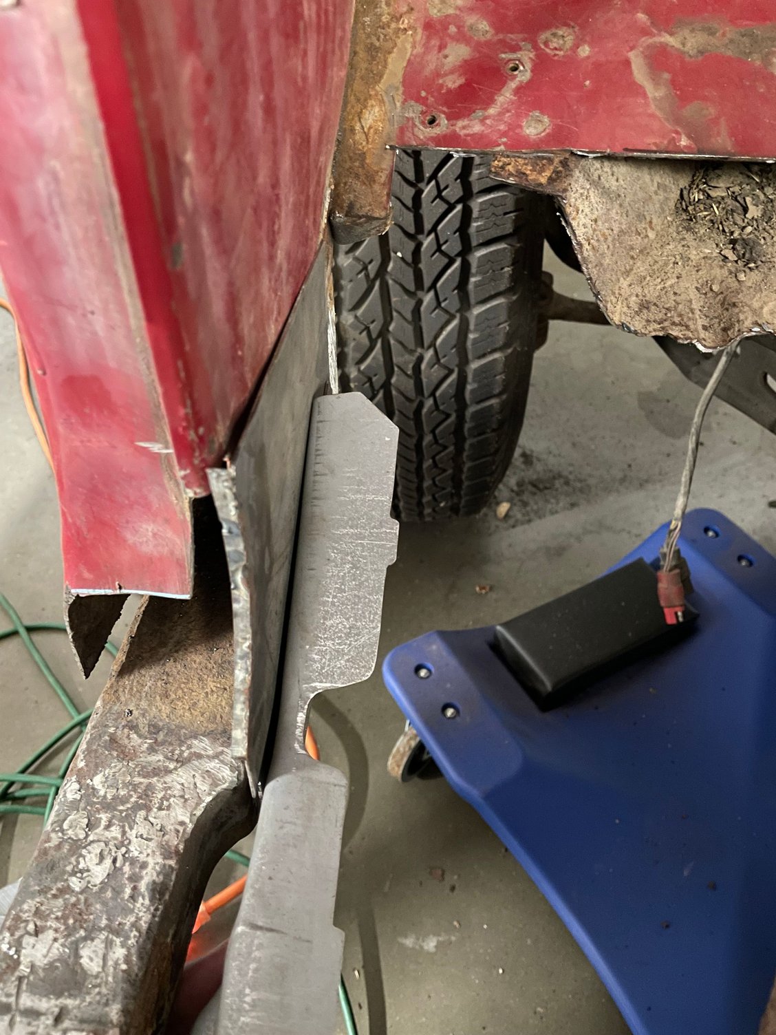

So I have a couple of questions about seam sealer, where to apply it, how to apply and welding with it. My first question is about applying the seam sealer in between all the layers of metal that come together at the inner rocker, rocker and the kick plate. Do I put seam sealer in between every piece of metal, because that's what it looked like to me as I took these pieces apart. It looked like the factory put seam sealer in there but nothing else, no primer no paint, nothing. My next question........ Do I put primer on first the seam sealer, then weld it up. Can I even weld through the seam sealer? I guess what I'm really asking for is an order of operations for putting these pieces back together, regarding the correct way to prep the metal for welding and then primer to seal it all up so its good until I can fix the rest of the issues and get it to paint. Can anyone shed some light on this for me? And yes I realize nothing is lined up, everything still needs to be cut and final fitment I just wanted some pics to help everyone see what I'm looking at.
