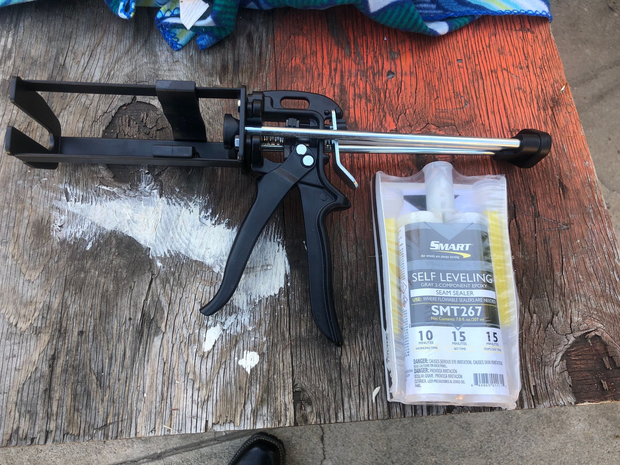

The factory has robots that flow this stuff on. To make it look factory you need this special gun and "self leveling" seam sealer. You flow it on like a caulk gun. It dry's real fast! Take your time and get right. It mixes like JB weld. I used two of these because I did both side of the Ex. They make a brush on type also that could used.

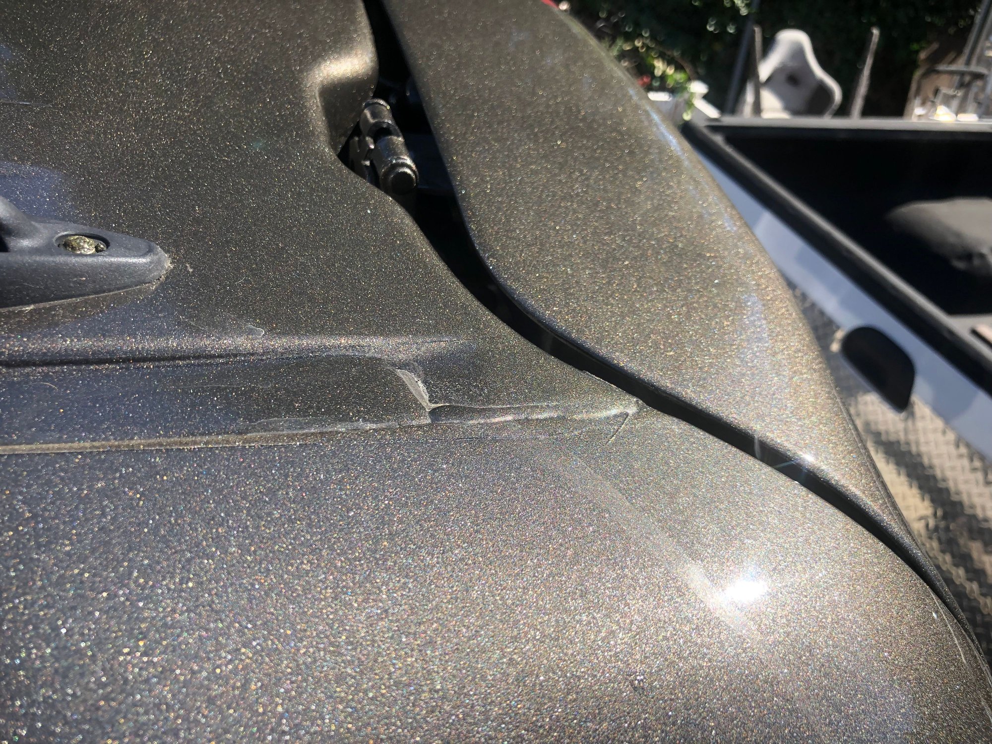

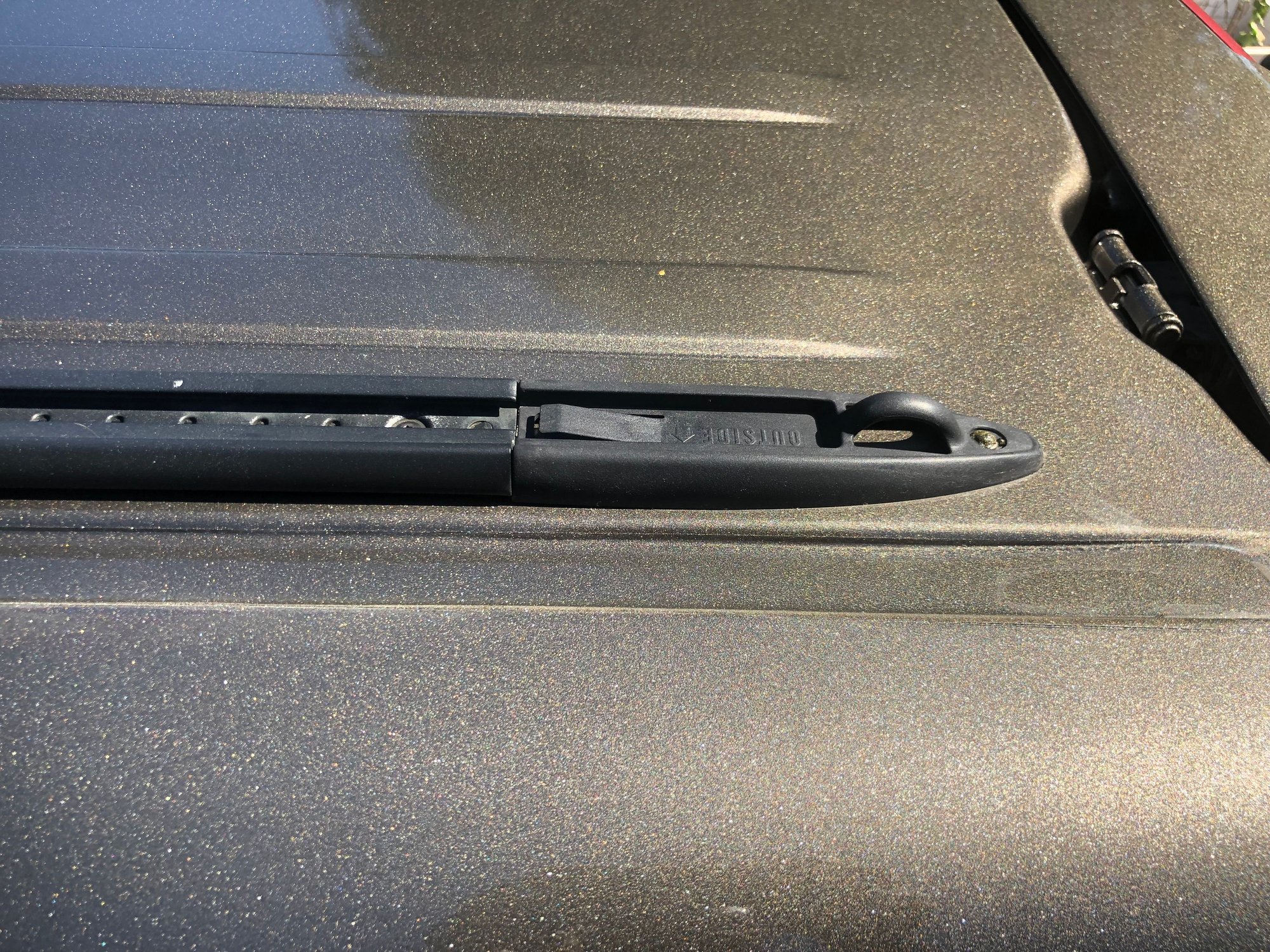

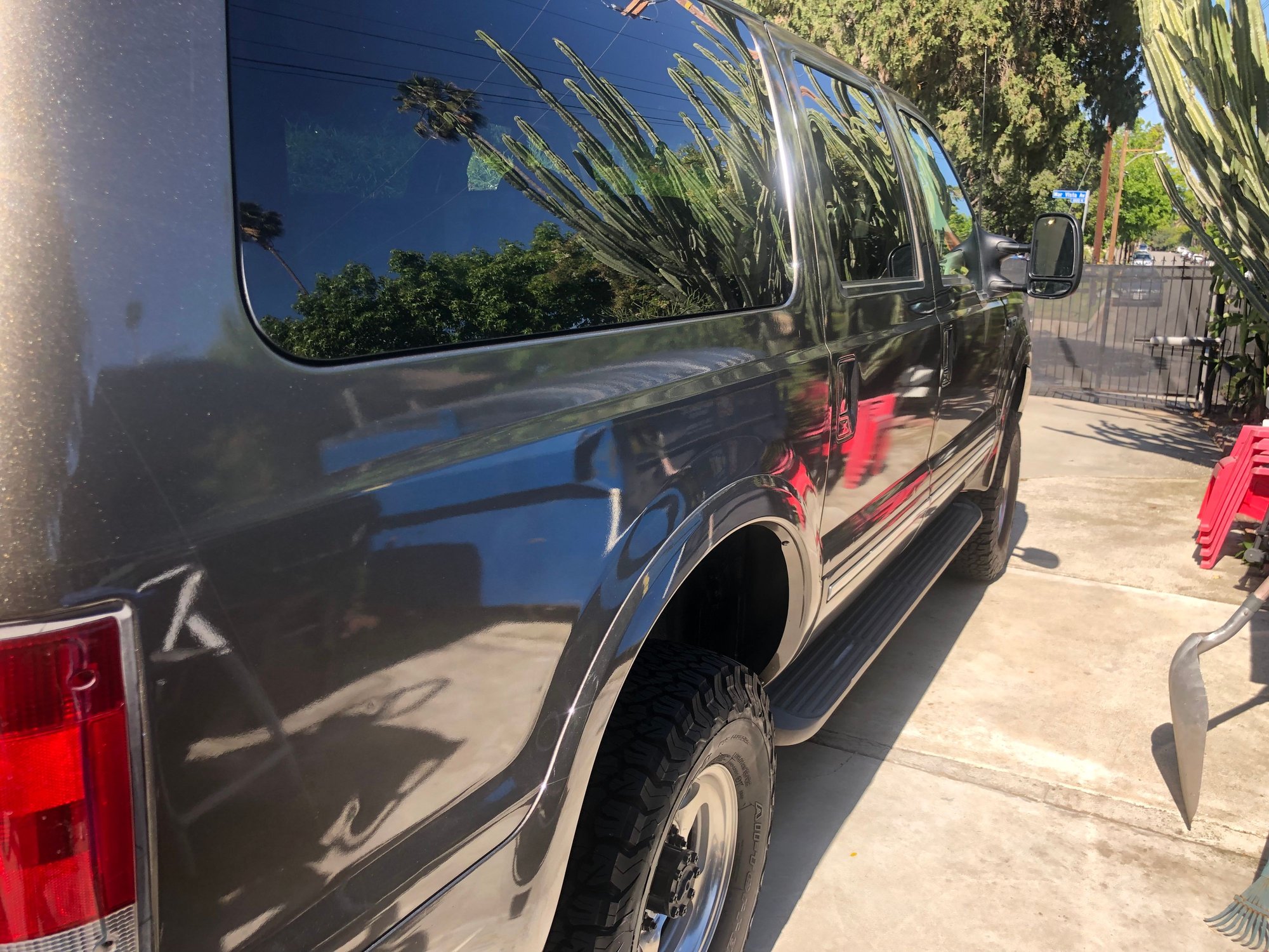

The finished product after painting.
For some reason at the very end of the channel Ford left the seam exposed. I flowed a little sealer in. I heard that Explorers have a problem with leaks in the same area.
Before

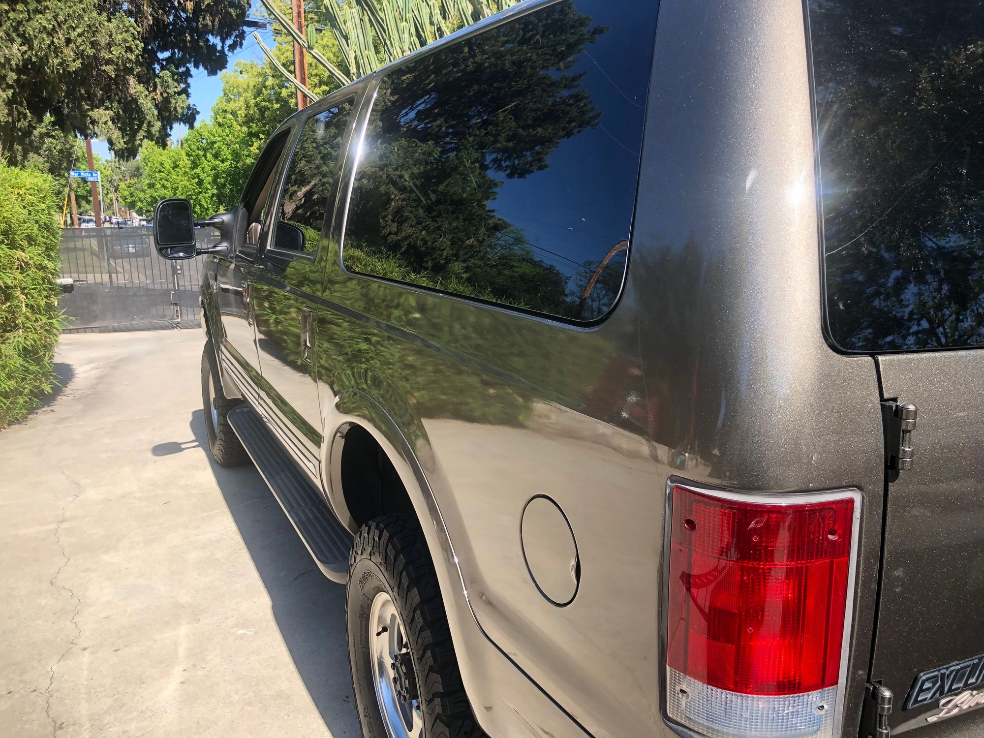

After. Maaco's interpretation of Mineral Gray. Color code TK
I didn't opt for Color Sand and Buff, I'll let the patina develope naturally.
Lots more metallic than Factory.
The clear laid down pretty good.

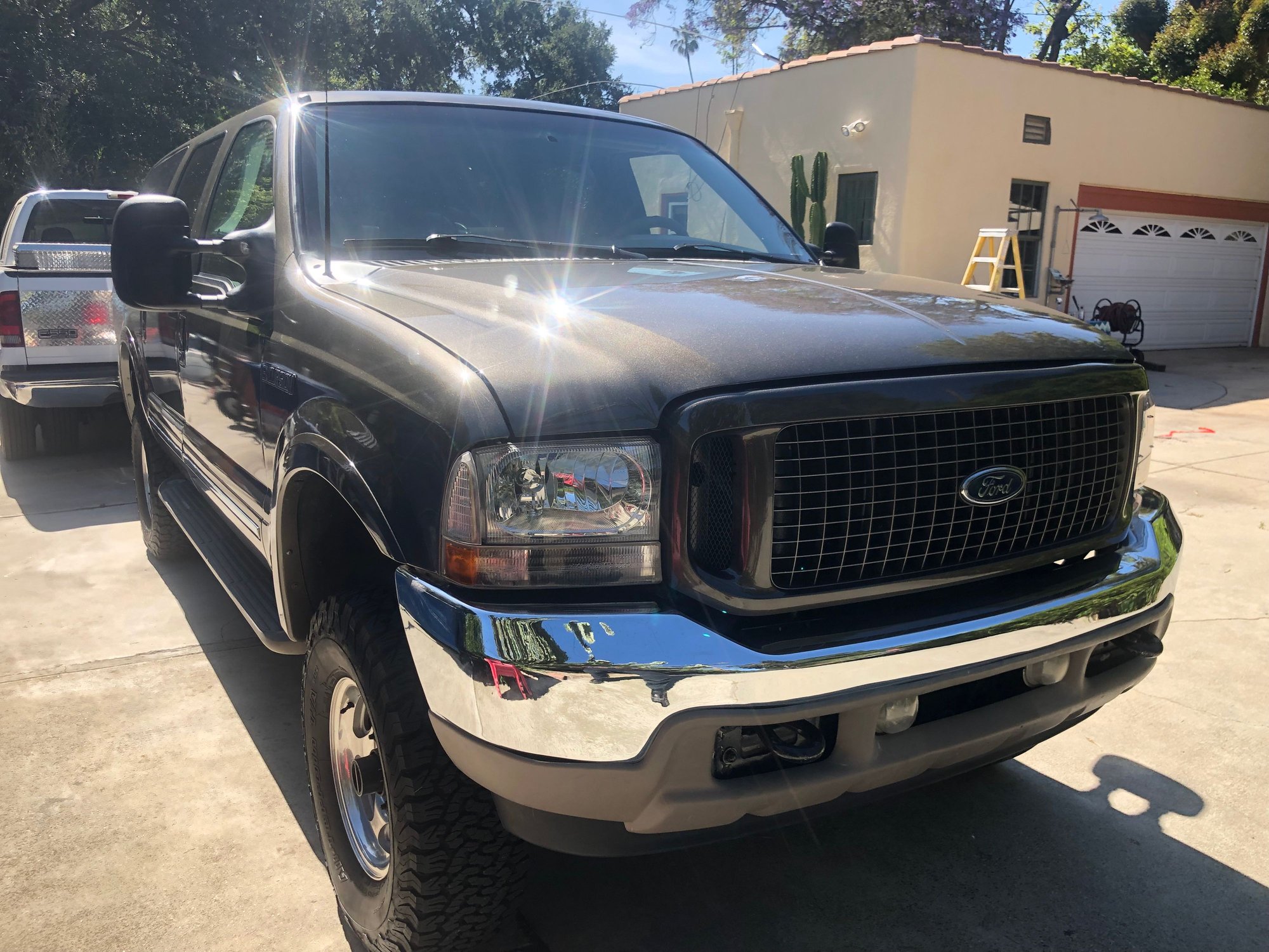

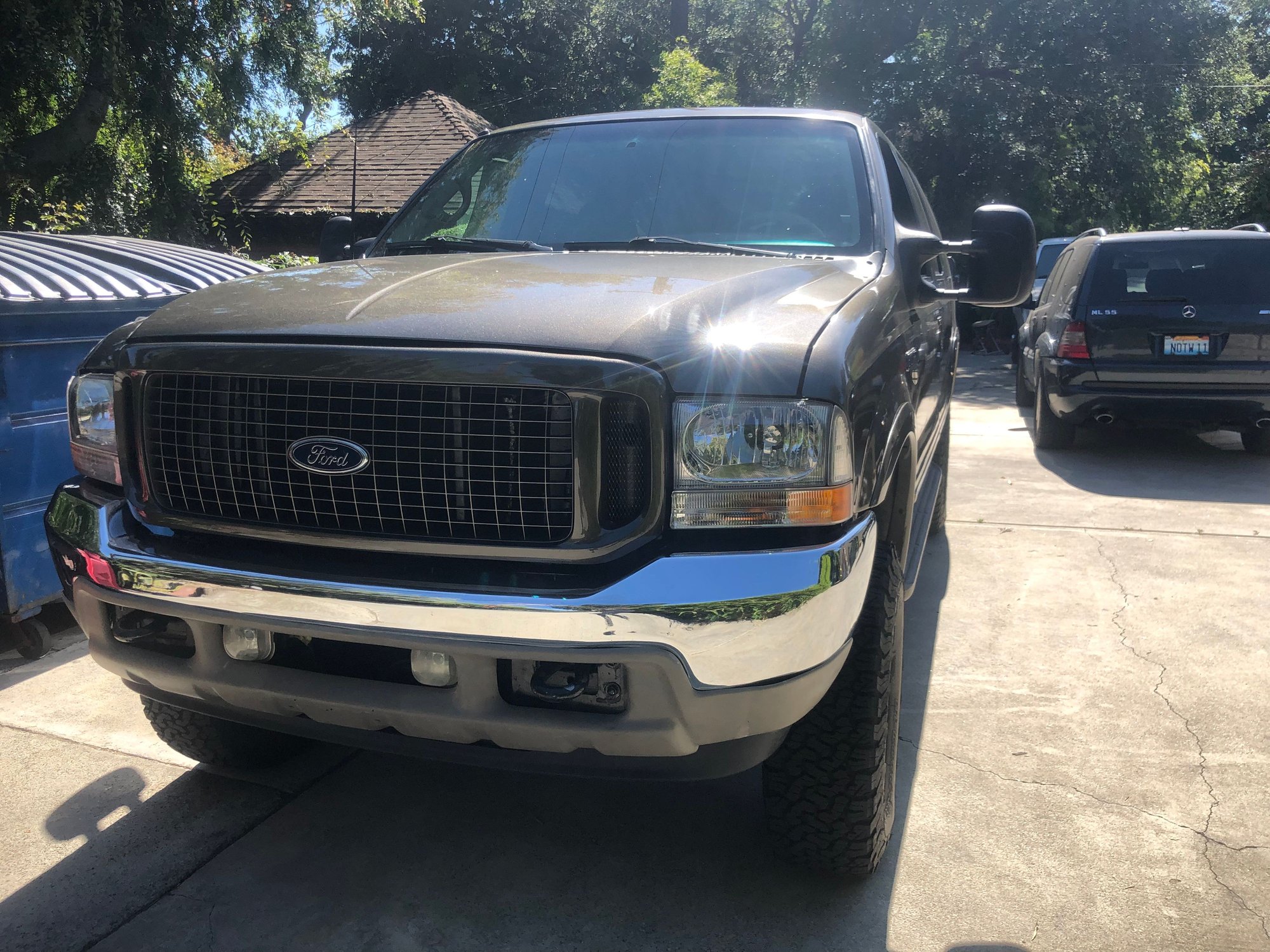

I was planning to change the grill, but I think it looks good now after paintting.
