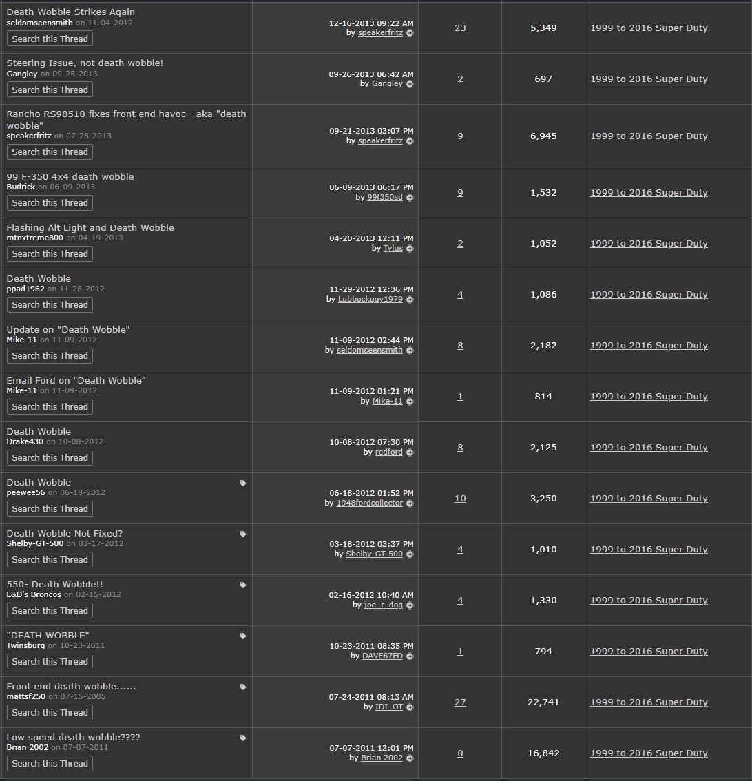

And those are just the threads in the 1999-2016 Super Duty sub-forum where the words "Death Wobble" happened to be in the title.
There are many more threads regarding death wobble, such as this very thread now, where even though death wobble is being discussed, there is no mention of "Death Wobble" in the title.
These types of threads were not presented above, because the search was restricted to only thread titles with death wobble, and further restricted to only check the 1999-2016 sub-forum.

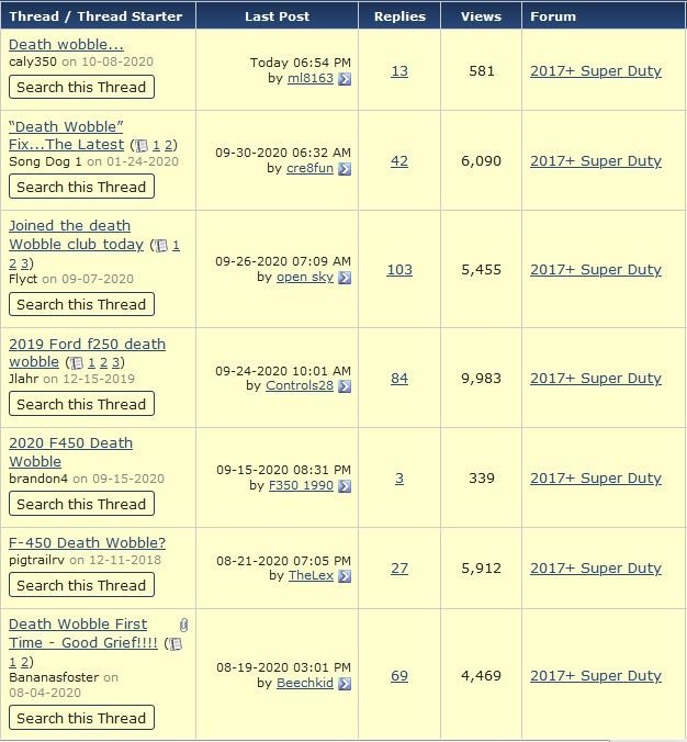

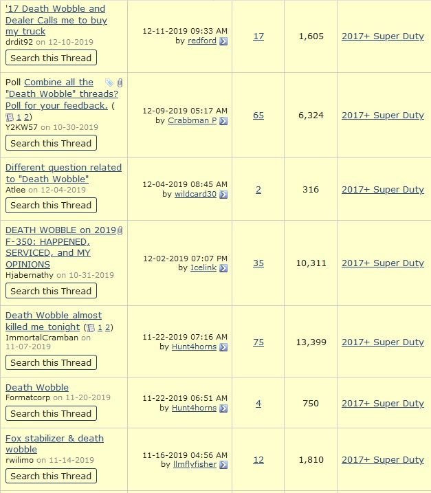

Several years ago, a similarly restricted titles only search was done in the 2017+ Super Duty Forum, which revealed the following:
The yellow box results from the 2017+ Supper Duty sub-forum were derived in 2020. In the four years since, there have been just as many more threads and posts about death wobble. Those latest results, not presented here, can be readily found by entering the term "Death Wobble" in the search box above. By clicking down on the "Threads" sub-menu, an "Advanced" search tab enables anyone to tune any search to specific times and sub-forums.
