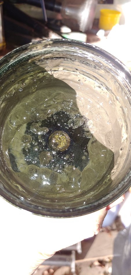

Just emptied my catch can yesterday... It was just shy of 500 miles since last drain...
This doesn't smell like fuel at all. It smells burnt and Smokey... Kind of a unique smell to it, like some of the combustion chamber gases i would think smell like... I'm sure there's a little amount of fuel in there but that's what the soot is; the byproducts of incomplete combustion plus I'm thinking that's what the inside of a hot compression engine would smell like since it's coming from the driver's side valve cover.
With the flash... About 65 ml of water...
The water soaked oil left after dumping the water out.
After I wiped the can out with paper towels, the Smokey burnt smell was emanating from the garbage can. It's a real strong smell with no smell of fuel at all.
Personally I think your slightly elevated fuel dilution is from all the stop and go local driving you do...
If that filtered clogged, you'll possibly cause excessive pressure on the crank case possibly causing the infamous upper oil pan leak. So I'd change that filter sooner than later... You could do a sealed CCV box... W a catch can. You could extend the Mishimoto hoses like I did and have the can sitting on a piece of 2x6 on top of the driver's side fuse box.

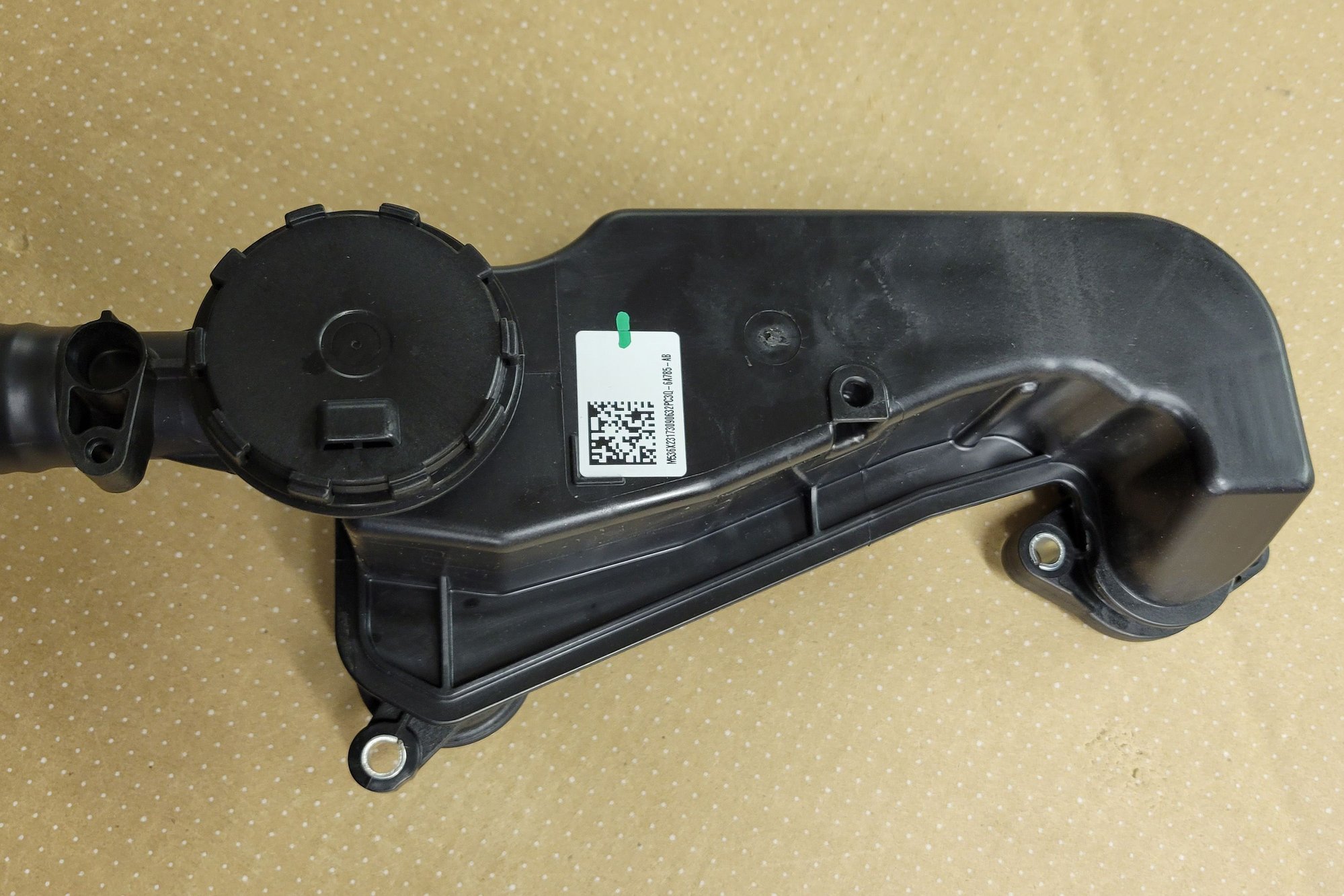

You could switch out to one of the new design 2023 CCV boxes that don't have the failure prone filter media...
2023 OEM Part
