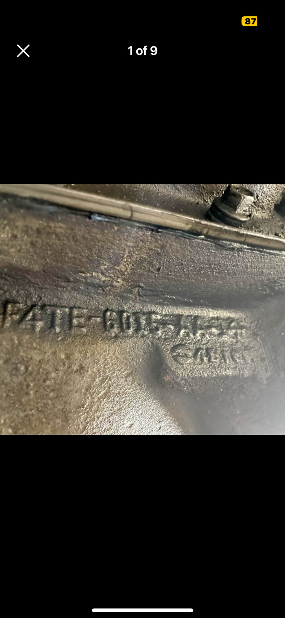

Well I actually just found a 351 roller block in town for 500. Would the 5.0 harness still work or will I need a new one?
harness will work as long as it has the same style distributor. I think 93 and prior used a different distributor. So if it is not the same distributor just get a 94 distributor for a 351. And then you will need a MANUAL transmission 1994 or 95 computer for the 351w.
The manual tranmission engines stayed speed density until 97 unless they were Cali emissions.
On the plus side, Richard Holdener found out that a stock bottom end 351w will hold over 1200hp when tuned correctly lol.

The 5.0L harness will plug into the 5.8L and you should be able to run it on the current PCM.

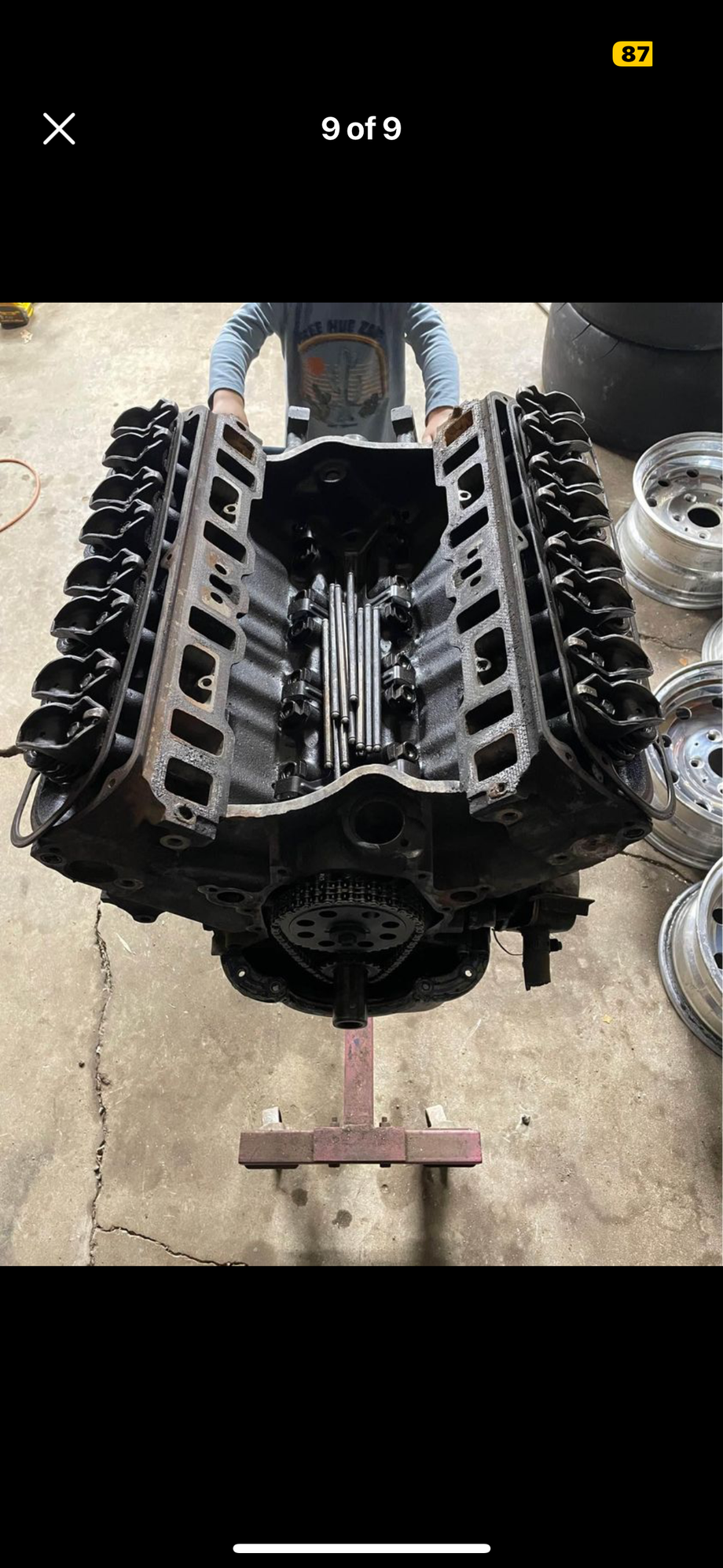

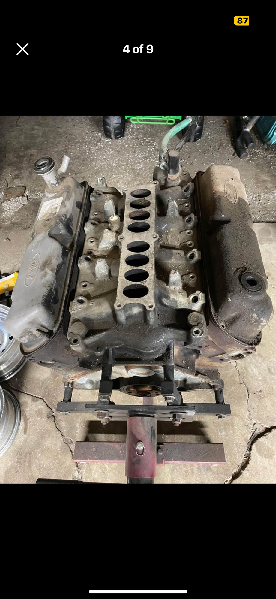

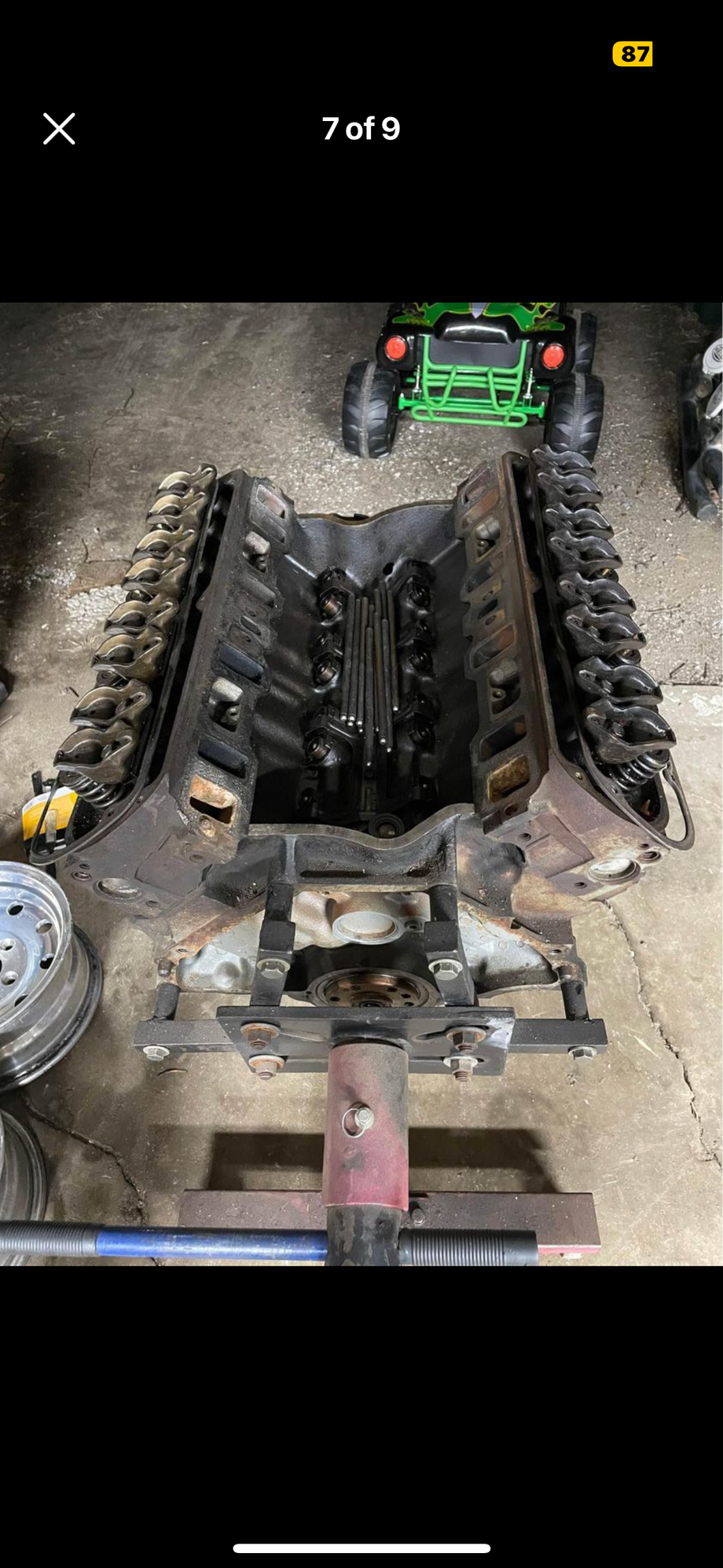

This is the motor I'm looking at

Roller block. That’s the good one. Price seems steep for a long block. I paid that much for a complete engine a couple years ago.
