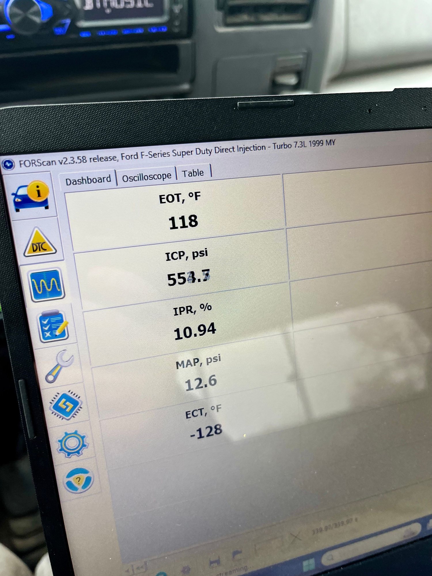

Perhaps spotting or narrowing down the EOT at which it goes from slug to normal speed would help. That would also give you just one parameter to watch since we could chart the data log and base the slug to normal change off that one data point.
Let us say that you observed at 141° EOT the truck goes to normal. Once the data log is charted, we could find the 141° EOT measurement and mark the chart at that point in time and attempt to find anything else out of the ordinary prior to that point. Also, if you notice this slug to normal change around the 140° EOT mark a couple of times in a row, that would likely narrow down your key PID.
Next would be to ensure all of the PID's and sensors are reporting to the PCM as they are designed to do. I recently saw this with a CPS that was intermittently reporting and I could not see it with my own eyes and live while cranking the truck or waiting for it to stall while it idled for an undetermined amount of time.

Alright fellas, I’m not good with computer stuff so I didn’t get a good screenshot haha.
EOT was/is spot on as the engine goes from cold to operating temp. What I did notice was the ECT started out at -150*F and stayed in the negatives for quite awhile. Normal or is my sensor suspect? Wonder if that would limit fuel when it’s negative degrees?
ECT doesn't actually go to the PCM on auto transmission trucks before 01 I think. I'm not sure if it's the PCM or the scan software or what but they all still report a phantom reading that usually starts out ridiculously low and ends up scarry high.
I can confirm the ECT is a phantom reading on my 2001 auto. The PID is in the PCM choices on the edge monitor, but it has no real readings.
I can never remember the details of which trucks actually had this going to the PCM but I’m thinking it was 02-up manual trucks.
@Sous knows.
@Sous knows.
Jason got it right. ZF6 manual trucks of the later years are the only ones that report ECT accurately to the PCM. For example, my 2000 ZF6 is a phantom reading as well.
Thanks for the confirmation. And it looks like I may have got that “phantom” description to stick.
