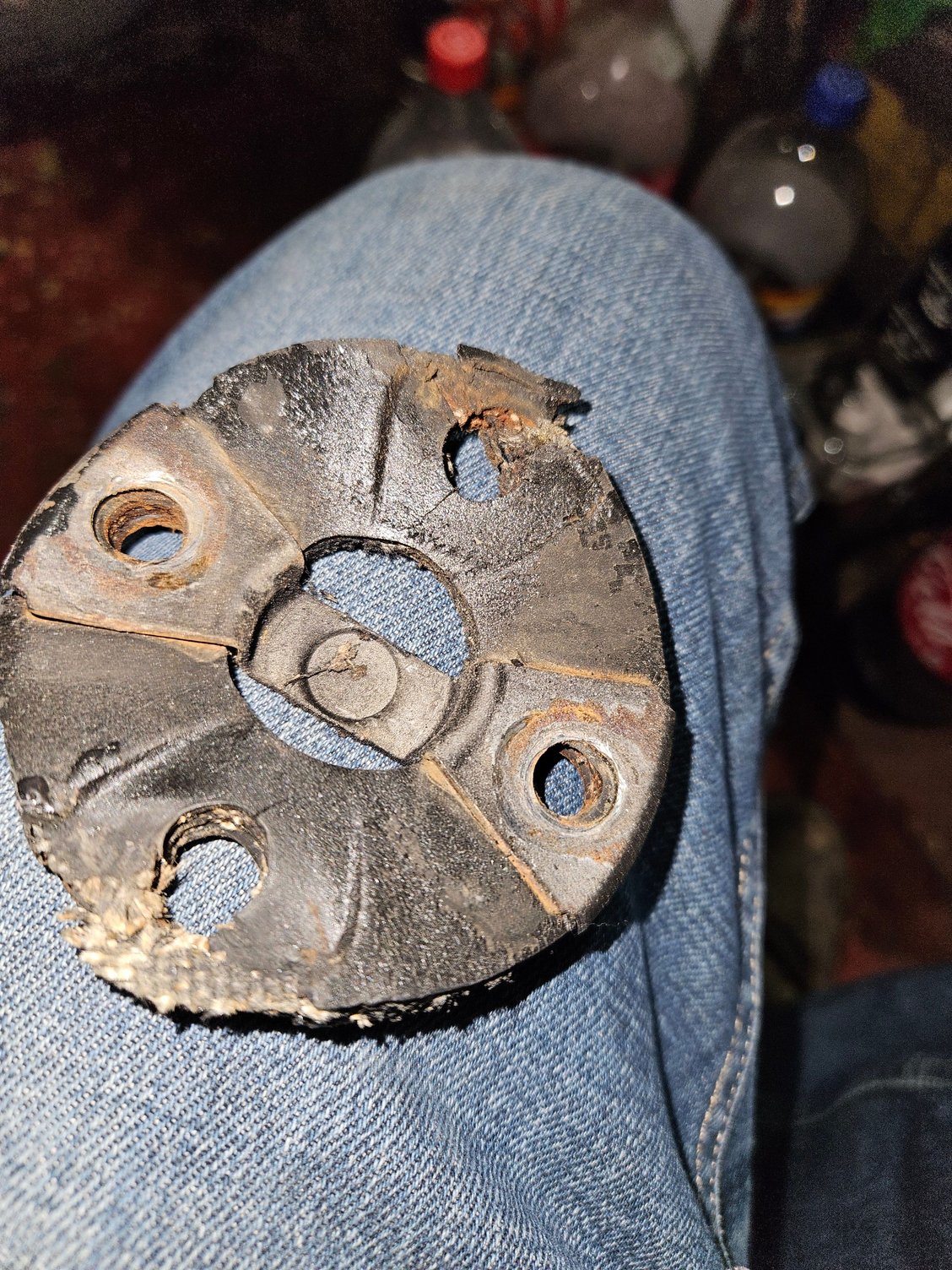

Uhh ooooh
1977 F150 4x4
4 inch suspension lift
3 inch body lift
I noticed that the geometry changed after I changed new radius arm bushings and was going to visit this issue but while changing the steering wheel out this happened....can anybody help me with a resolution

Just get a new rag joint.
Not a hard "fix", likely even You tube videos on the subject.

X2 get a new rubber "rag joint" or flex joint. Great time to change over to a Borgeson steering shaft and never worry again.
https://www.borgeson.com/70-79-Full-...ord-Truck.html

Normally, I like a rag joint for its vibration isolation up to the steering wheel. But a rag joint is not a good match for the 3 inch body lift.
Not surprising yours tore off.

By the way, is your truck set up with the rag joint down on the box, or up at the junction of the steering column? Looks clean enough to be up above.
Usually when they’re down on the box, like Ford did with many designs, by this time, they’re all oily and deteriorated.
