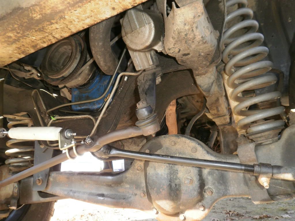

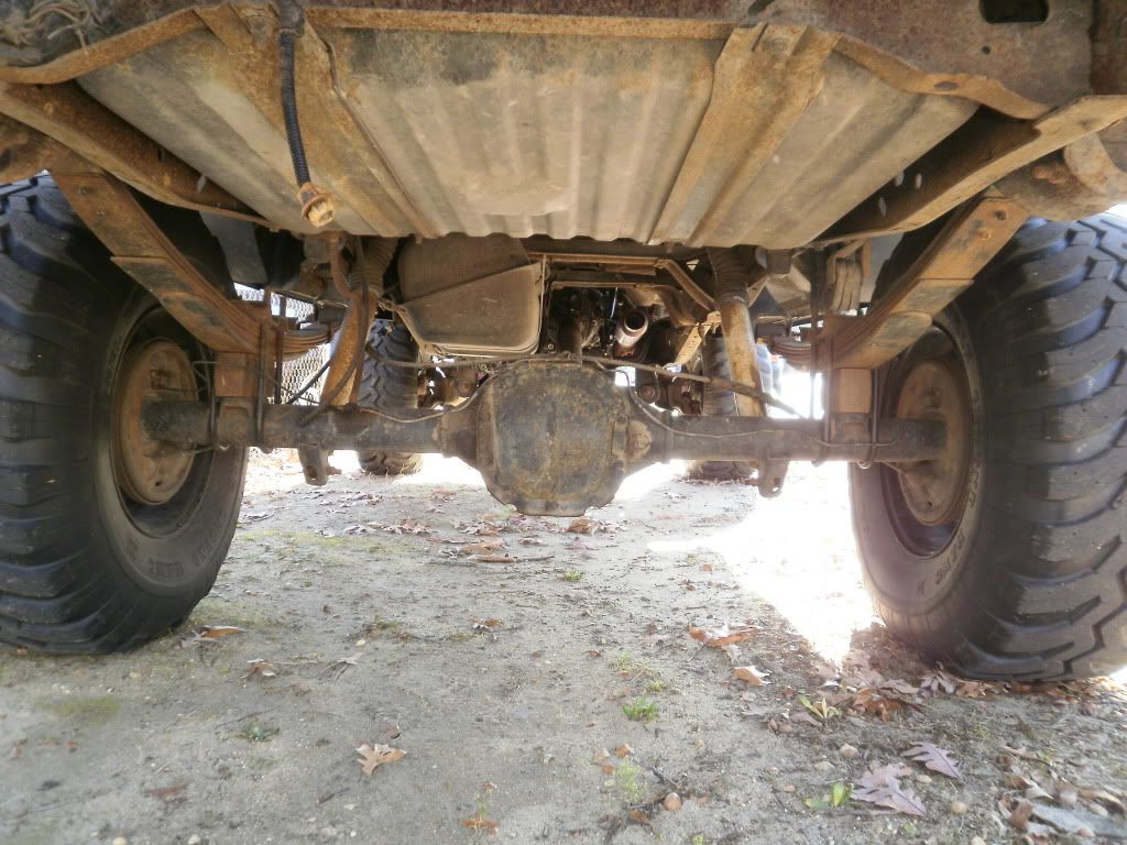

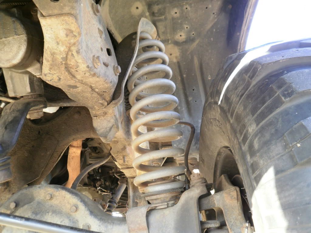

well im trying to fgind out what is needed first, not necessarily asking what i have to do to fix what i have, bu i will take pics so u can tell me what they did wrong

need more pics lemme know, im trying to get as much information about what i have as i can, also if u can tell me what kinda front n rear i got thatd be good to know,

Aren't you the guy who replaced your oil pan gasket without pulling the engine and then didn't get the oil pump driveshaf tlined up? How did you end up fixing that? Any leaks?
First thing that sticks out like a sore thumb is that steel line tied together with compression fitting. Please tell me that's not a brake line. If it is, replace the line or join them with a double flare. Accident waiting to happen if that's a brake line.
You have a drop pitaman arm and drop brackets for the axle pivots, so geometry shouldn't be terribly bad. Steering angle looks a bit steep, but not obscenely so. A more level ddrag link would help though.
Rear blocks aren't stacked so it's not terrible, but I'd recommend doing a shackle flip and ditching the blocks or getting shorter blocks. Axle wrap will bite you. Your front is a D44 TTB and the rear is an 8.8".
Have you checked your tie rod ends, ball joints, and wheel bearings for slop? How about steering box and rag joint (rag joint is under the plastic cover at input side of steering box). Try turning the wheel while looking at your tire. The tire should move instantly with the slightest move of the wheel. To check tie rods have a helper turn the wheel slightly back and forth and feel each tie rod end. You will feel slop and movement if they are loose. Alternative jack up the front and grab tire at each side, try turning it and feel for any slop and watch the tie rod ends while you do. To check ball joints grab top and bottom and shake it that way, any movement is likely bad ball joints and can be verified by looking at or feeling the joints while doing this to confirm movement. Any movement in either direction that you can't tie to ball joints or tie rods in wheel bearings.

Also it looks like you're running bias tires, maybe 38" Ground Hawgs? If they are in fact bias and that large... You're never gonna have it drive straight and perfect and not follow grooves in teh road or pull on uneven pavement. That's just how bias ply tires are.
Also, disregard what I said about compressioj fitting on that brake line... Looks like a trans cooler line. Didn't know people still ran slushboxes in woods trucks.

You have pretty much covered it. It looks like either the steering box was cleaned up or it is a replacement.
One thing I will say is this generation of Ford truck steer awful at best just stock. Then add wide tires, a lift kit.
I have an 86 F250 4x4 460. It has a new steering box, new shocks, new tie rod ends, new ball joints etc, when I hook our TT to it the steering is not what I call real firm. What I had to do was find a Ford front end guy that knew these trucks & get him to set up the alignment to get it to steer correct.
That is my recommendation. Is get it into a guy that knows these trucks & let him align it. With the I-Beam 4x4 they are a breed of there own.
