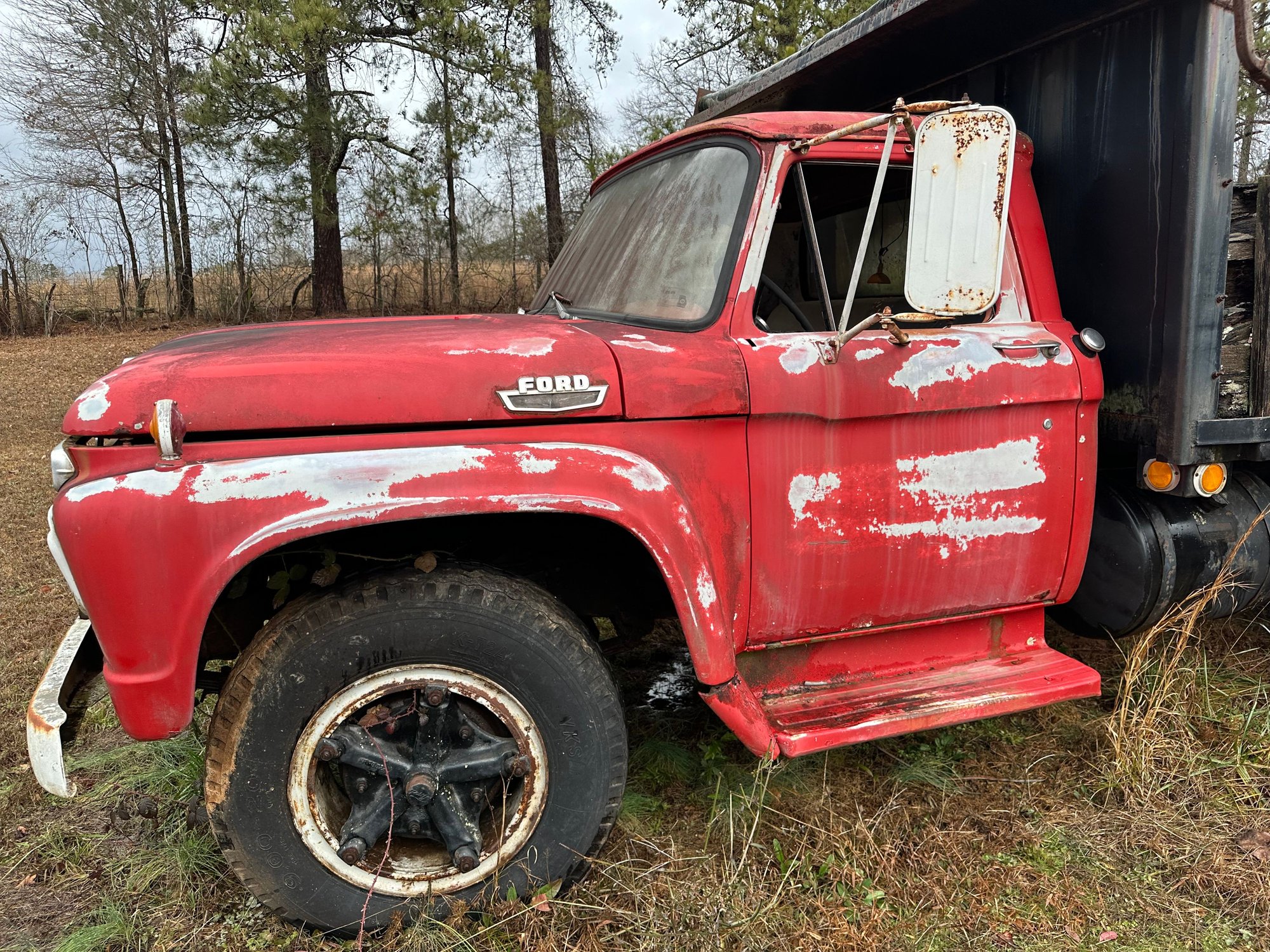

What kind of wheels are on it? As OEM if it had Budd type wheels they were widow makers.

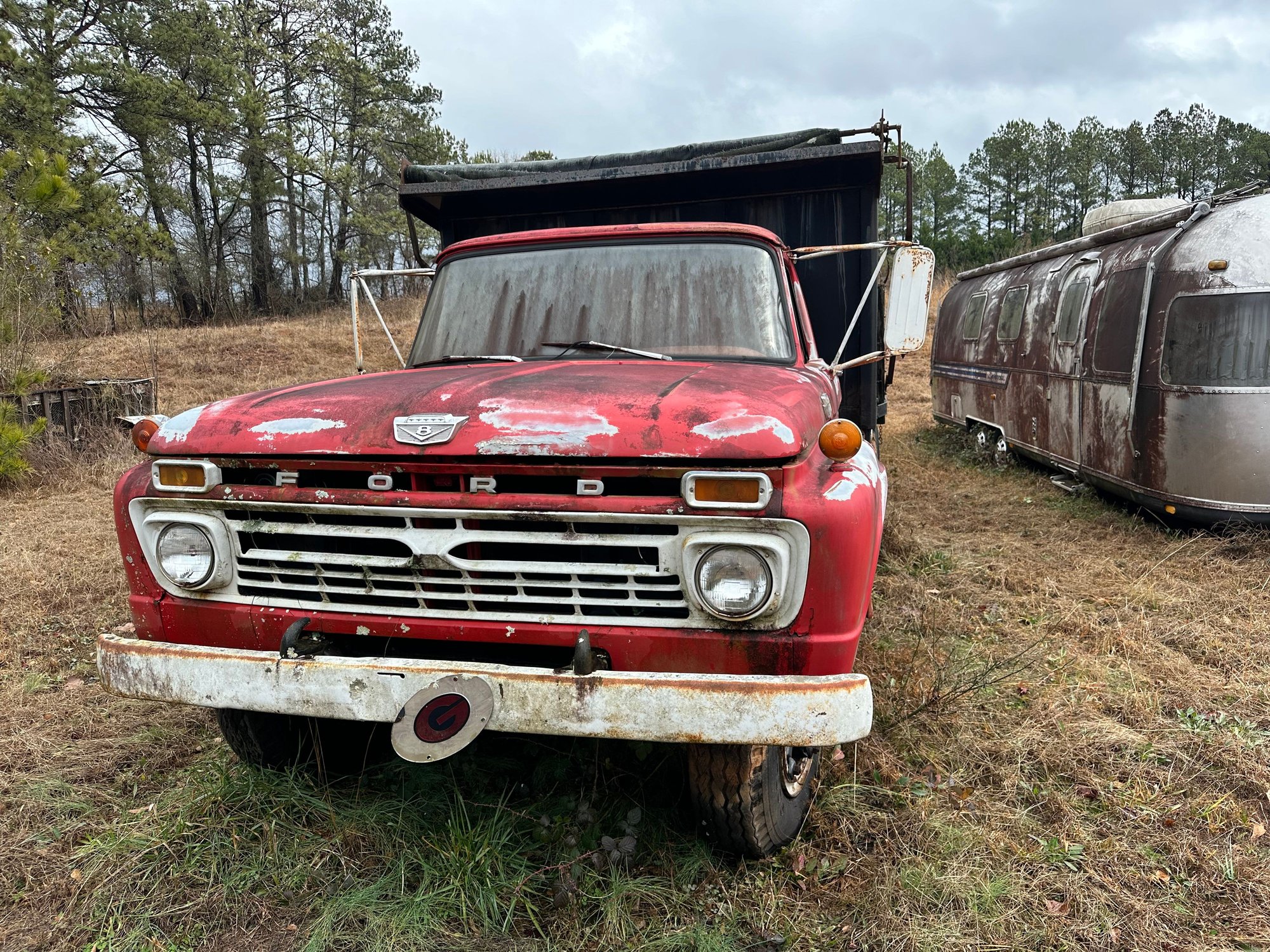

Post up some pics. How does it run?

F601 is one of 10 models of the F600 for that model year.
A model of a model.
Forget F601 unless someone asks specifically. For parts you need the specific engine, trans, axle and gvwr, and axle capacities listed above.
Once you pull your brakes apart, the width and diameter of the brakes is another set of numbers to jot down.
You have Dayton or Dayton style wheels with split locking rings. Those are safe and serviceable, although you'll have to find a shop that will work on them.
You can find 22.5" tubeless rims for those if you want to go that way, depending on the condition of what you have and what you want to do.
