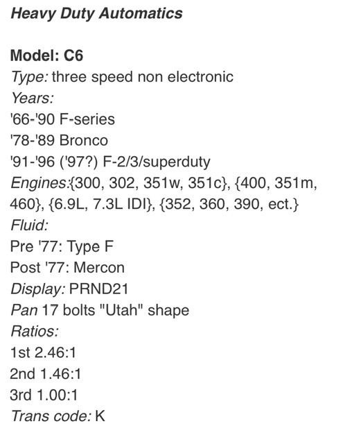

Trans Code K is a non-overdrive 3 speed C6.
Cut from my 1988 Ford Service Manual:
I also have a 1988 F250 4x4 with 7.3 diesel and an E4d0 , it is a special heavy duty truck. when I was doing brakes I had to order rotors and pads for 97 super Duty 4x4. I have all the original paper work for the truck, all I can figure is it was a special order truck. One owner, I am second owner of the truck. I am completely redoing the 88 4x4, it has a Ford Motor company replacement engine. It also has K code with an overdrive transmission..,
