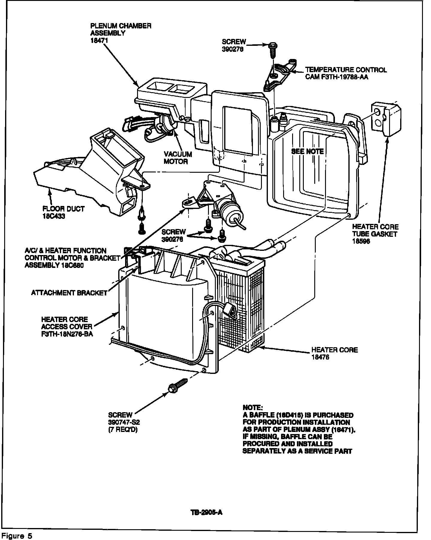

5.Examine the adjustment clip for damage during removal. If one or both tabs are broken or no longer spread away from the body of the clip, replace the clip (F1TZ-14A163-D). If the entire cable must be removed from the vehicle, proceed as follows:

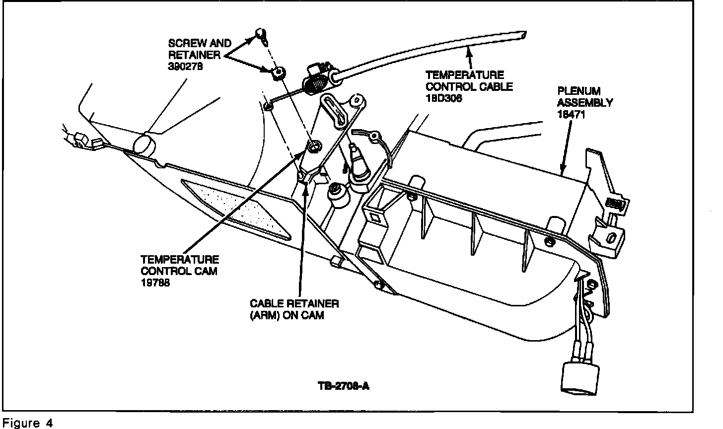

6.Disengage the cable wire from the temperature door cam pin, Figure 4.
7.Refer to the Service Manual to remove the A/C-Heater Control Assembly. Disengage the cable connector and wire from the control assembly.
8.If the temperature door control cam is being replaced, it should be removed at this time, Figure 5.
9.If the heater core access cover is being replaced, it should be removed at this time, Figure 5.
INSTALLATION
1.Attach the new temperature door control cam (F3TZ-19788-A) if it is being replaced.
CAUTION:
DO NOT OVER-TIGHTEN.
Minimum torque is 0.7 N-m and maximum is 1.7 N-m. Check for binding or too much movement effort and adjust if necessary.
2.Install the heater core access cover (F3TZ-18B299-A) if it is being replaced.
3.Install the A/C-Heater Control Assembly (F2TZ-19980-A) if it is being replaced. Refer to the Service Manual for the procedure.
4.On the adjustment clip at the cable end, move the barrel so that the red insert is on "center" and the red does not show from either end. Further adjustment is not normally required, but can be made after installation, if necessary.
5.Attach the cable to the control assembly if not already attached in Step 3. Attach the wire coil end to the temperature control cam. Be sure cable is under cable retainer as shown in Figure 4.
