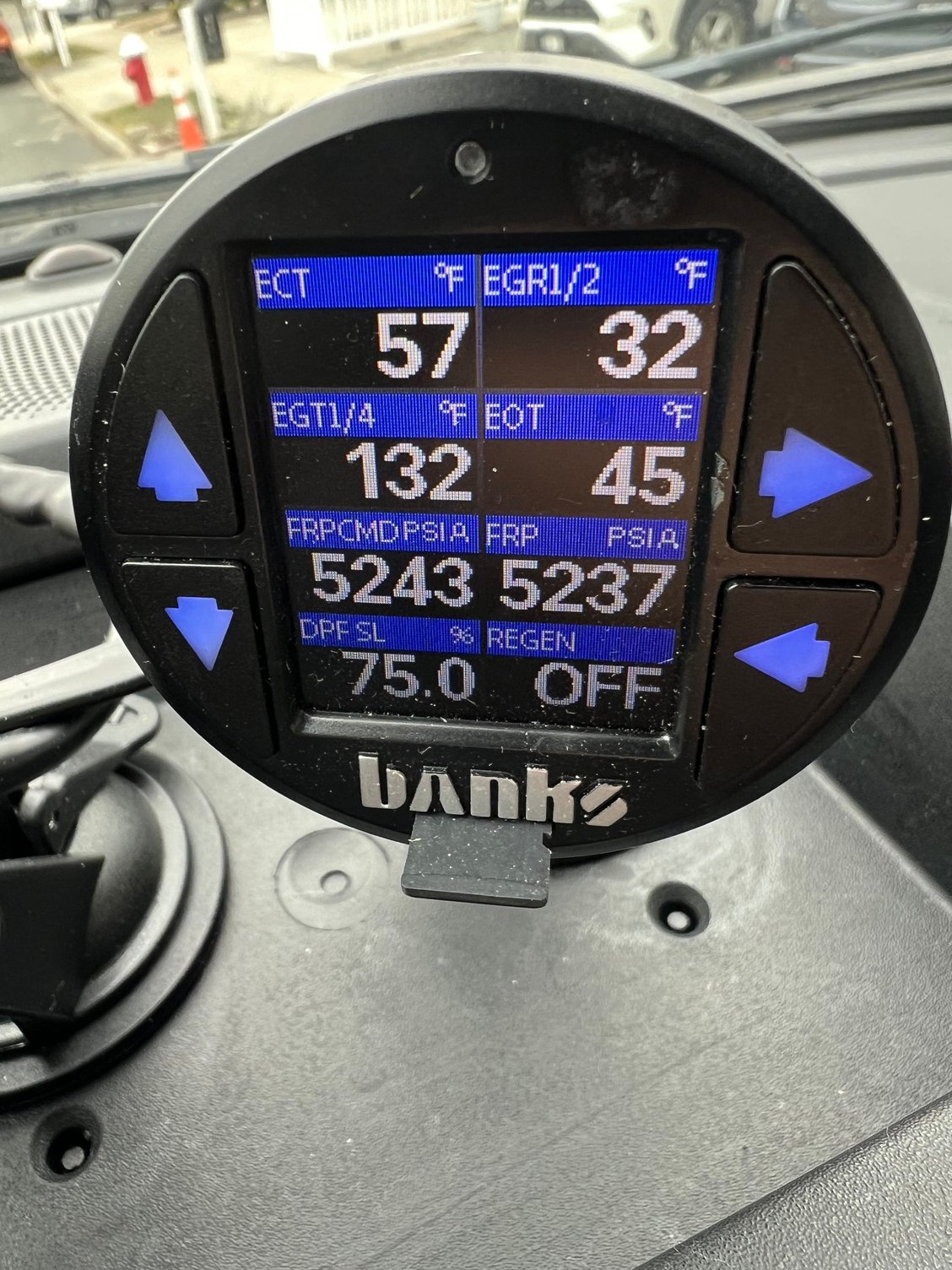

this is easy to check
get Forscan and check requested high fuel pressure vs actual. At idle it’s a tad bit over 4300. Check it a various rpms.
on a good pump the numbers are tight.
take a look at third row below. I think this was at 900 or 1000 rpms.
if your pump checks out…inspect the underside of the cold side charge air pipe.
map sensors are always a problem…they clog up…but usually it’s a mpg pisser .
cheers
edit… also..for injectors…check contribution balance for each injector. I think from memory you can see what the pcm has to add to the injector or take away to keep the spun in balance. Used to be if you were off by more than 20, would indicate a worn injector.
but double check the numbers and the pid, it’s been 5 years since I dabbled in this area of trouble shooting…concept is about right but details may need to be polished.
good luck
cheers
good luck
I will look at downloading Forscan. I have wanted to have something like it for a while now, and I really see the need for it now that the truck is having so many issues.
