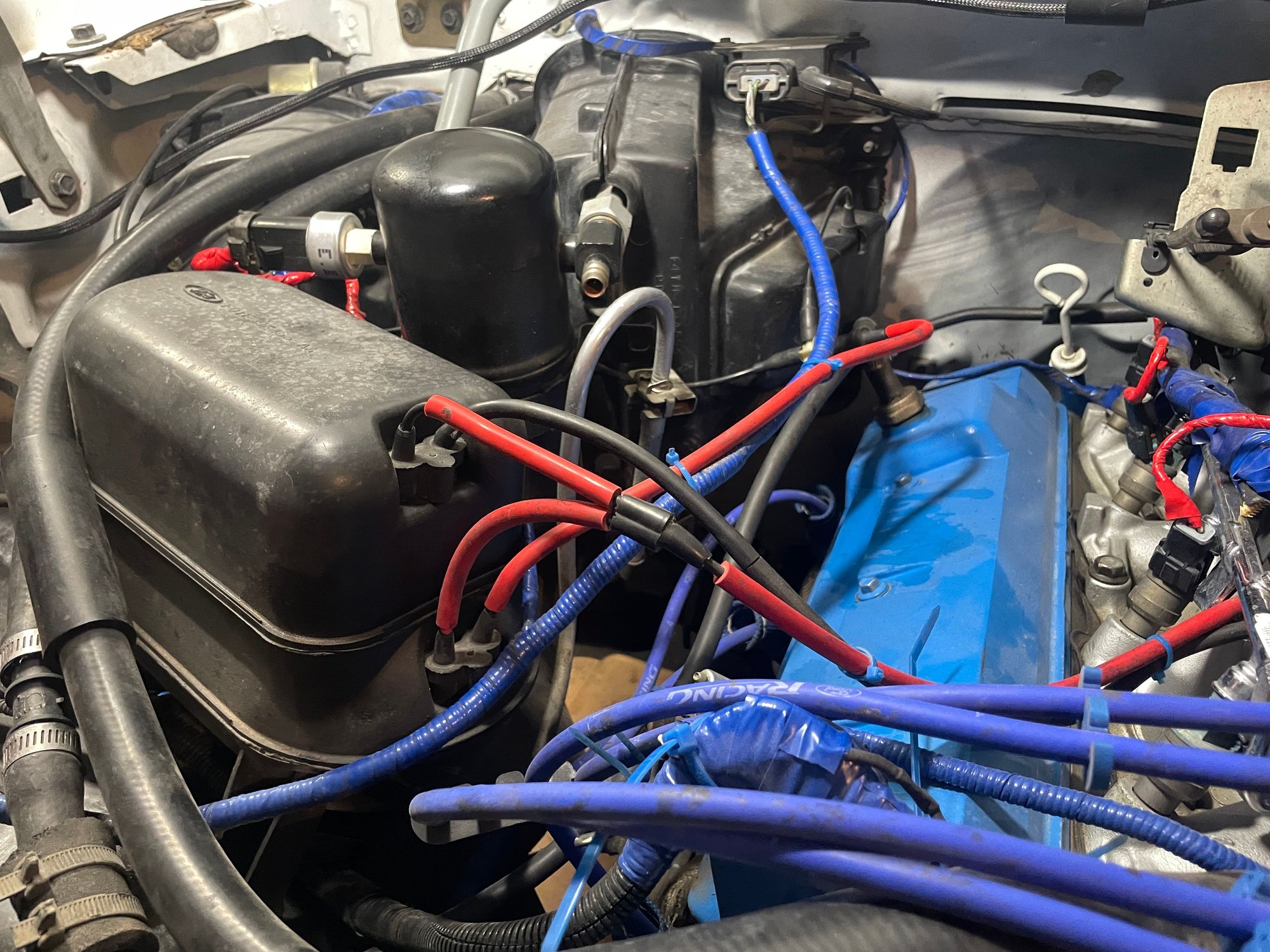

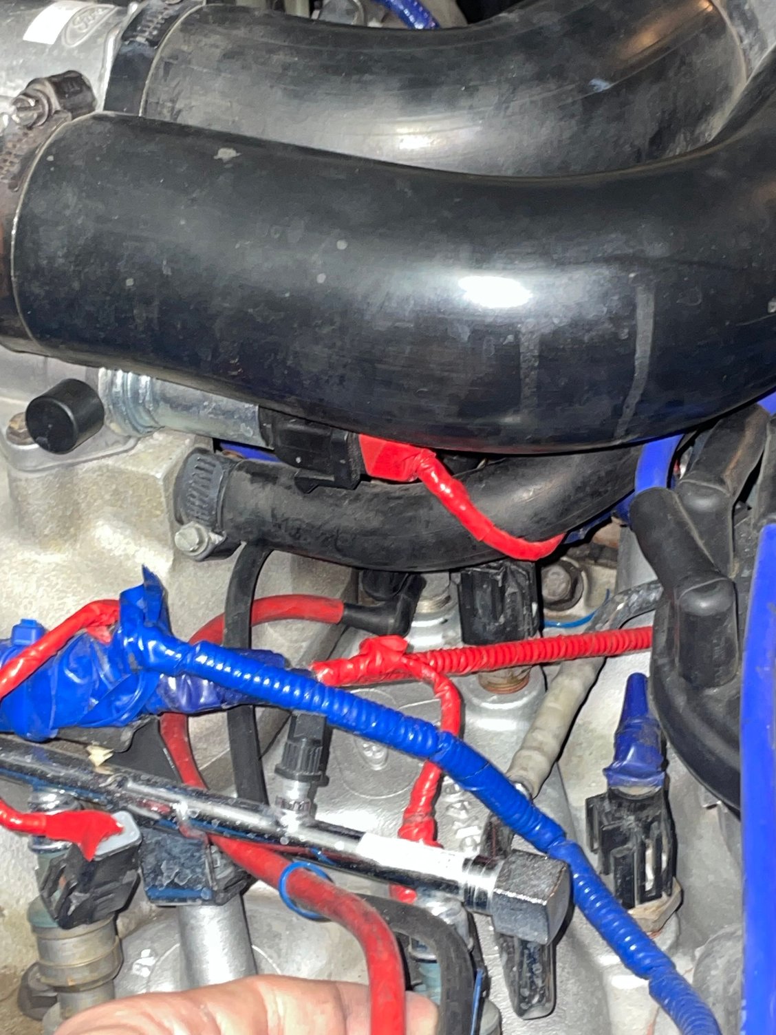

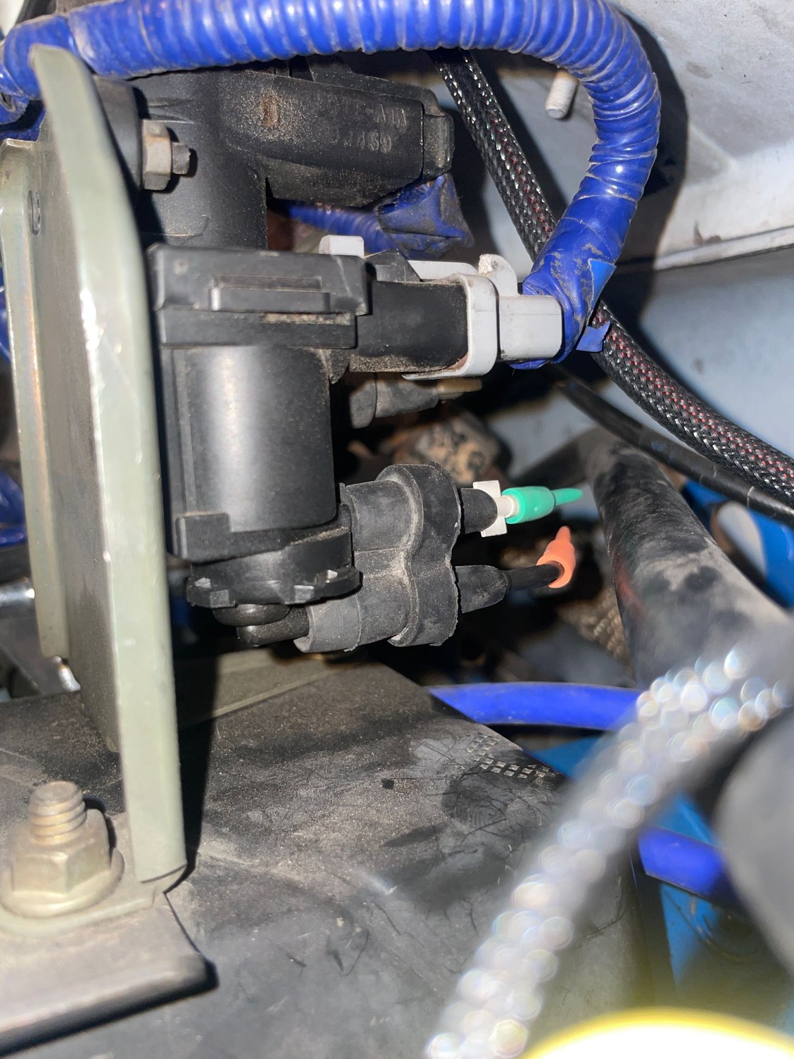

I am curious if I have the vacuum lines routed correctly though. What do you think?
On the 3rd and 4th picture, the red vacuum line runs into the vacuum tree on the intake manifold, and the black line runs into the bottom fitting on the EVR, and the top line on the EVR runs into the EGR.
I do not have the smog pump hooked up so the smaller piece of the EVR is plugged.
And except for the Fuel Pressure Regulator vacuum line, and the red vacuum line from the vacuum tank, all of the other fittings on the vacuum tree on the intake manifold are plugged

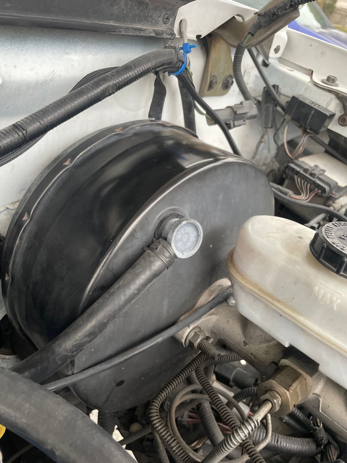

Originally Posted by '89F2urd
Remove all the vac lines from the intake manifold and cap them. If idle falls to normal, plug one in at a time until you find the leak circuit. With idle that high, if it's a vac leak, it's likely the booster.
Here’s the vacuum line for the booster, if this has a leak it could cause the high idle? If so the seal on it does have a small crack. Not sure if that could cause the leak or not
You could answer your question. With the engine running, disconnect the hose at the intake manifold then put a plug or stick your finger over the nipple on the manifold to stop the vacuum leak.
