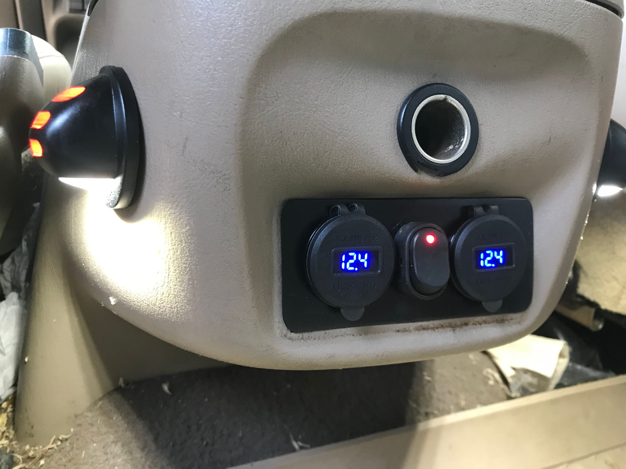

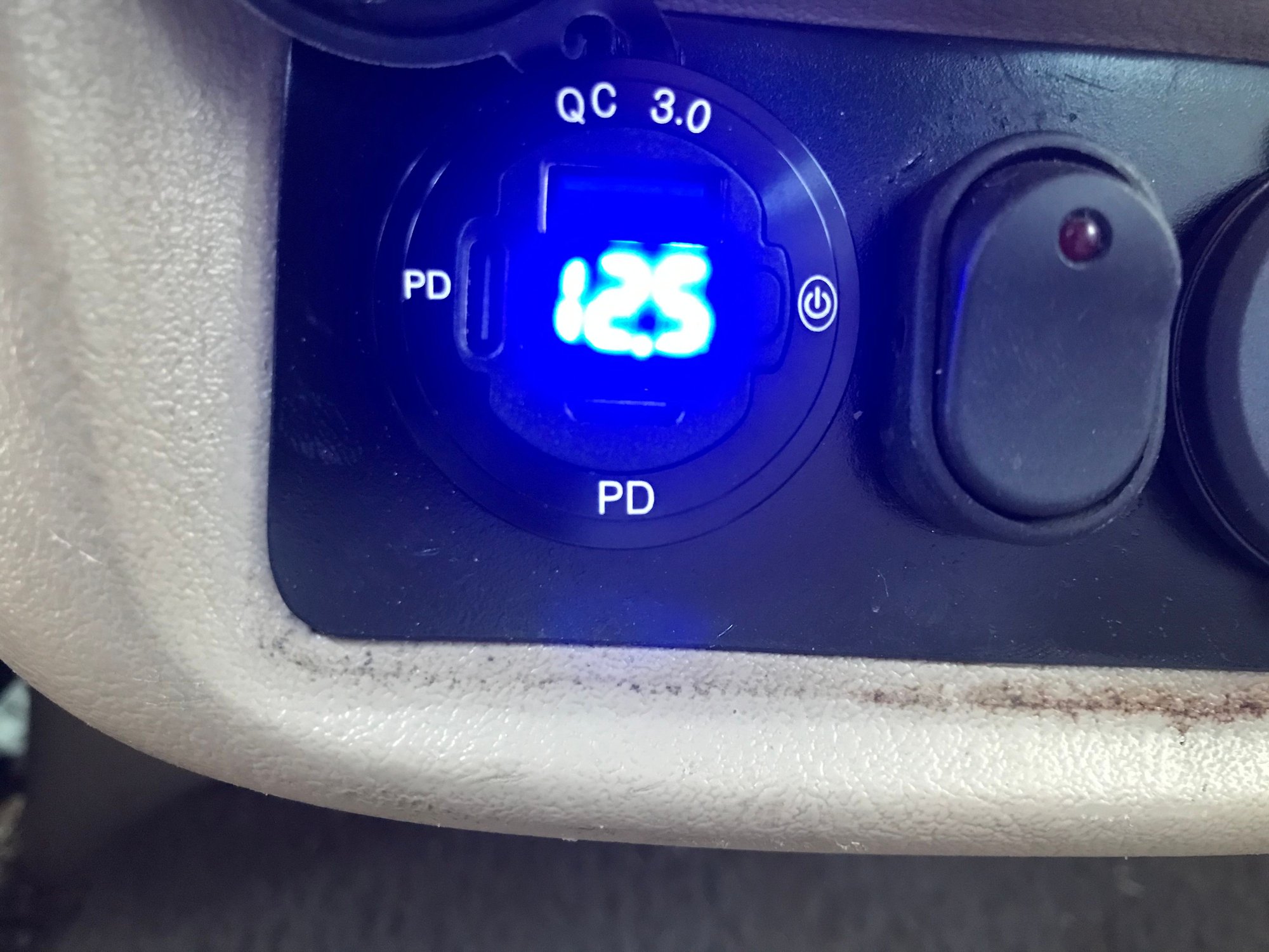

(2) of these for each row of seats in an Excursion I’m working on. I’ve just left all of the voltage LED’s turned on and no issues leaving the truck parked 7-10days.
The switch in center is for the ‘tag lights’ on the sides of the center console. These are wired to parking lights and can only be turned on when headlights are on. This all happened because I put the USB ports where the tag lights are and they prevented the cupholder from going in.....

Jason, you make this yourself or bought the unit like what's shown??
Old Jan 22, 2024 | 12:30 PM
SkySkiJason's Avatar
SkySkiJason
Joined: Jul 2008
Posts: 12,782
Likes: 2,142
From: N.GA Mountains
I made the panel that replaced the OE radio controls.
