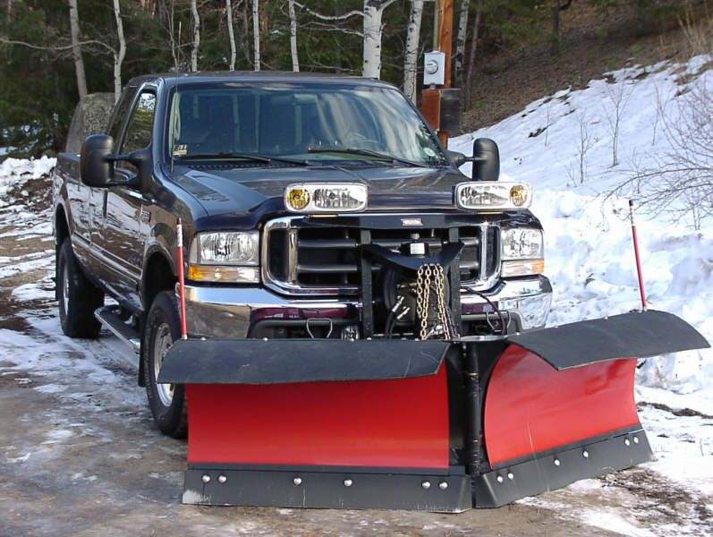

2002 F350 7.3 Superduty XLT owned since new, 265,500miles, worked fairly hard pulling 13,000 lb horse trailer or snow plowing with Western MVP Plus.
Truck basically as delivered. No engine or drive train upgrades. Recently been losing 1.25 gal engine oil a month. Puddles of oil below front of engine on driveway. Best guess is front main seal as no evidence of oil in coolant or coolant in oil.
