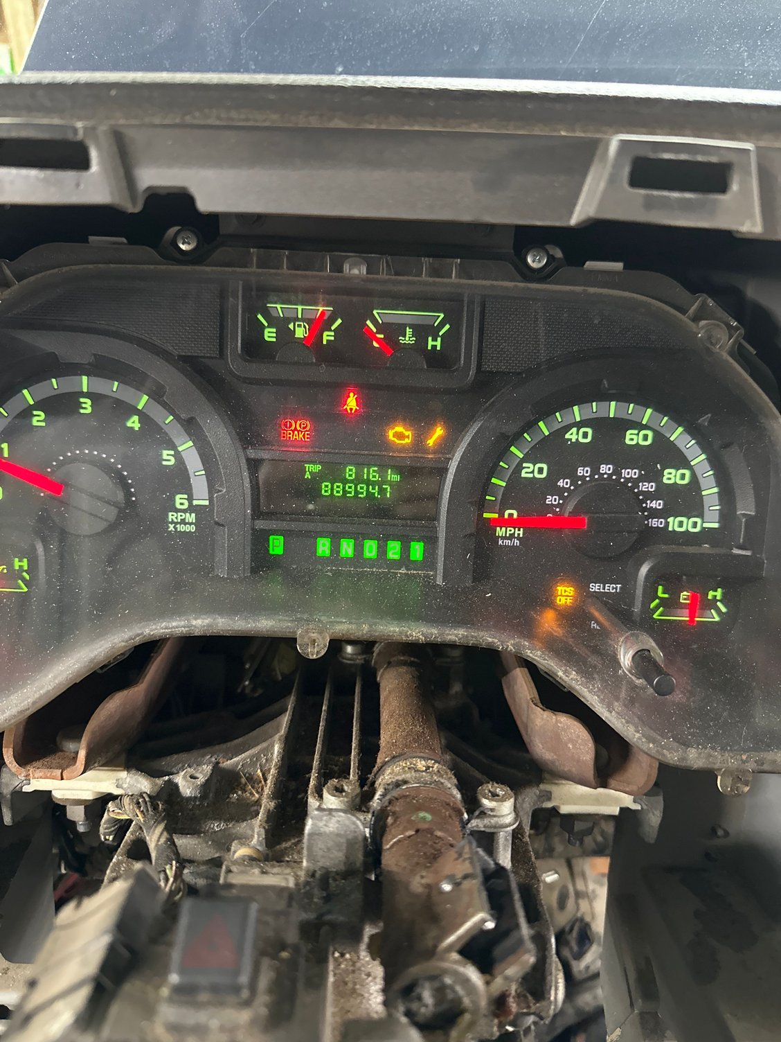

Hi I have a 2010 Ford E350 that’s having some electrical issues. The other day I went to drive it and the TC light was on and wouldn’t go off. That night I went to lock the van and the door locks stopped working. The next day I went out started it and the dash was showing TC light, parking brake light and wouldn’t let me put it in gear. The dash will also turn off and restart.
The lights wouldn’t work and that night the light would come on for a second buy themselves. I check my grounds, pulled my dash apart checked all the connections I could get ahold of. Any ideas?

These types of electrical problems are difficult for us to diagnose from a forum post or two. My guess is the cluster (IPC) has communication problems and it may be faulty. You really need a scan tool to read the codes. Look into Forscan (about $50 for the dongle). Otherwise you may have to try swapping parts.

Here is the wiring diagram for the instrument cluster. Note it connects to the HS and MS CAN networks. These networks provide the signals to illuminate some of the warning lamps on your IC. Traction control has a separate signal wired directly to the IC.
Also note the connection to the PATS transceiver.
