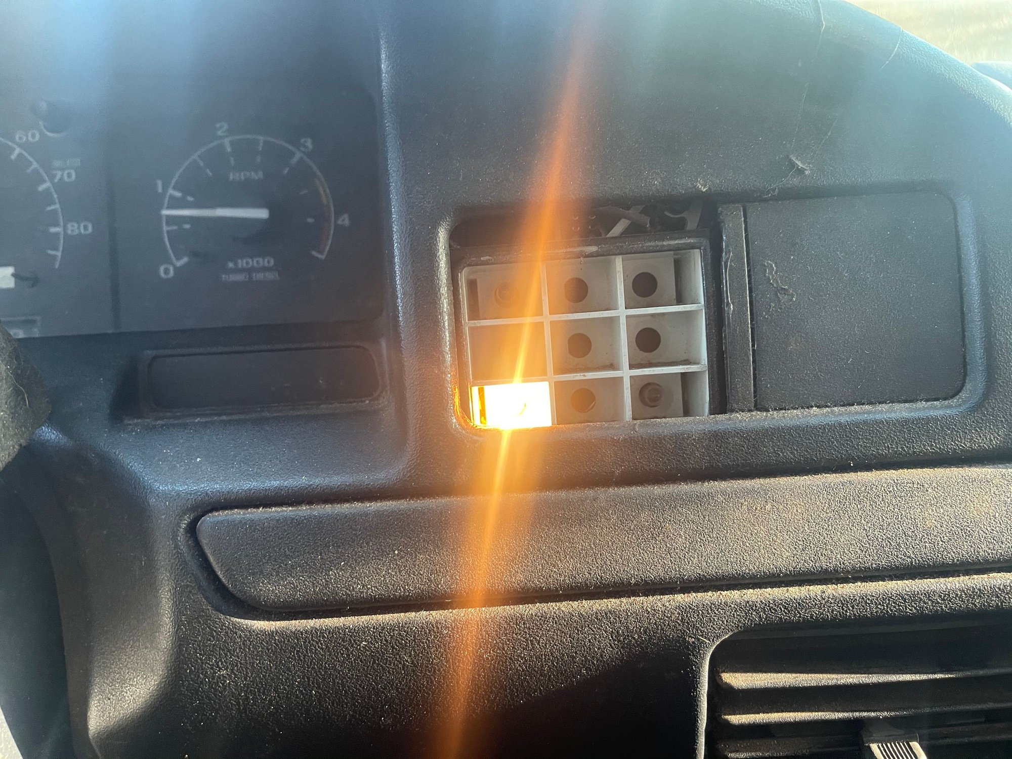

Dash light meaning
97 350 Cclwb dash has been broken since I bought it and am just curious what this light means in photo

Does it come on when you turn the key and off after a few seconds?
If so that’s your “Wait To Start” light… essentially means nothing, your GPs will be on long after the light turns off.

No the wait to start is the top left light, this one is always on

I’ll cash app you a dollar if you’d be willing to pop off the bezel and shine a flash light though the back, already looked at a couple junk yards for this piece and nobody has one

I'm thinking that might be the "fuel filter" light. I'll check later today.
Edit: I just checked and it's "water in fuel." I don't know if this is the correct procedure but I've been able to drain the fuel bowl and that's fixed the light for me.
