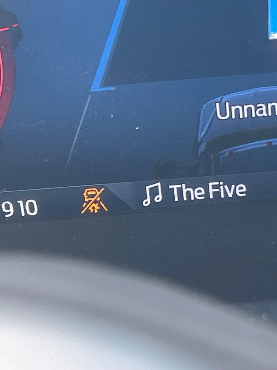

Anyone know what this warning light indicates? I have looked in the online manual and in dash manual with no luck. It appeared while driving and would turn off when I stopped ant a traffic light, but would return when i accelerated back to highway speeds. However, it went away completely when i stopped for a few mins and finally restarted the engine. I am Assuming it is an automatic maintenance indication for the diesel emissions, but I cannot find this in any Ford literature or owners manual.Engine had about 100 miles and now has 1000 and the light has not returned since.

Maybe notifying you that the reverse brake assist is off?

Something new for the 23's, nothing like that on 22 and older.

I have the same light on my dash. It came on after I went into vehicle settings and turned off all the nannies I could. Go into your settings and see if you have reverse brake assist turned off.

I saw this too; came on while I was on some real dirty forest service roads and then noticed it was off later when back on the highway...As I was on my return trip i noticed it again.

OP have you asked the dealership? Looking at the 2023 owners manual that symbol isn't shown.

Collision avoidance front camera? Lane keeping? Just tossing some guesses out there.

I checked the online manuals for the 22 & 23 SuperDuty, 150, and 150 Lighting, I didn't see anything so here is my guess. Did you disable Reverse Brake Assist? Try turning it back on and see if the indicator turns off.

Pre-Collision Assist not available. Google that for images and you'll see that symbol.

Thank you, that was exactly what I was looking for. This page is a great resource. Now to talk to the dealer to see what conditions would automatically make it happen.
