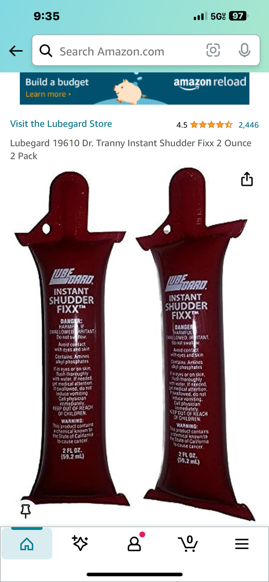

3 trucks and the all have shudder
this helps

I have used LubeGard Platinum trans additive before in my truck... at 31450 miles, I drained out the the trans (also did the transfer case and used 2 oz with the XL12 fluid) and added 16 oz of the Platinum additive to the Mercon LV. Then at 67147 miles, added 5 oz to the Mercon LV... I believe I was almost out and wanted 2 oz for the transfer case, so 5 oz was what the transmission got... I didn't have shifting problems, I just read good things on the Lubegard so I used it. Never ordered more so the last R&R of the trans and transfer case at 91647 miles never got it... didn't notice any effects good or bad, but never had any problems since. Just FYI.

Looks like I need to order the additive for the stutter. Any fix on the hesitation, some times it's worse than others.

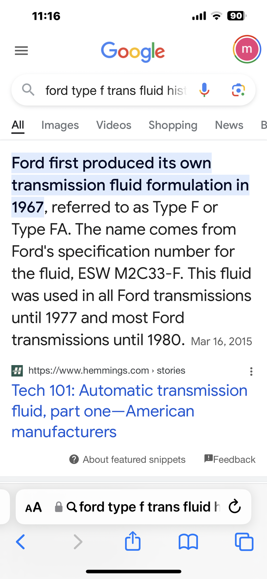

From the LubeGaurd site and from Ford MERCON® ULV. I'm still under warranty and don't want to mess that up.
For use with any specified ATF recommended by the car manufacturer, such as OEM types and
DEXRON®/MERCON® ATF’s. (Except Ford Type F ATF

yes, you DEFinitly do not want to use this in 40 to 60 year old ford transmissions that use type F atf fluid.
