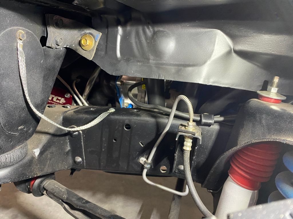

The bed and bumpers (front & back) should already be grounded by virtue of the fact that they are all connected directly to the frame via robust bolts and brackets. The key grounds are battery negative to engine block and engine block to frame. I have AWS 4 cables for these two key grounds. All other grounds can be AWS 10 or so. The braided ground straps are prettier and work just as well. That leaves the cab which is critical because it is the source or a great many things large and small that need to be grounded. On my '76 regular cab, I have a braided ground from the cab to the frame that is not stock but I like it:
There is a smaller factory braided wire in this vicinity that goes from the cab firewall to the engine block and another small braided ground that goes from the cab firewall to the hood.
One would think that a lot of these grounds are redundant and unnecessary but apparently Ford engineers were concerned about the insulation character of paints. Take the starter for instance. If you have painted your engine block including the round hole where the starter mounts you might be inadvertantly depriving your starter of a proper ground. Indeed, every ground should be bare metal to bare metal, not bare metal to paint. A small wire brush on a die grinder will take care of that nicely. If appearance is important, use little round stickers, paint and then remove the sticker applying a little dab of grease to ward off rust, then attach the ground strap.
