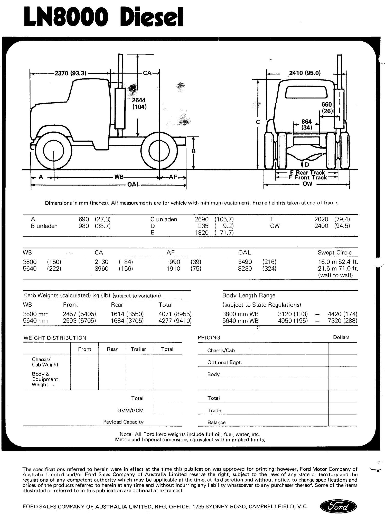

Same in Oz.....
LN7000 here had the V8 Cat's and 5 speed clarke box.and low set on splayed chassis rails small opening grille and bonnet scoop/
LN8000 had 3208 Cat or 6V71 Detroit driver side round air intake.Straight chassis rails.medium set cab height.
LN9000 had V903 Cummins, 3406 Cat or Detroit twin side air rams. Straight chassis rails or double frame rails and high set cabs to clear the larger V engines.
Only some of the earlier models had petrol engines, Australia was mainly a diesel market but we didn't get the L series until 1975.
