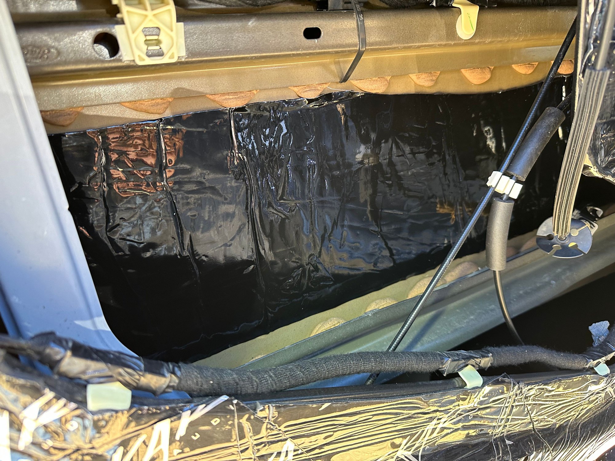

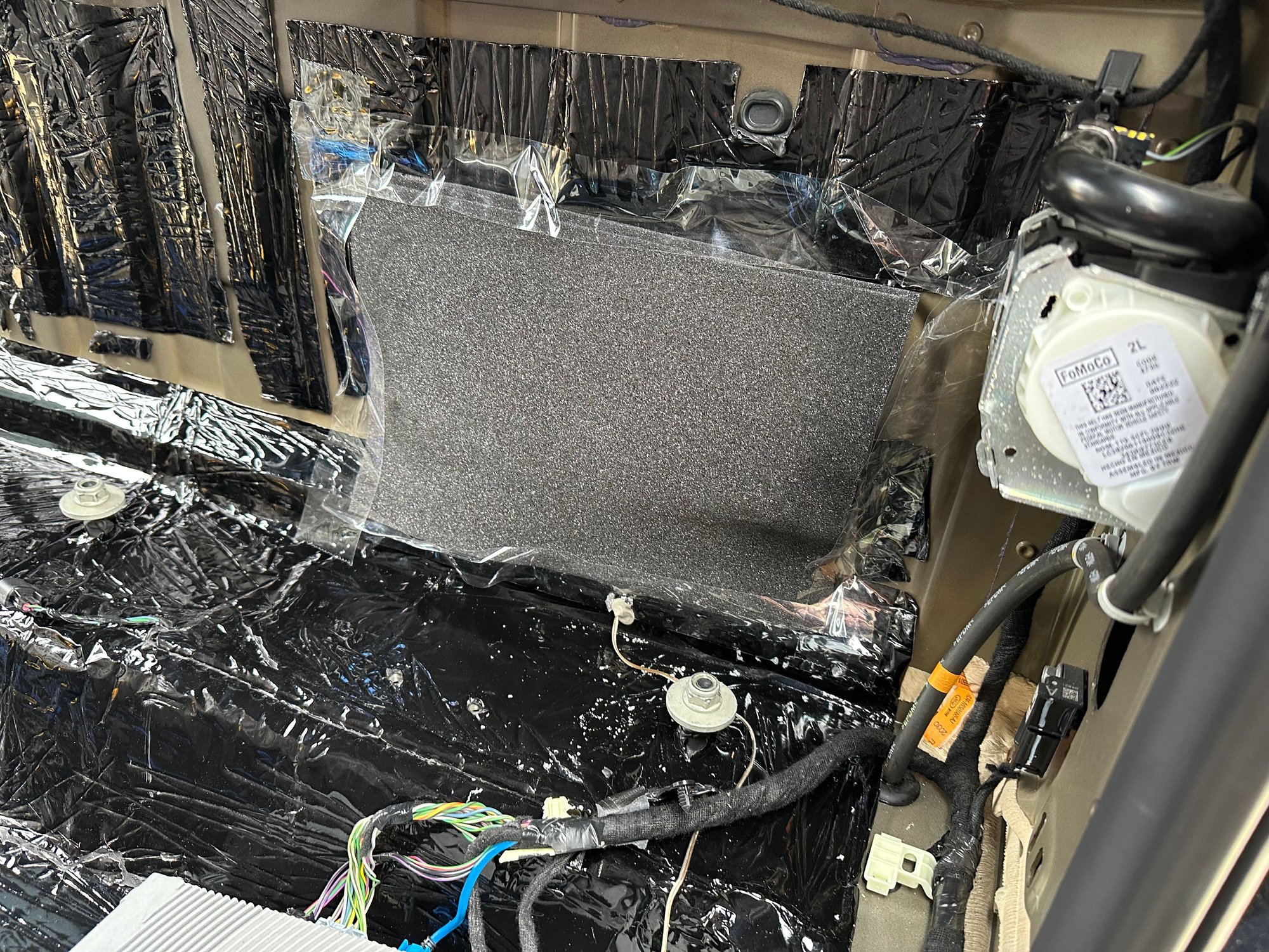

My '22 F-250 Platinum did not have the under hood insulation. Don't fret though...you can greatly reduce the amount of outside/road noise all by yourself, for under $200. When I bought my '15, 4 1/2 years ago...I decided to add sound damping material to the inside of the doors and the rear cab so the new sound system wouldn't rattle. I could immediately tell a difference in how quiet the entire cab was after the installation of the sound damping material. It took 40 square feet of material to do the inside of all 4 doors and rear cab. I'm getting ready to do the cab of my '22 as soon as I have some time off of work, and I can't wait. I could immediately tell a difference in how much more road noise there was in the inside of the cab when I left the dealership in the new truck. I used NVX sound damping material that is 2.3mm thick. Below is a link to what I bought for the new truck. It's the exact same as what I installed in my '15, it's just black instead. Paid $117 shipped for 40 sq.ft. https://www.ebay.com/itm/362209647993
Sound deadening. You would be amazed at the improvement this made alone on the road noise.

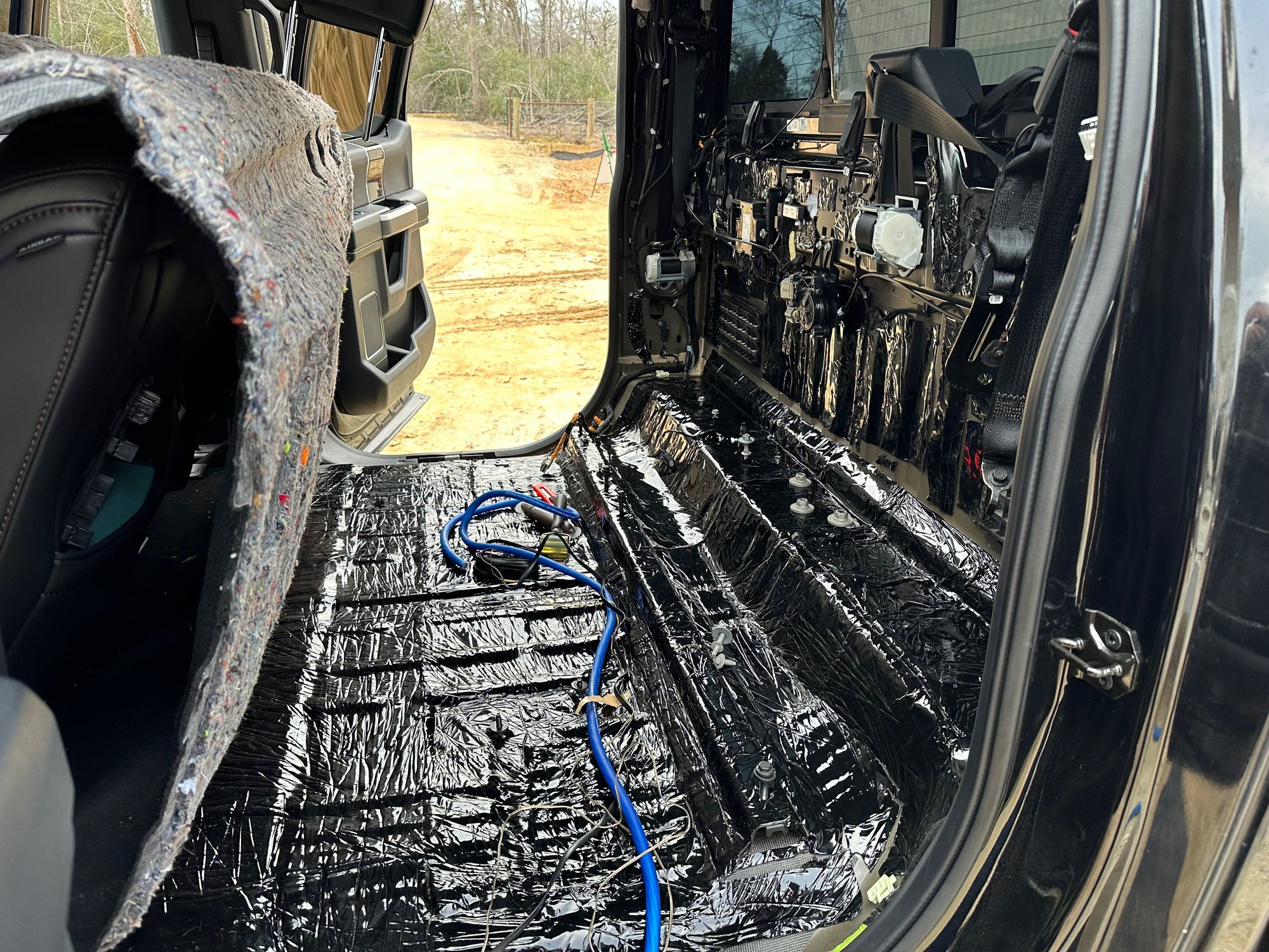

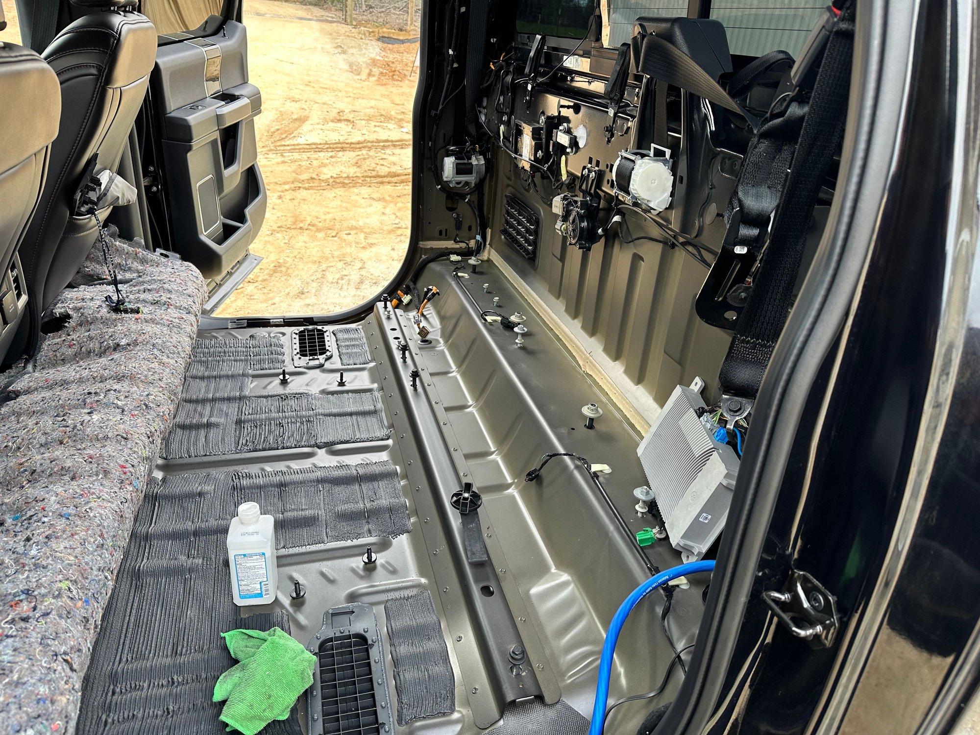

The pics above were from my ‘15. This is what I did to my ‘22 Platinum during the sound system installation. You will find that there is little to no factory insulation or sound dampening material on the Platinum’s. The road noise is greatly reduced by adding sound dampening material.
The insulation on the floor is factory in this pic.
one of the best things you can do to reduce the cab noise, is get some 3/4” foam sheets to layer in front of the rear cab vents.

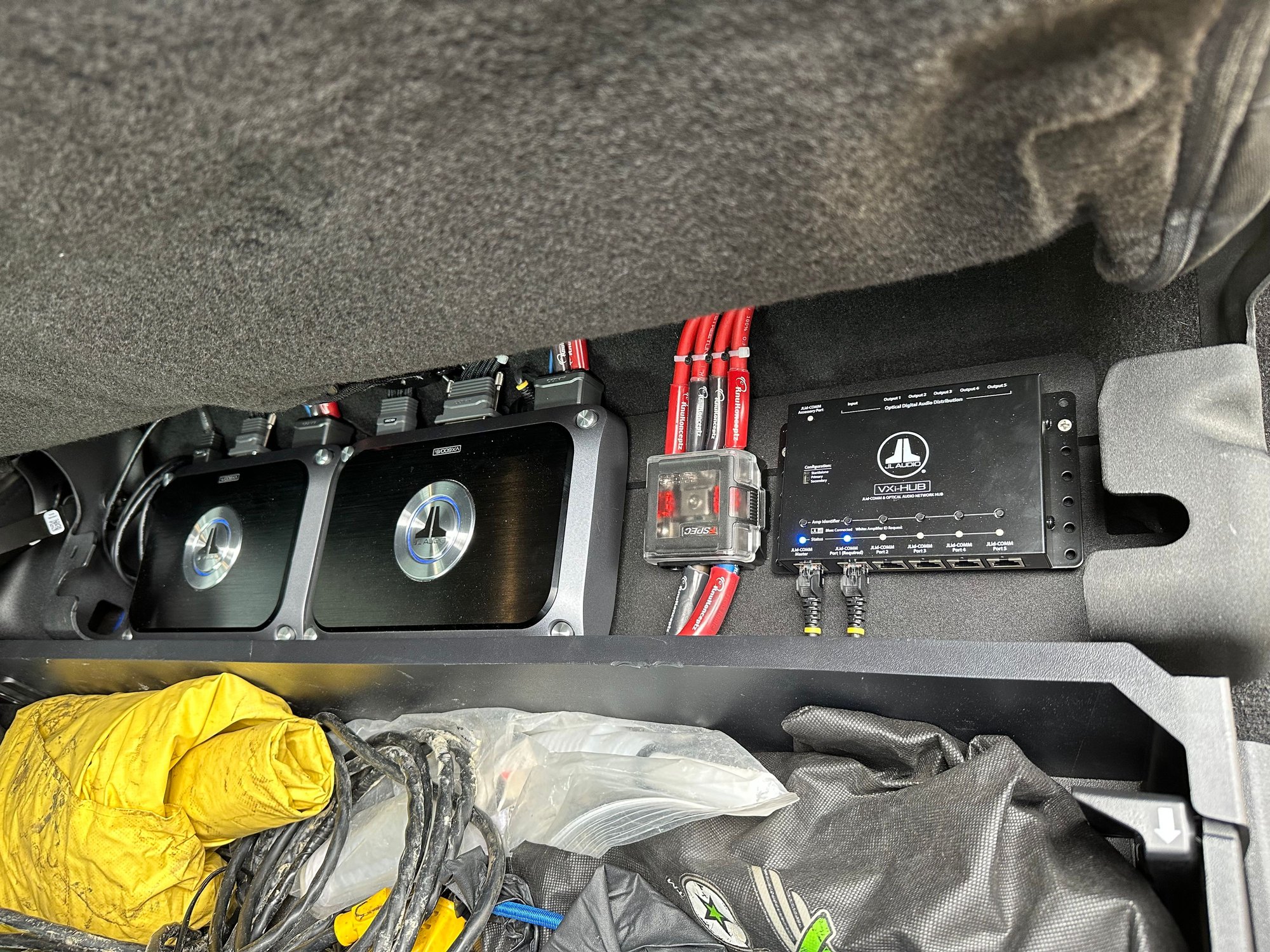

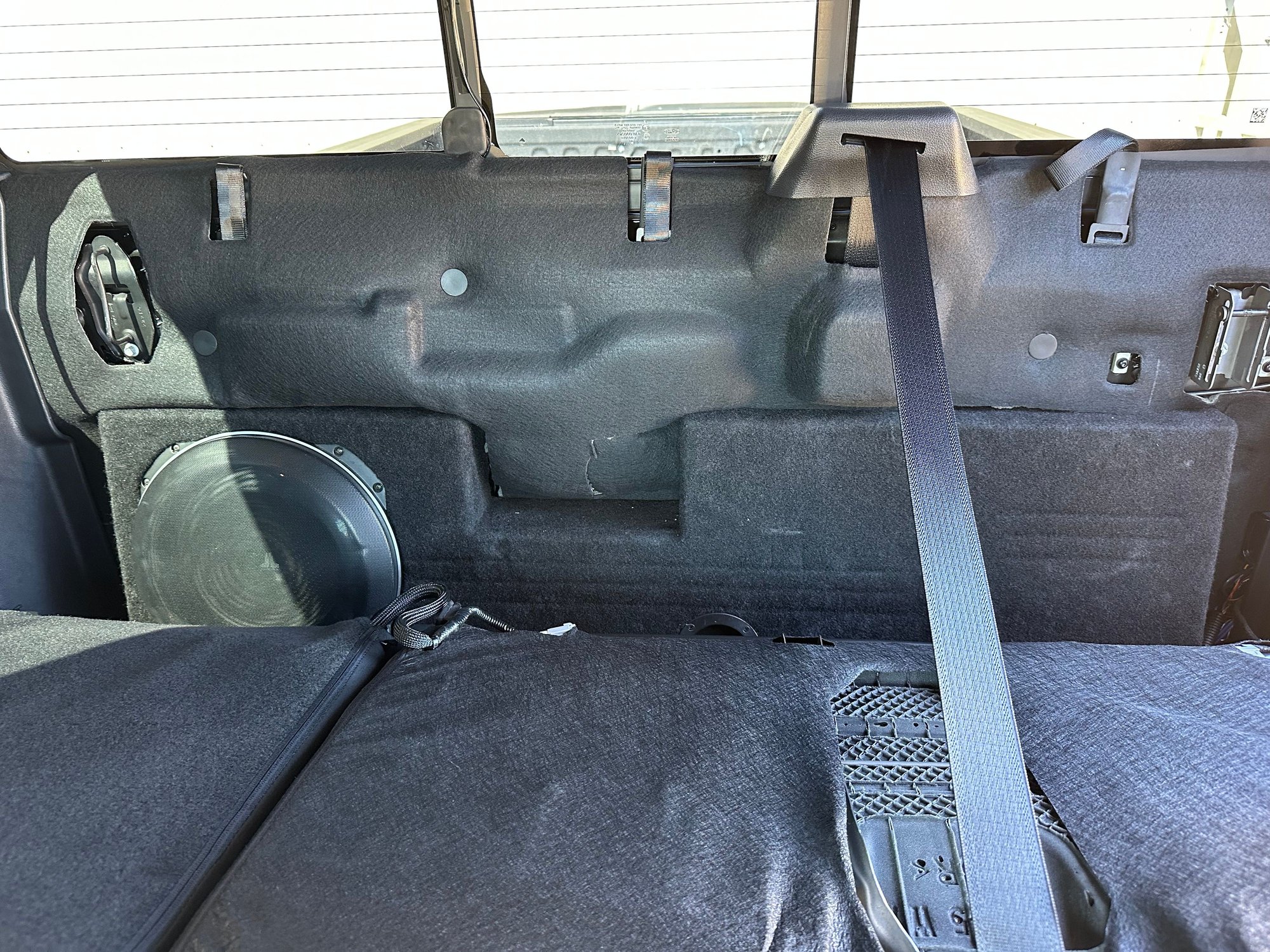

Thanks! It’s hard to judge how long it took to just do the sound damping material. I was also installing a full sound system installation at the same time. From start to finish, it took me 2 weeks for everything. I was working on it a few hours a day while I was on location at work though, so there were distractions here and there. I completely replaced the factory B&O system. It’s truly embarrassing what they consider is “premium audio” once you pull everything apart and see how cheap the speakers are. Here’s the finished sub and amp rack. Installed active Focal components up front and in the rear doors along with the 13.5” JL Audio sub. Doesn’t rattle your teeth out, which isn’t what I was looking for. It will make your ears bleed though!

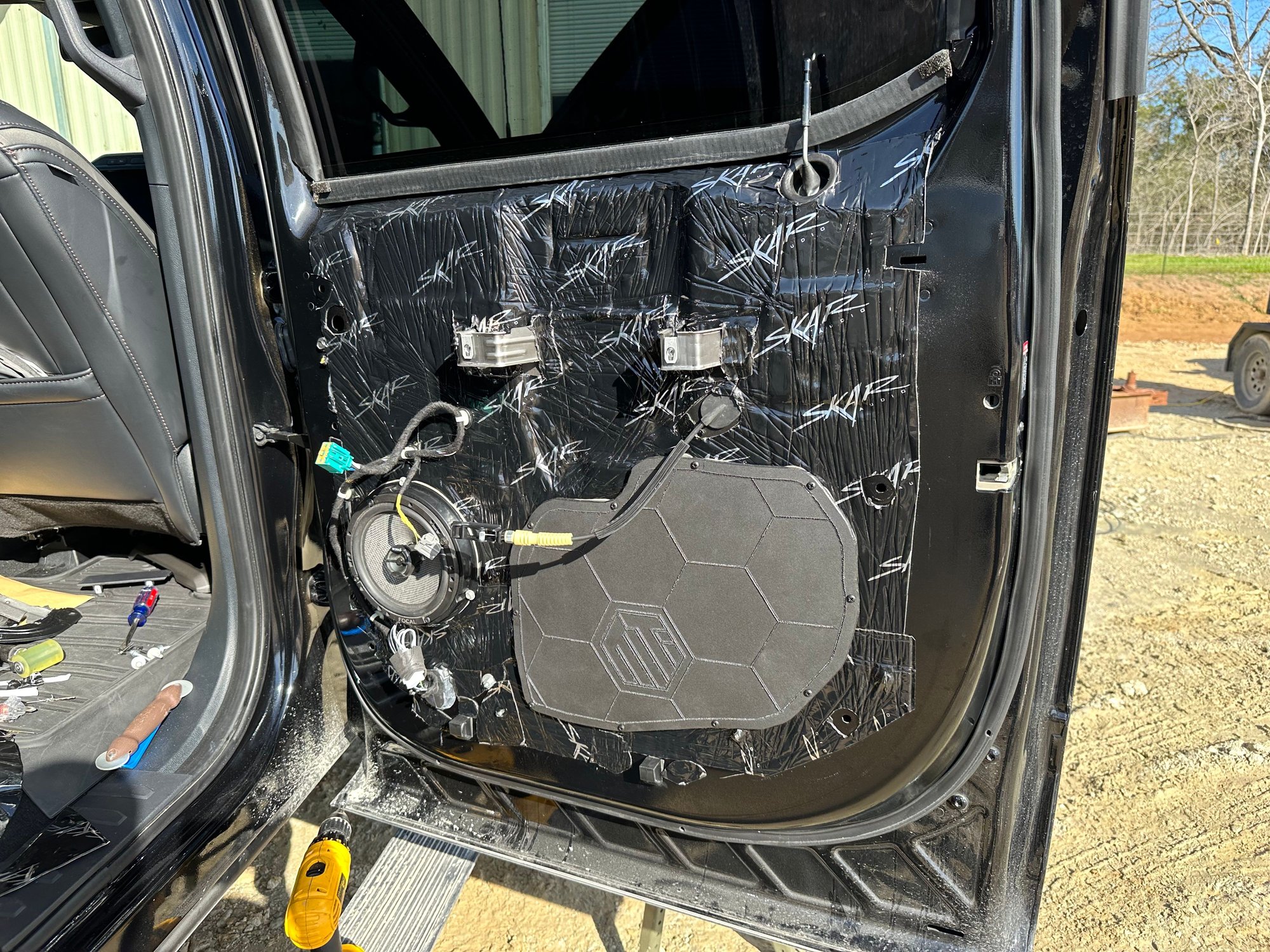

looking to apply to tame the bark of my exhaust, so dumb question time (total newb to this stuff). when you're applying to the doors you're not actually applying to the interior space inside the doors correct? from the pics it looks like its applied similar to the water shield.

Yes, it’s applied to the inner door shield. This stuff can get wet. It won’t hurt it. My application wasn’t just for road noise. I didn’t want any vibrations coming from the doors after the Focal speaker installation. I also have sound tiles installed on the inside of the door. Those are strictly for the speakers though. They weren’t applied until after these pics were taken though.
