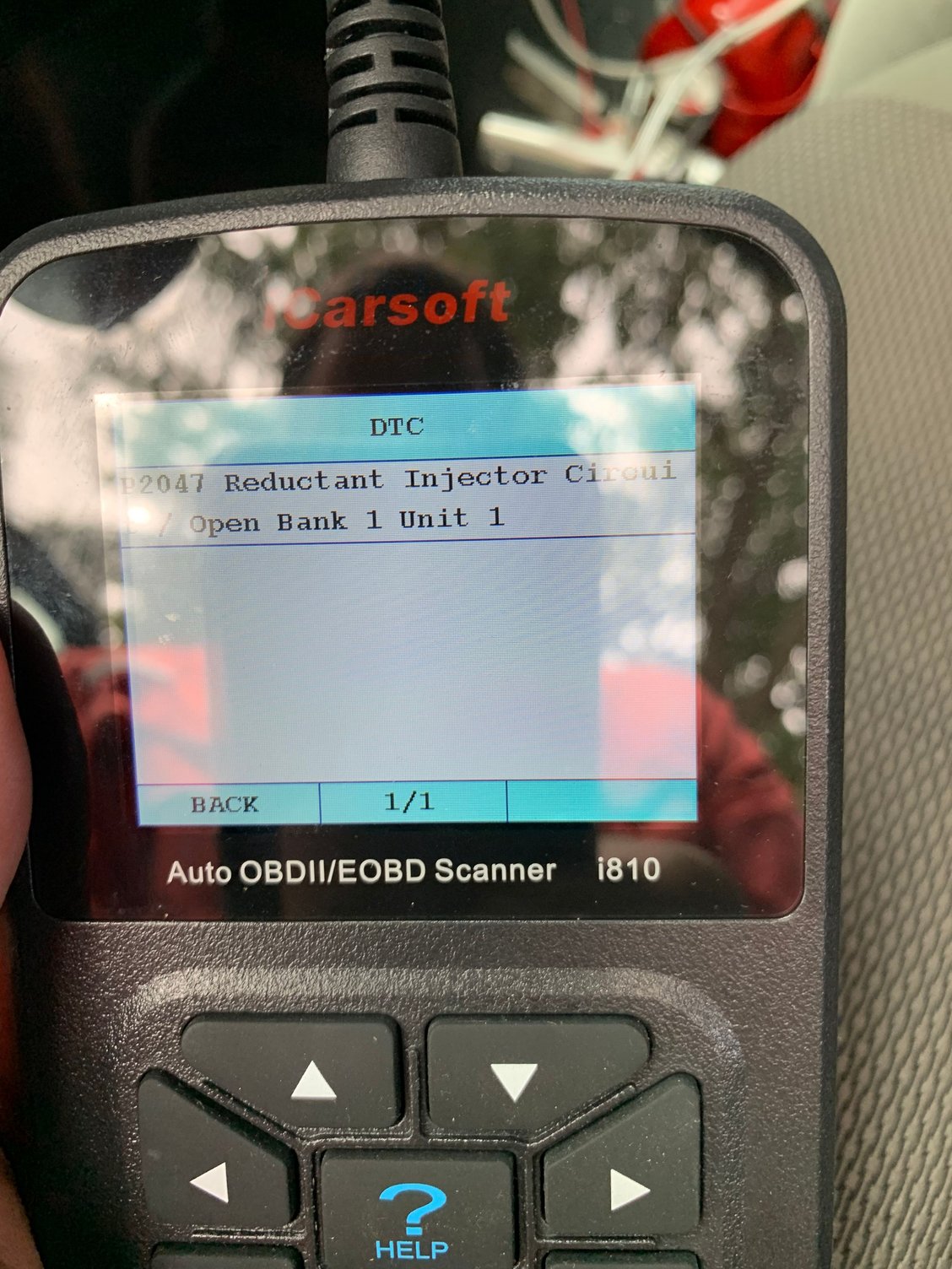

Hi all I’ve not been using my truck much and went to the grocery store and got the below error
p2047 I went to autozone and put 2 containers of def cleaner and a jug of shell def and moved to the next store where the error returned. I’ve got home and cleared it again.

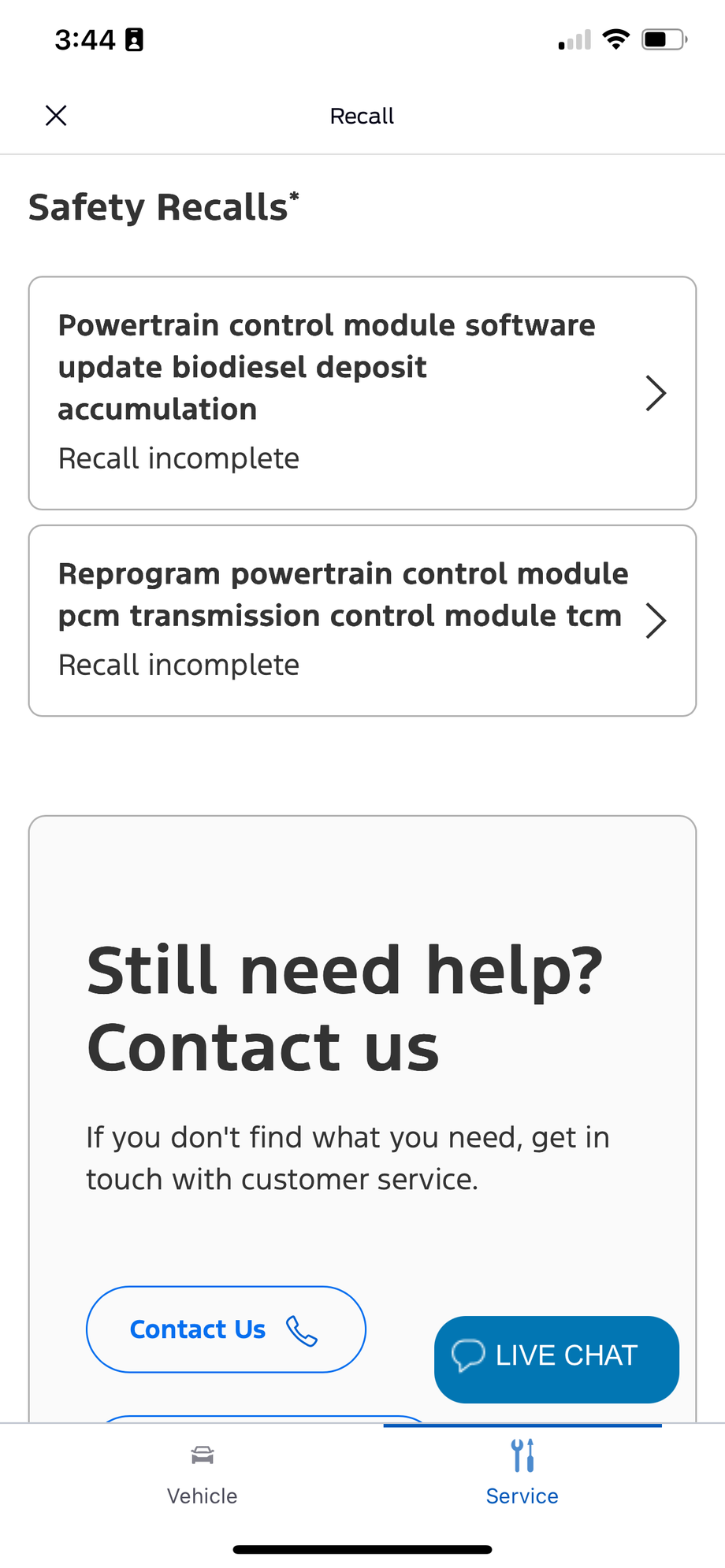

I do have 2 active recalls are they any relation to this error or does the truck need a good run on the highway or regen cycle

That code is for an electrical issue, not due to any dirty or clogged DEF injector.
Could be a broken wire, or one where it is rubbed through and exposed to ground, or a connection issue.
So, DEF cleaner and new DEF won't help.

Would you suggest checking the harness to the sensor, I do have the 2 open recalls but if I can check the cabling myself for any issues do you think that might help
