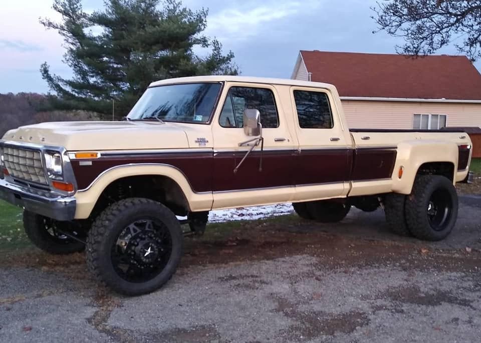

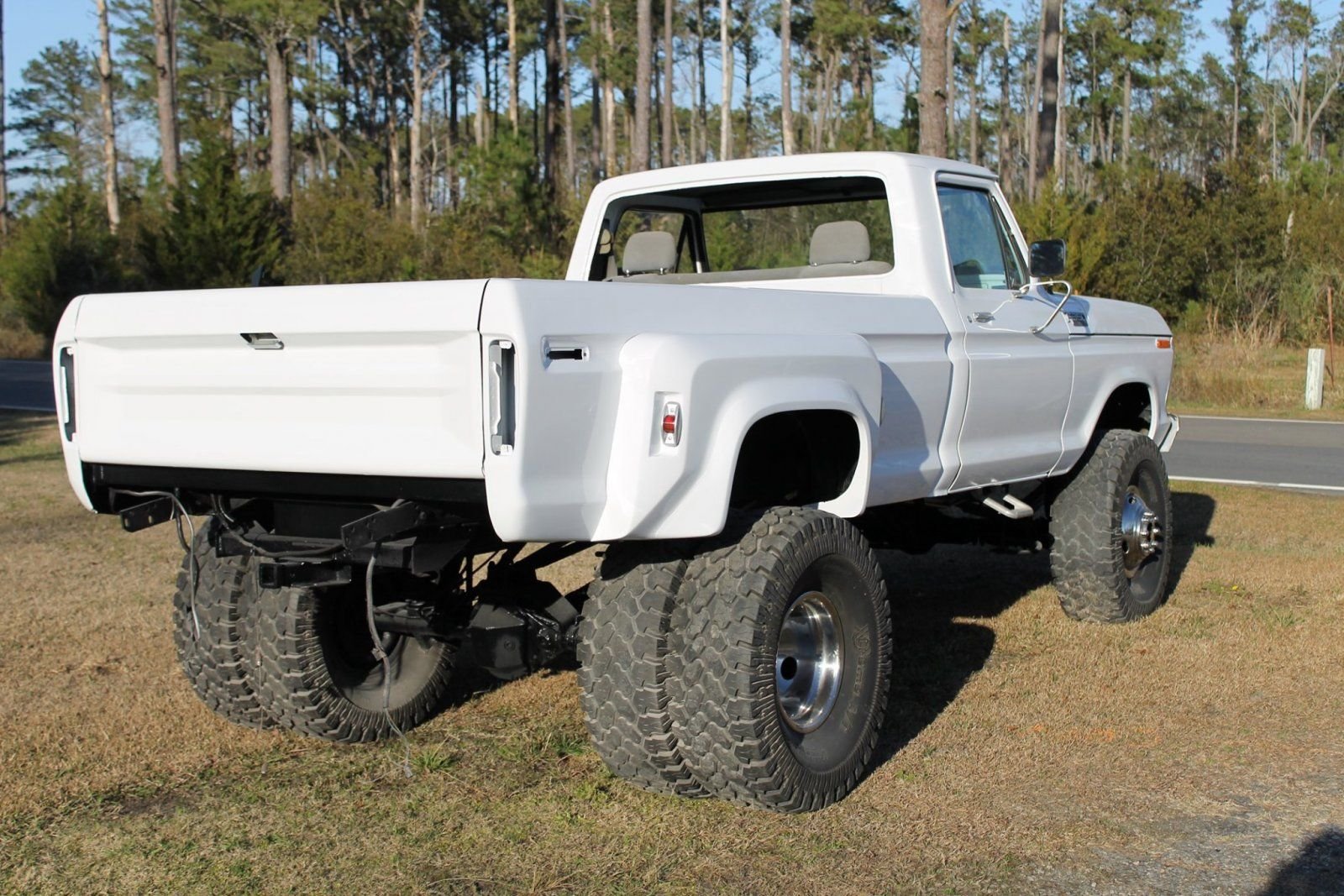

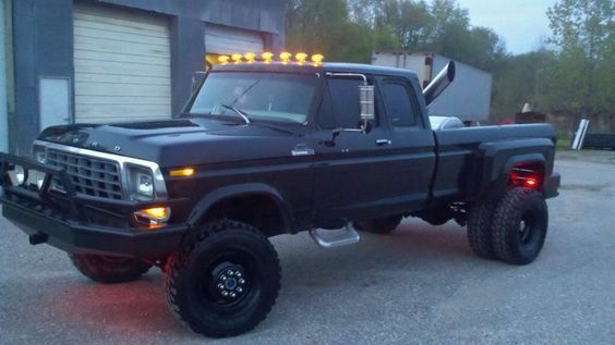

So it has the dually rear end and you want to put a regular truck bed on and and then find the (pretty much impossible to find), dually fenders to go on the bed? If you do not want to drill more/different holes in the bed, just weld some tabs/angle iron/brackets to reuse the original holes in the new bed.
Free ideas here https://www.ford-trucks.com/forums/1...y-fenders.html
