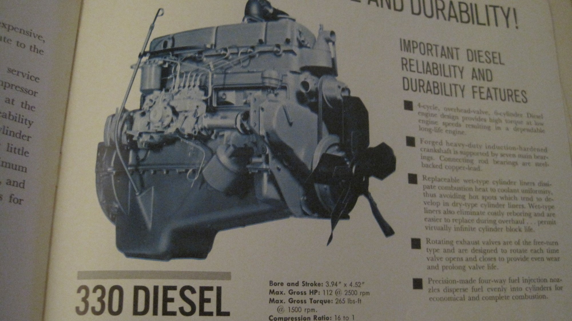

In '63 Ford used the 112 hp Dagenham 330 diesel for the C and N series. Designed for city pickup and delivery work, not raw horsepower on the highways with full loads. They were DSO, special order on F 600's in the Canadian market only. Diesels run at slower speeds, so a numerically high axle ratio and or an overdrive transmission was a must. In '68 Ford started offering the more powerful CAT V8 diesels in American built F 600's.

This is awesome, I can use the information for approval with the information about the engine. That is really good.
Thank you.
