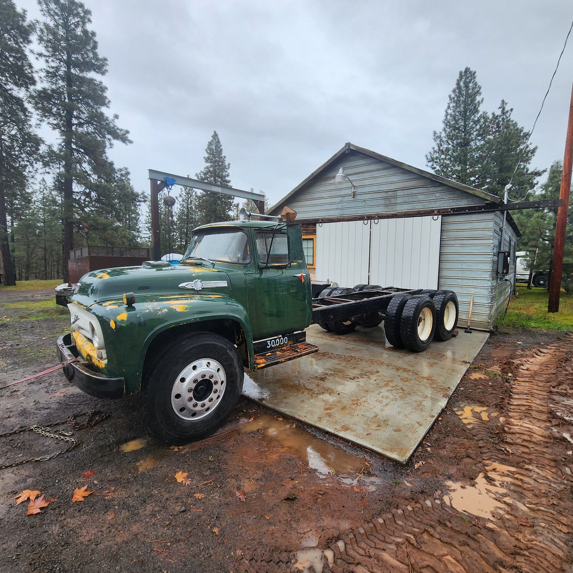

I just brought this old girl home. Unfortunately the intake manifold and carburetor are missing and the engine is stuck. If anyone has any leads on a 332 engine, I would be very interested.

I was wanting to have this Vin Decoded. It is a pretty complete truck. Air brakes, tandem axles, aux transmission behind main transmission.

T80 = T800 Tandem Axle "Regular" version vs. T81 & T84 for the light and heavy versions
S = 332 4V gas V8 Lincoln derived Y-block
6 = 1956 model year
H = Detroit Truck Plant
36000 = Serial number
42000 = 42,000 lbs GVWR
175 = 175 inch wheelbase
181 3600 = 181 Certified Net HP @ 3600 RPM
5HD = Heavy Duty 5 speed, MPC shows "DIR" or "OD" as being indicated but it isn't here.
860 = 8.60 axle ratio
SS = Special Paint Color
03BSC-455 = Possibly February 3rd 1956---Others have that info
DSO is an asterisk, possibly because it's a special order?
My info is pretty limited for this model year.
There are bunch of folks in this forum and the '48-'56 forum with the 302 and 332. I know little about those but the 302 and 332 have the same stroke so the deck height is the same, so I'd bet manifolds would interchange.

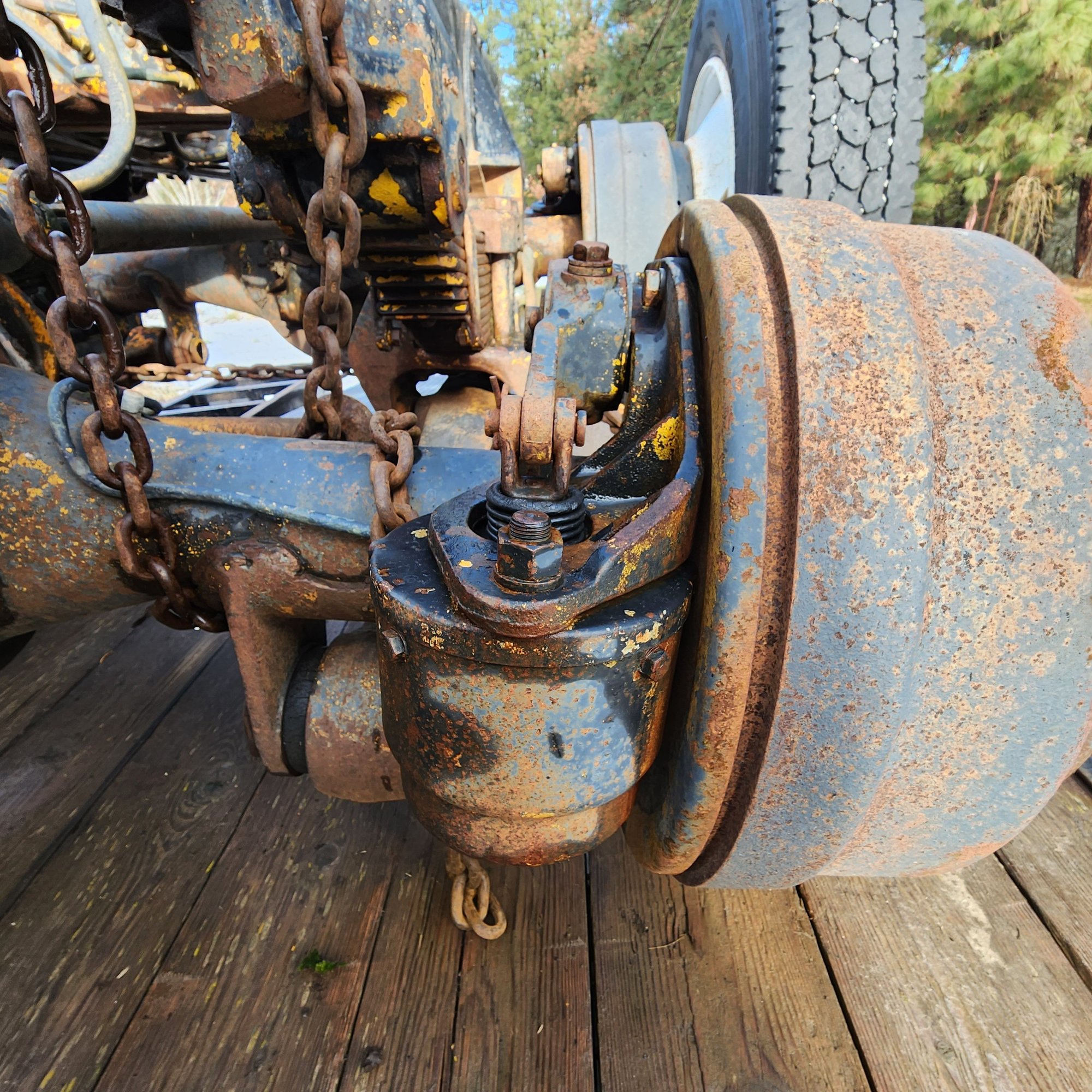

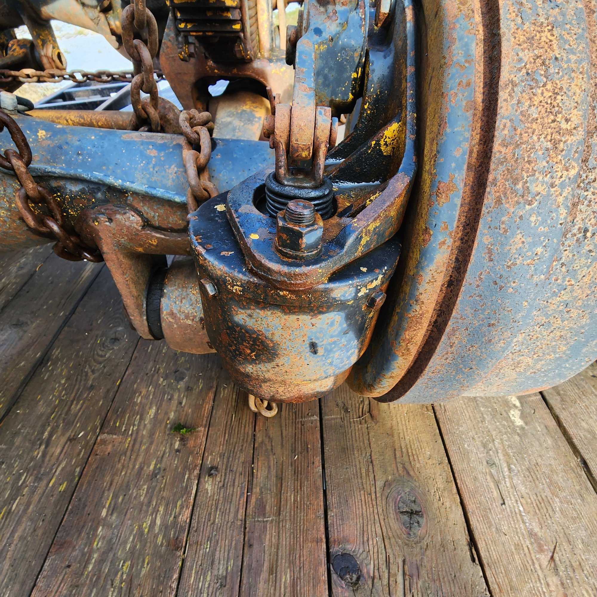

Well I have some crazy plans for the T800. The king pins are shot and the motor is incomplete and stuck. I've never seen brake cans like the ones that are on it. So... I'm going in another direction. I have located a complete Meritor axle and suspension for it, along with the transfer case. I'm looking at buying a newer F800 cab and chassis with the 5.9 liter cummins and 6 speed manual transmission. This way the truck will have more modern running gear with lots of life left in it. I'm thinking of putting the cab onto the new chassis and making use of my new magnetic drill, and putting the 6x6 running gear on it.
