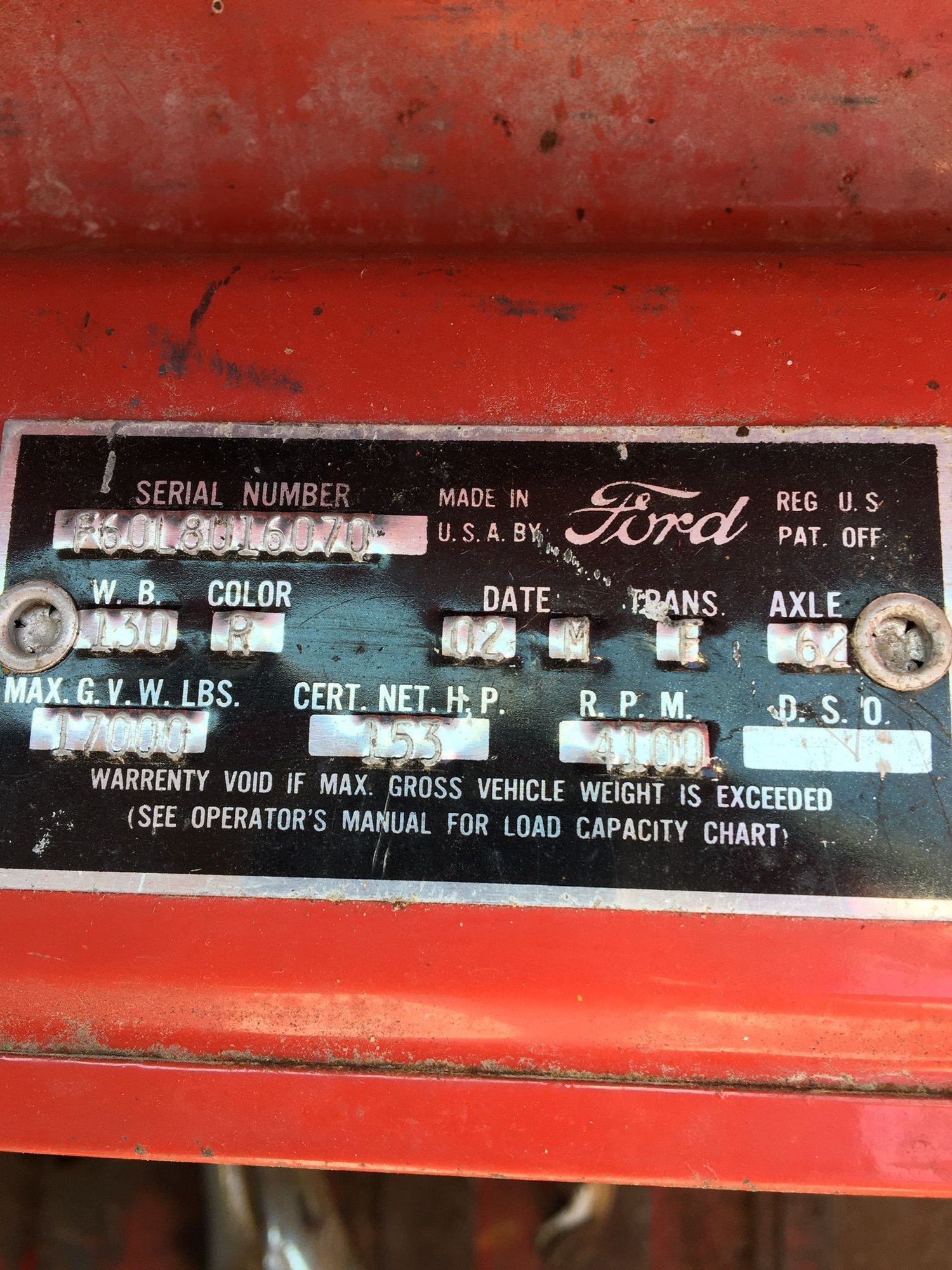

F600 warranty decoder?
I’ve recently pick up an f600 series dump truck for camp and can’t seem to decode the serial number completely can anyone help!?
F60L8U16070

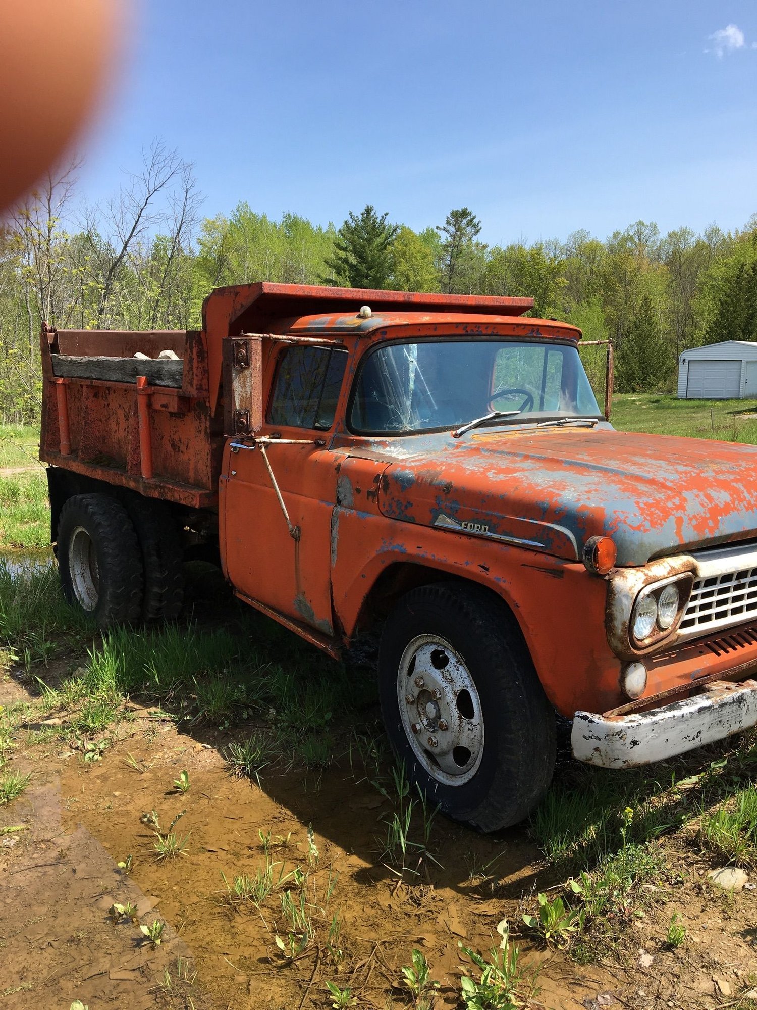

Welcome to FTE!
Stand by for a decode, but I can tell you three things:
Grill etc is '58
Engine code is 272 Y block, 2v carb.
You have widow maker wheels.
You probably have a 4 speed BW T98 transmission and could have a two speed rear axle.
If you are going to work it, the widow makers should go.

1958 F600
F60 = F600.
L = 272 2V Medium Duty.
8 = 1958.
U = Louisville KY Assembly Plant.
16070 = 1958 Numerical Sequence of Assembly, the trucks specific serial number.
130" Wheelbase.
R = Torch Red.
02M = Assembled December (M) 2, 1957.
F = Borg-Warner T-98 4 Speed Manual Transmission.
62 = Eaton model 13800 Two Speed Rear Axle / 6.33/8.81 / 15,000 lbs. Rear Axle Capacity.
17,000 lbs. Gross Vehicle Weight Rating.
153 net HP @ 4,100 RPM
Note: I deleted the wrong Rating Plate pic, so you'll have to scroll up to post #1 to see the one I decoded.
